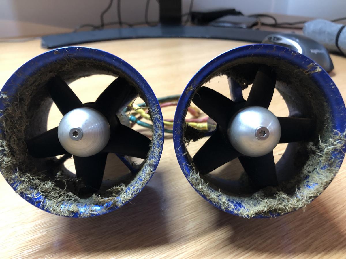

                            Originally posted by Alpha
                            Waconut Let us all know how your results fare, Anthony. For a model like the F-86, if the screen mesh idea doesn't work out for you, a more extreme mod would be to aspirate the fan using a cheater door on the upper surface of the fuselage instead of under it. Look to what we did with the Freewing 90mm F-104's air brakes, which also served a dual function as spring-loaded suck-in cheater doors. Springs would hold them flush to the outer fuselage wall when not needed, and yet when the fan required it, the suction would collapse the door inward.
                            This is what we have been doing here on our grass fields in the UK, which tends to have different grasses to North America and the ground tends to be softer. I've modded models for 3 different members of our club so far by adding an angled slot cut in the top of the model just in-front of the fan. All have been complete successes.
                            If Freewing are listening to this thread, please stop putting intakes on the bottom of models, not only does it suck in loads of debris but the airflow actually physically sucks the model to the ground.

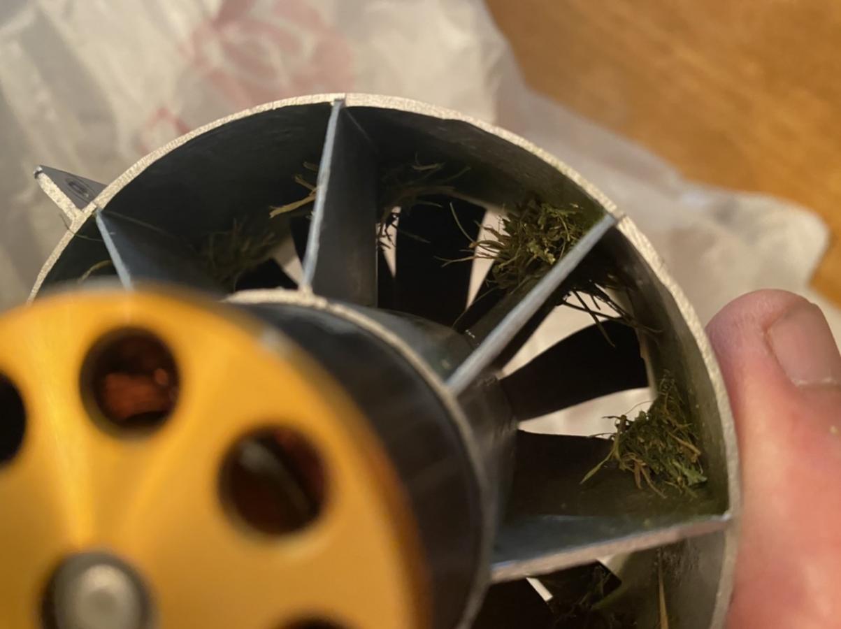

                                    I pulled the EDF unit out of my F-86 this morning. A lot of grass in there.

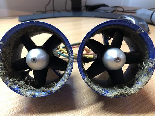

                                      #19
                                      There are out of my SU-35 (yes, I still have one) 😁

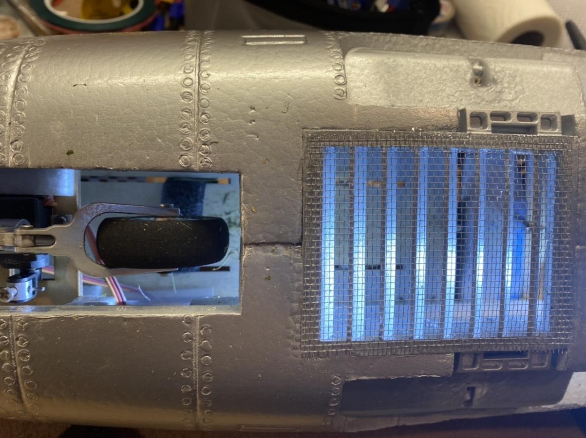

                                        I epoxied aluminum screen over the cheater hole. As you can see there is a large opening at the front landing gear and I can see where the wheel slung grass clippings up in there as well.
