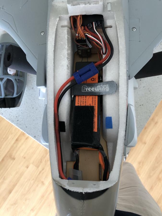

                                also, in my manual the CG is too far forward and very nose heavy and in my opinion and should be moved aft quite a bit. I suggest read all the A-6 threads to get a better idea.
                                see my attached pic as a reference...this works for my A-6...? Perhaps even a bit more aft...I tend to run my planes a bit nose heavy (note i CG mine w/out tanks installed).
                                also, the manuals full flap setting takes a getting used to...recommend ½ flaps until you’ve got some flights under you belt!
                                Be mindful of the full flying elevator...perhaps mid-rates or even low-rates...?
                                good luck!
