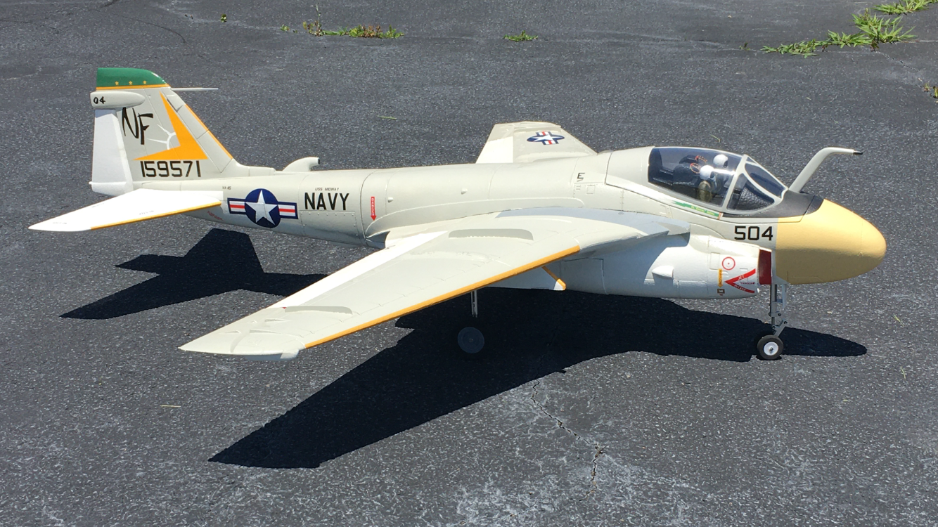

    Making it your own is a great idea. Here's mine done as they were when I worked on them in 1977-79. E models without FLIR.
    Click image for larger version  Name:	6B7BCECC-2189-46F8-A3DA-D634C55BA6C2.png Views:	0 Size:	1.94 MB ID:	316648

      Your A6 looks awesome Evan! It must be so cool to fly the plane and livery you worked on!

        Thanks. A friend of mine who is also ex .mil did it as one of his earliest paint projects. He bought the kit (no power plant or servos) and did it for me off pictures I had. He's Hawk Driver on RCG and has done some great work. I really like his Rafale repaint into military grey.

          I like seeing it with that nose color. Most of the A6s I saw flying as a kid were with that nose color. It's nice to see the model in a squadron livery that's different from stock or what's typically used. Even the grey looks better than stock, maybe it's just the sun and nose color. It looks sharp!
          I've seen HawkDrivers F16N and your Broncos but not the Rafale, I'll go check it out on RCG.
