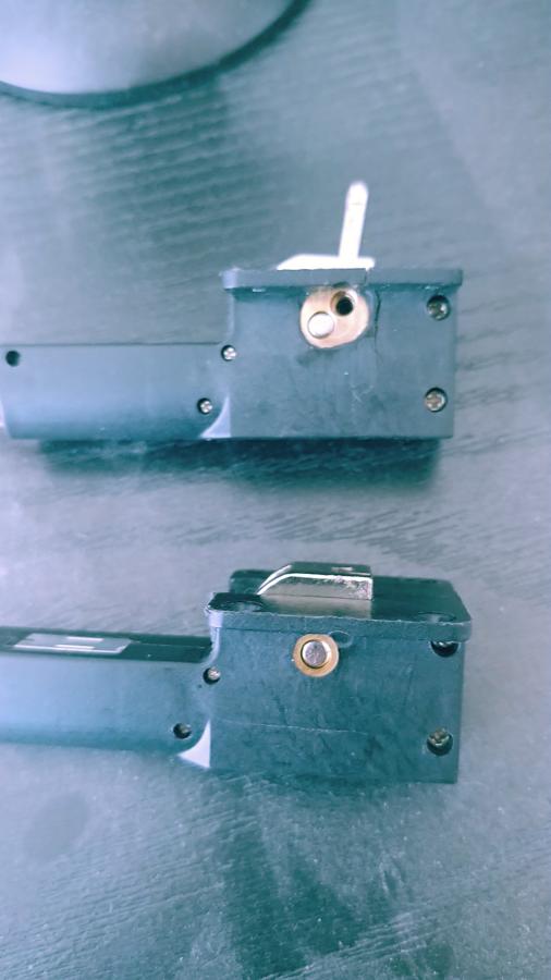

    upgraded landing gear F16 70mm
    I checked on Motion site and they sell front motor for F16, Type C.
    I have the upgraded version F16 70mm.
    The picture shows; (top) is main, noticeable difference how retract is held on the motor. Uaes two side screws. Also is beefier, w the extra brass and pin. Mine cracked from a mole trap at our field, but that is another story (previous created thread)
    (bottom item) is the front motor, only one pin and is held by a locking c-washer. I talked to tech support, no help at all.
    *both arw 3.1mm shaft
    I checked for other motors from other jets (maybe 80mm, or 4mm shaft motors), but none have a side shot.
    any help w this issue?

    I'm having difficulty understanding what your issue is.
    The nose gear retract pin is typically held in place by a C-clip because it needs to rotate with the nose wheel.
    The main gear is typically held in place with a fixed pin because it needs to be fixed in place and not rotate.
    Different retracts for different purposes. Buy the one you need (main?).

          • 5401
          To me it looks like C is for both the nose and mains.
          • kallend
            • 1877
            They are essentially identical other than the way the pin is held in the trunnion. The main needs the side holes for the grub screws that lock the pin in place, the nose doesn't. You can't use the one without side holes for the mains, but you can use the main ones for the nose.

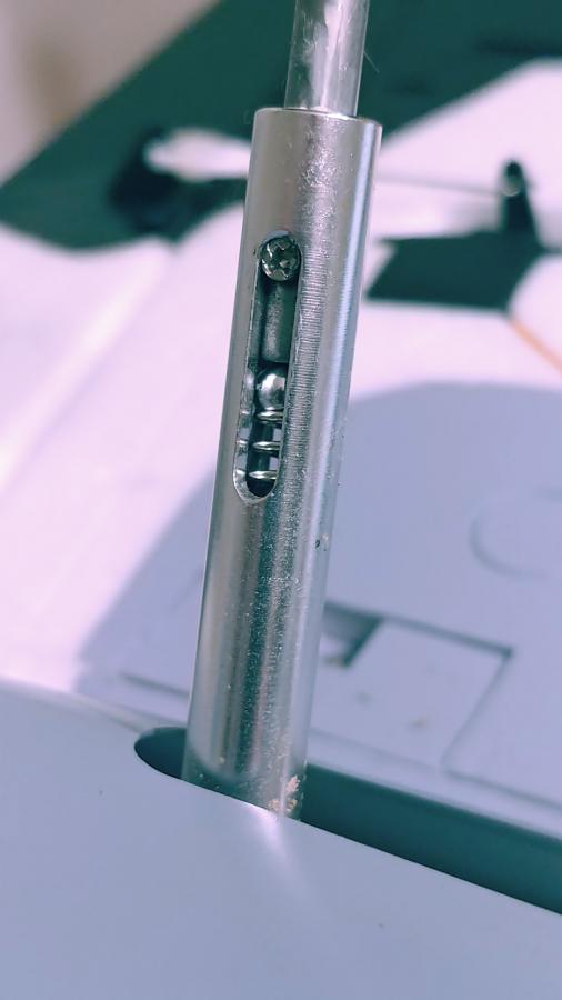

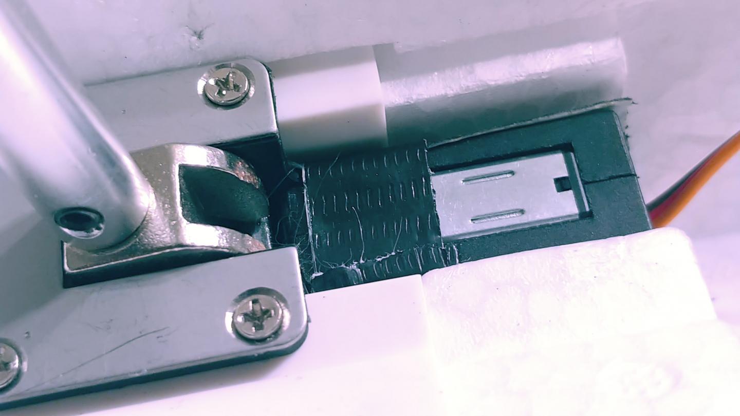

                I managed to somehow fix the retracts w rc shock shafts (that have C-clip ends), sone gorilla tape and ca glue.
                Cut the spring two loops to minimize the rebound and added a bb .177 to compensate for the gap.

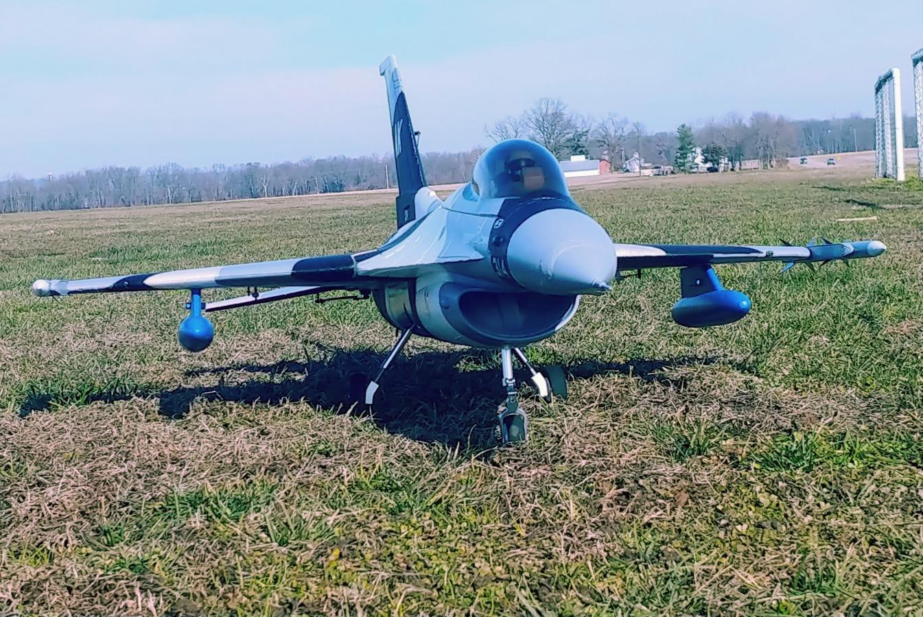

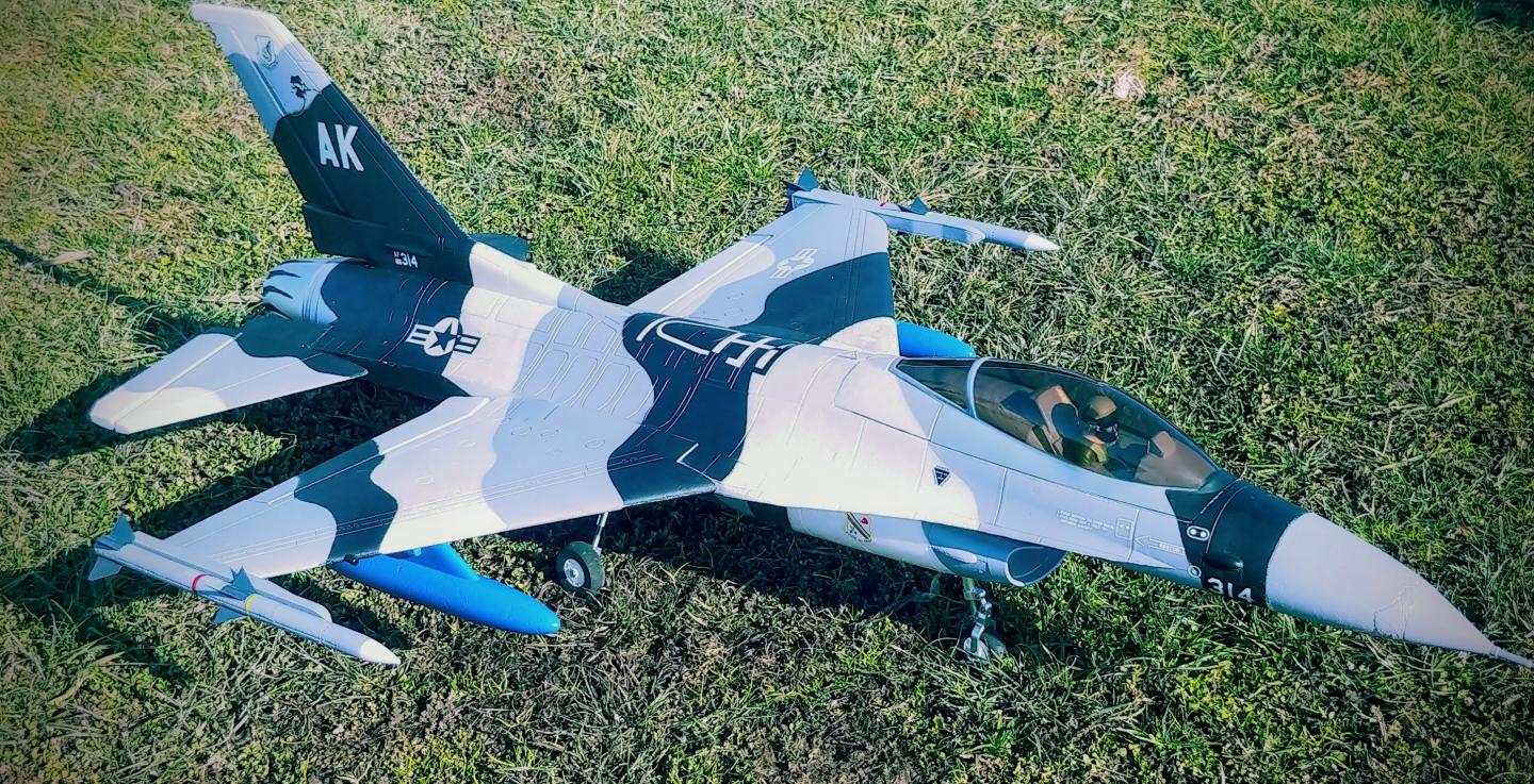

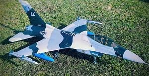

                Gave it a good hot bath to the nose cone, and the results are acceptable. Am no scale person etc, but had some armaments from a F15 64mm laying around and adapted them to the jet.
                I thought the tanks were going to overly standout, but in the air they complemented.
                Still have to adjust the left wheel, is pulling that way.
                Flew nice, saw the forecast and for a winter day, superb. At least Ican get a few flights while the parts arrive.
