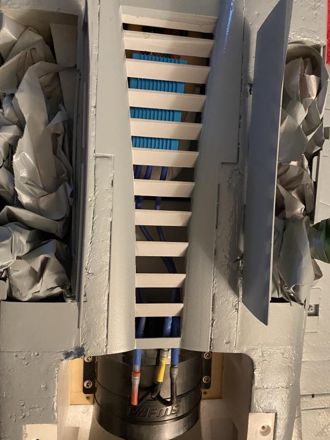

          Click image for larger version  Name:	C93FFB26-7459-4FC0-B6BE-2E84CE1F0C00.jpeg Views:	0 Size:	81.3 KB ID:	300994
          This is what I have. As I’ve said, I’m new to this and don’t know exactly what I’m looking at. It’s obviously an FMS 90mm motor, I’m not sure of anything else. I do have the stock lighting controller in the plane though and has 8A UBEC but the plug isn’t plugged into anything at this time since I only have a 6 channel receiver
          however, when I tested it with the eflite motor/esc all servos and flight functions worked accordingly.
            Chances are, what I described previously is the issue you’re experiencing ​. I see a Freewing 130A ESC (which should be an “Opto”, the word used to often refer to an ESC that does not have an internal BEC) in the picture you posted, which to my knowledge has only come configured as an “Opto” ESC from Freewing on their line-up of most 90mm EDF jets. Since you said you do see a 8A external BEC (often referred to as a UBEC) and you didn’t have it plugged in, this is why your lights and other electronics (servos, retracts, etc.) are not working. Does the UBEC say “Freewing” on it? That’s just so we can see if it’s the stock Freewing 8A UBEC. That UBEC servo lead needs to be plugged into the receiver to get power to the electronics.
            If you do not have any open receiver channels left, a Y-Harness servo extension may be able to be used on one of the receiver channels (and chosen wisely) already in use to share that channel with the UBEC (although, check with your receiver brand and instructions for precautions, specs., etc., for anything to watch out for). I prefer the UBEC to be on its own channel or an alternative appropriate slot in the receiver for such use (for example, my receiver brand provides a non-channel numbered designated slot named “Batt” for such uses).
            Your E-Flite ESC probably powered up the system because it had an internal BEC, so the electronics were receiving appropriate power.
            • #7
              Oh! You’re a life saver! I thought I was going to need to rip it apart to figure more out! Thank you so much, I just ordered an 8 channel receiver. I was going to go with one from the beginning but I was just trying to test everything with my 6 channel. Thank you again!!
