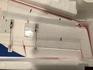

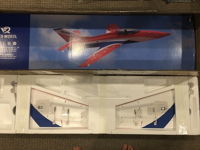

ID:	316586Click image for larger version  Name:	AC816378-4EFB-4823-8097-036A5570D9DD.jpeg Views:	0 Size:	88.6 KB ID:	316587A little open box review: Super neat packing. Everything looks great out of the box.
        All the linkages are connected on outer most holes on servo horn. As a precision flyer, I prefer mine connected closer to the inner holes. That’s about the only change I’d do out of the box. Battery trey has plenty of room to accommodate 6S 6000 mAh pack and then some. Receiver can be placed at a separate platform behind/above the battery tray.

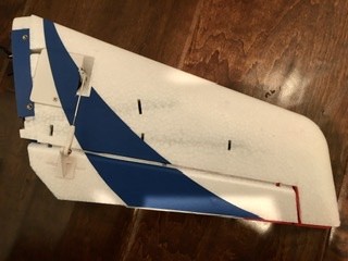

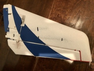

ID:	316593 Plenty of structural reinforcement to make this airframe strong. As small as the stabilizers are, each has two carbon spars running through them. And the wings also has two carbon spars running the full span and a robust wing joiner tube going out to the retracts. No risk of bending this air frame from aggressive maneuvering or over-speeding, that’s for sure.
