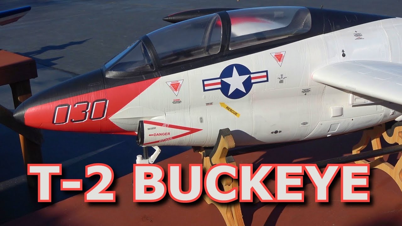

                        And here is a maiden video of the T-2 buckeye by a 3rd builder.
