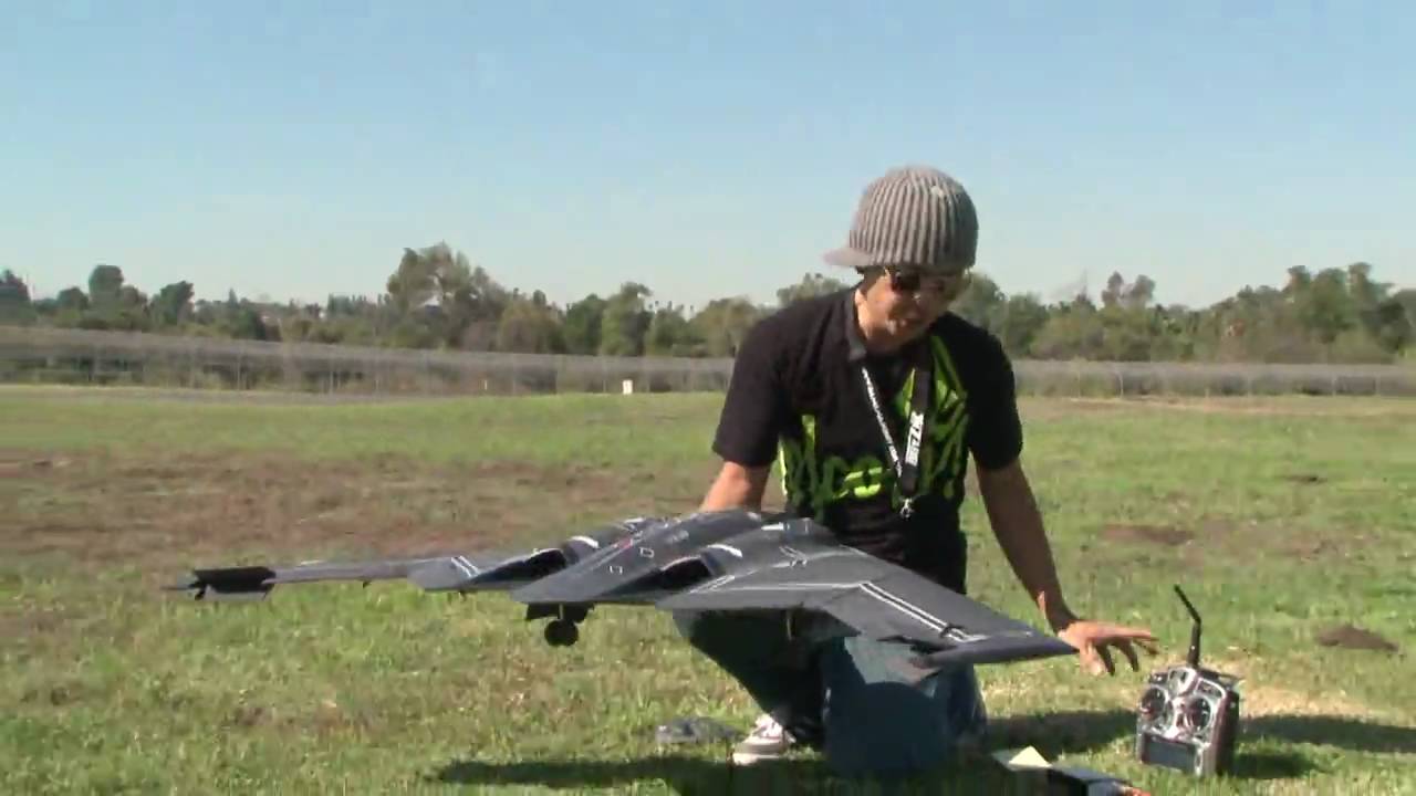

    Have you looked at Pete's video. Freeze it at various points and you'll see how those rudders should work, especially around 3:48. It doesn't look like they work the way your pictures indicate.

      Thanks XViper! You are correct that Pete’s video does not show the drag rudders operating as I have described. None of the RC flyers at my local field here in Las Vegas know how to answer my question either. However, just today my neighbor who is an air force drone operator came to the flying field and he was able to explain the drag rudder operation. He explained that my setup is correct and that is exactly how it works on the full scale B-2. So, as soon as I replace the stock cheap plastic tires with foam tires I will try a maiden. Thanks again!
