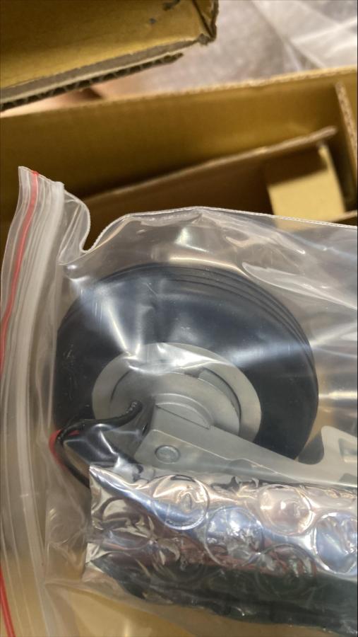

          Originally posted by whmc
          Sir, Can you confirm that electric retracts, struts, wheels and brakes are included as shown in assembly manual.
          Thanks for your time.
          It comes with electric retracts and brakes, struts and wheels. We opened a box quick to confirm

          • whmc
            • Apr 2020
            • 5
            Thank you James😀
            While your at it is tank included and is the led light controller/wiring included?
            • spy
              • 15
              Click image for larger version  Name:	MicrosoftTeams-image (10).png Views:	0 Size:	50.9 KB ID:	350345
              Thank u james for clarifying , i called mrc..and some1 said it has no electronics or gas tank...at least now we know it comes with landing gear and brakes

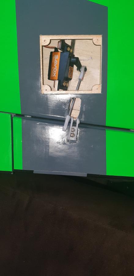

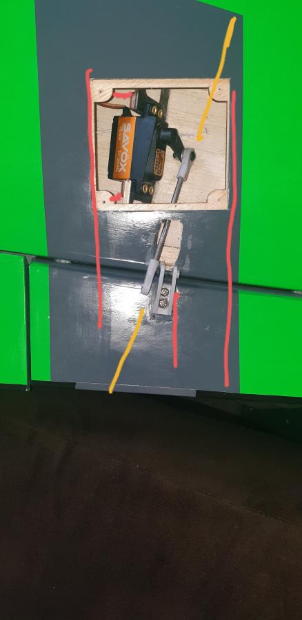

                                Heres an update...the Servo Tray on my Ailerons are Crooked .its bad.....the Aileron horn is "recessed"..and the rods barely have play.and Rubs on the top part of the hole..it a factory defect...Structural...the

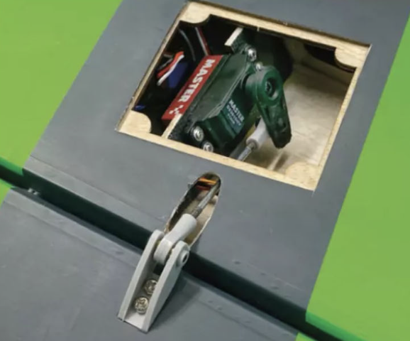

                                  • stephane
                                    • Jul 2022
                                    #18
                                    Hello,
                                    I saw this assembly in a test of this plane in a magazine.
Name:	Capture d’écran 2022-07-31 à 09.55.06.png
