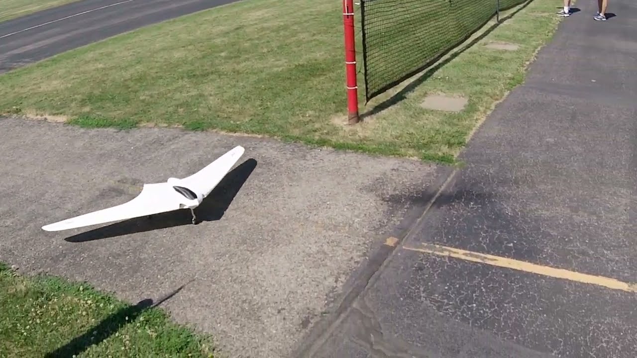

    Hi All,
    Wanted to share my most recent 3D printed project.
    1/10th scale Horten IX (Ho-229). This is the V2 which was the only powered version to fly, and has a different inlet shape compared to the more well known V3. Compared to many other RC Hortens, this does not require thrust tube extension to fly. Instead it uses a small fin on the underside of the fuselage.
    Unsure about the flight characteristics, I decided to design it for 50mms and make the model smaller. Though now having flown this, I definitely want to make a larger 70mm version in the future. It has working drag rudders, and can take-off in ~150ft on pavement.
    Uses the Freewing T-33 nose strut , and Su-35 retracts/struts for the mains. Flies on 4S 3700mAH for about 5 minutes mixed flying.
    Wingspan: 1680mm
    Length: 749mm
    Wing Area:51.6 dm2
    AUW: 2800g
    I made the files available for others to download:
    https://cults3d.com/en/3d-model/game...9-rc-model-jet
