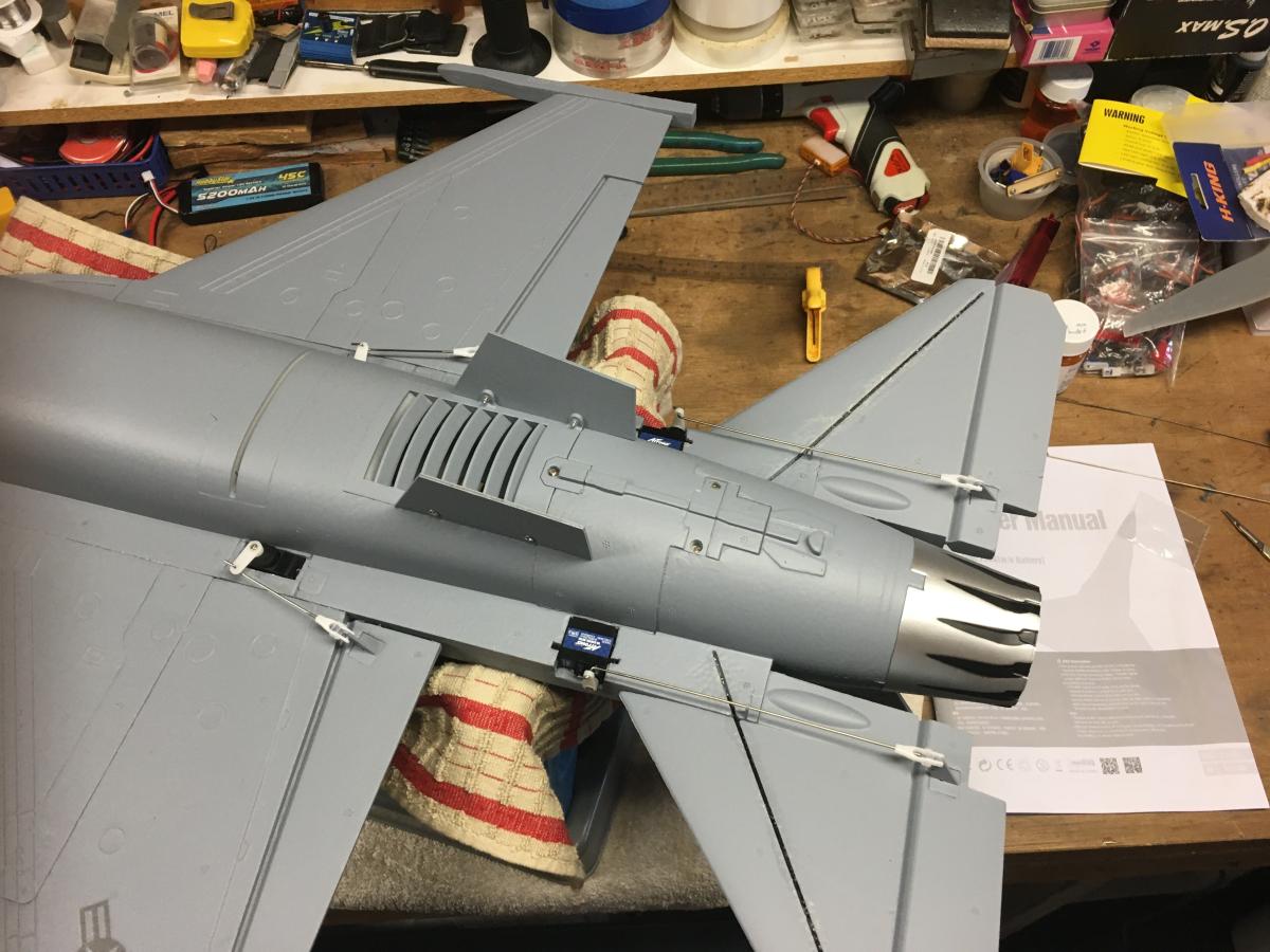

      The F-16 is okay out of the box. The quality is really good and it looks great. To me it has a few things lacking. Truely the only things from a stock perspective are visual, no pilot figure and no instrument panel decal. It's got a rudder that many 64mm don't have.
      That said I wanted more from mine. I pulled the 4S power out and put a decent 6S power set up in it. I also didn't like the limitations of the linked aileron to elevator set up so I added the extra servos and now have flaperons and tailerons as well as regular ailerons and elevators. It is one of the smoothest flying planes I own. If it only had some micro light weight retracts.
      The new FreeWing 64mm Banshee is looking promising especially with the possibility of coming 6S.

          I have the F-16 64mm and love. Did the mod adding elevator servos. No gyro and it is smooth as can be. Belly land in high alpha easy as can be.

            WV, do you have a picture of how you did yours? I bought a second one and I'm positive it will also get elevator servos but always looking for better ways. Here is how I did Home
            Did everyone see the new Banshee? Mines on order and I have a 6S set up already waiting.
