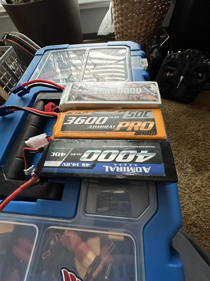

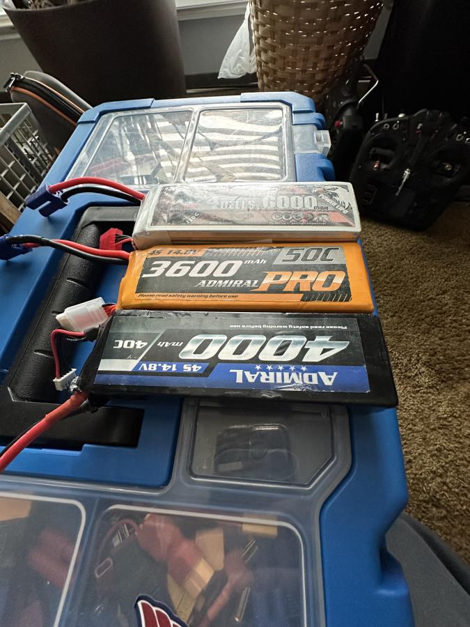

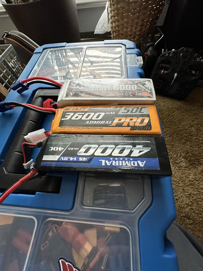

            Please note that I don't have this plane, however in terms of battery requirements, here is a picture of 3 batteries, 2 of which have been mentioned in this thread. The weight of the Admiral 3600 is 380g. The Admiral 4000 is 390g. I put in the Coddar HV 6000 because that's what I have and it weighs 430g. Dimensionally speaking, you can see that the length and width of the 3 are similar and the thickness of the Coddar HV is slightly more. If you were to choose something like the Coddar 4500, 4s HV, it would weigh only 342g and dimensionally much smaller in thickness. As you can see, simply talking about mah is not the whole story.
            Click image for larger version  Name:	IMG_4342.jpg Views:	0 Size:	99.7 KB ID:	359904
