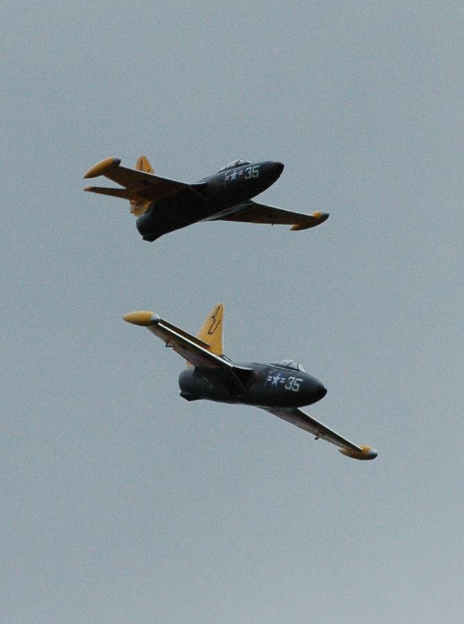

          I love this airframe! We've had as many as 8 flying together.
          Freewing F8F Panthers in Formation
          Caption
          • Fly2XS
            • 10

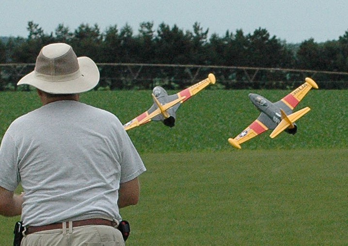

            Launching
            • Fly2XS
              • 10

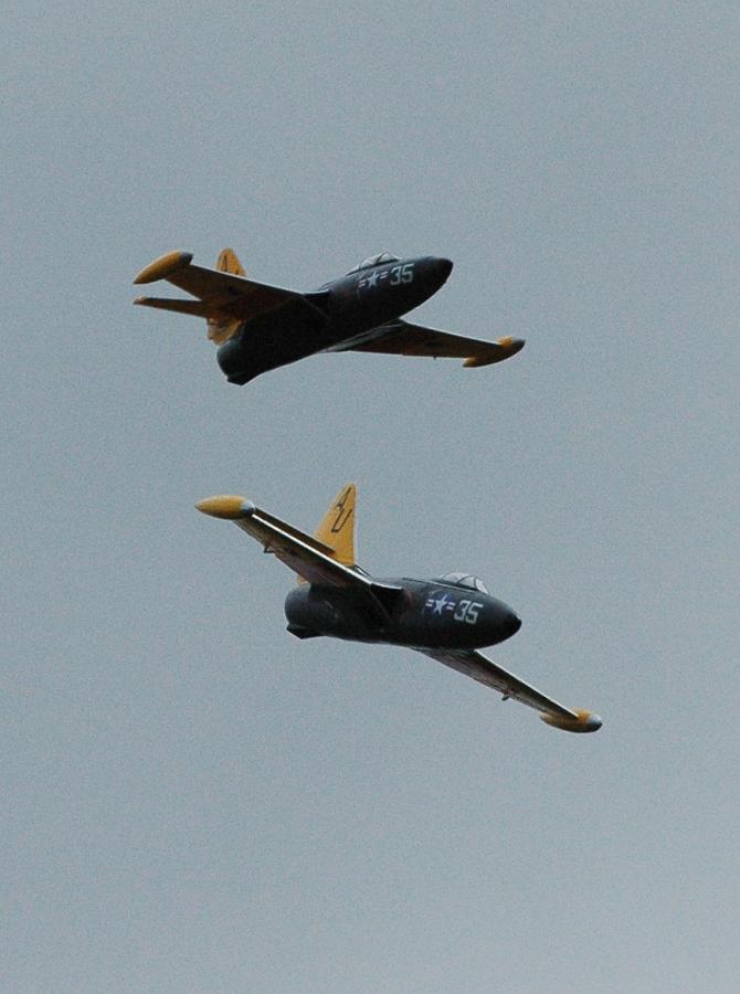

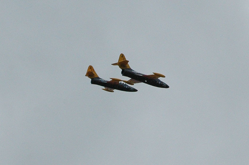

              More Formation Flying . . . Freewing F8F 64mm EDF Panthers on 3S-2200 cells
