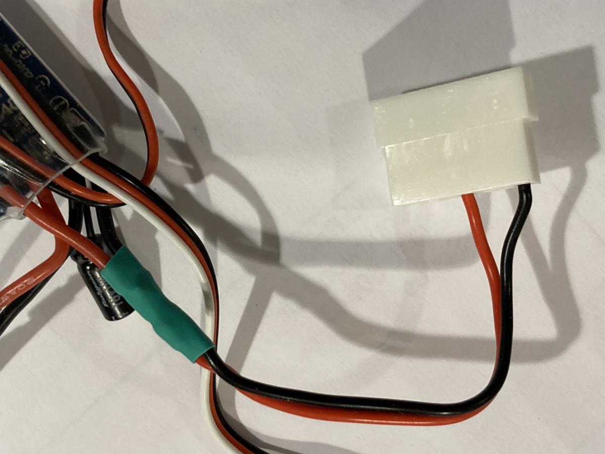

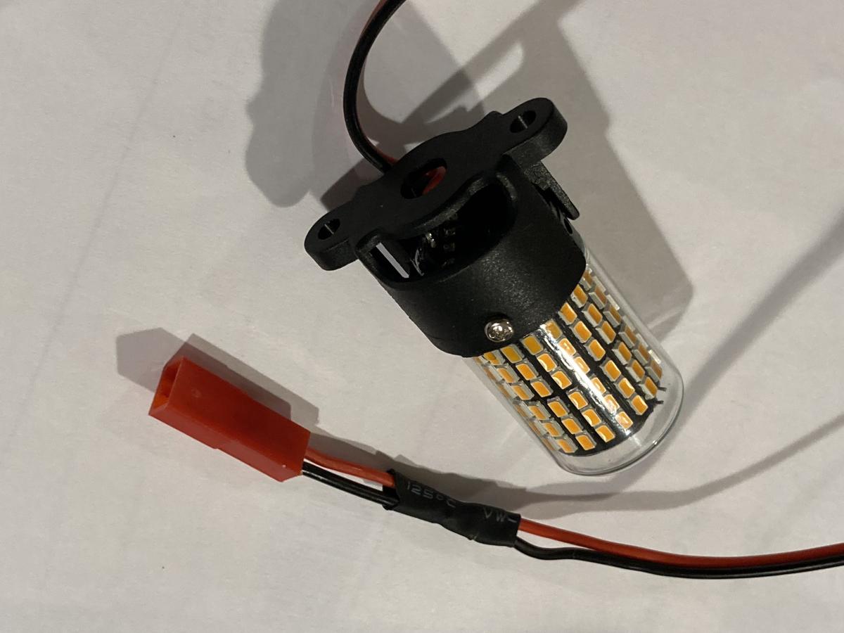

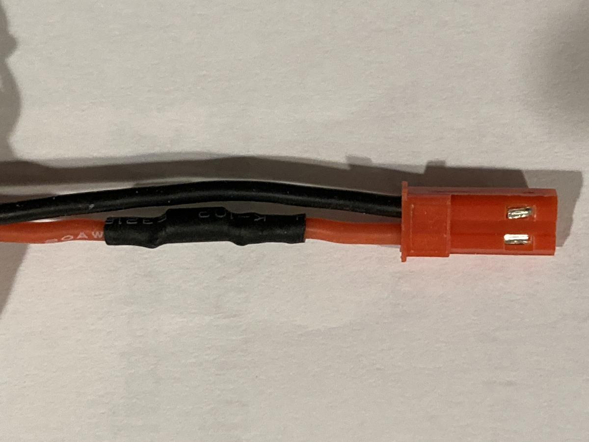

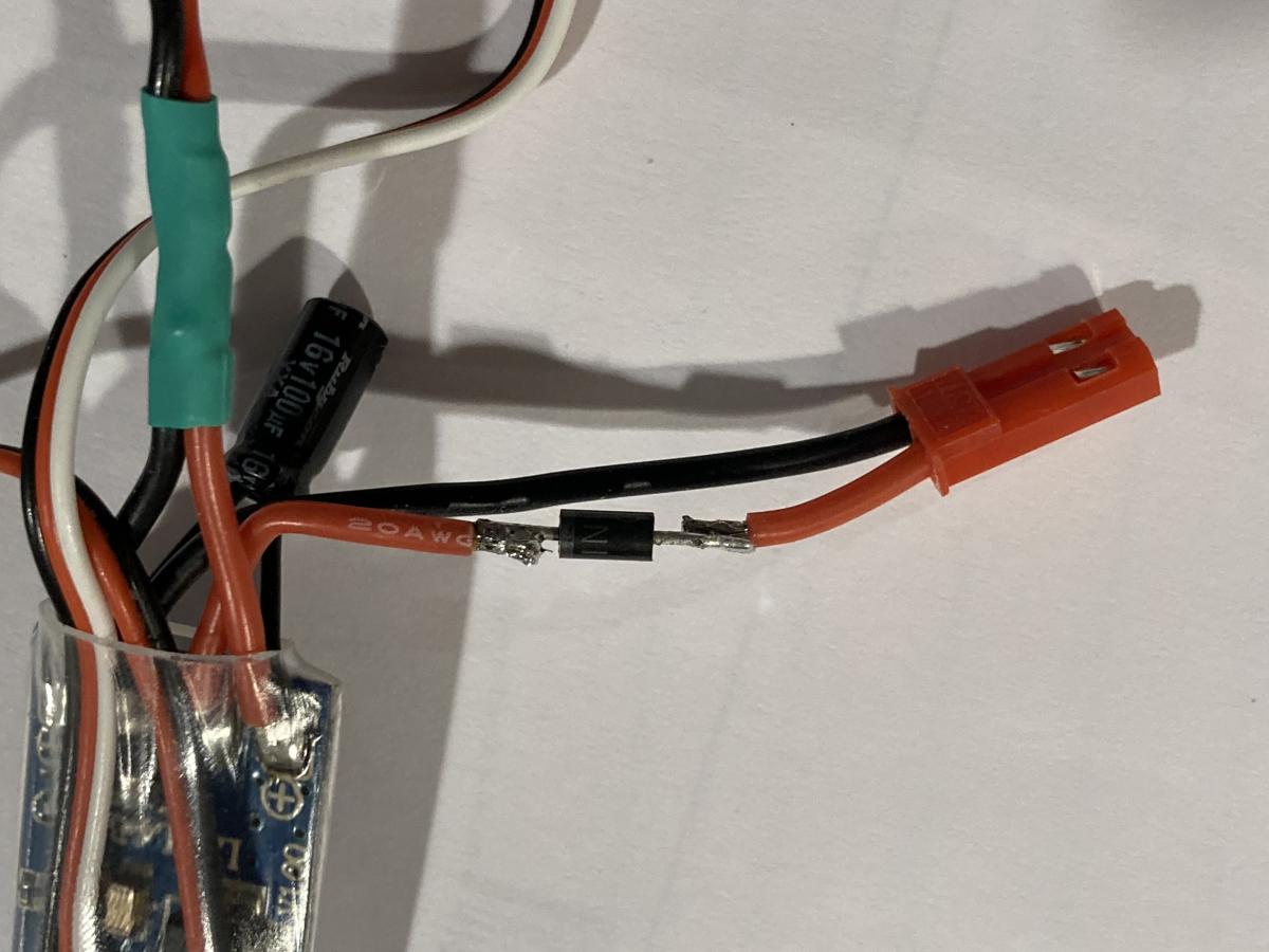

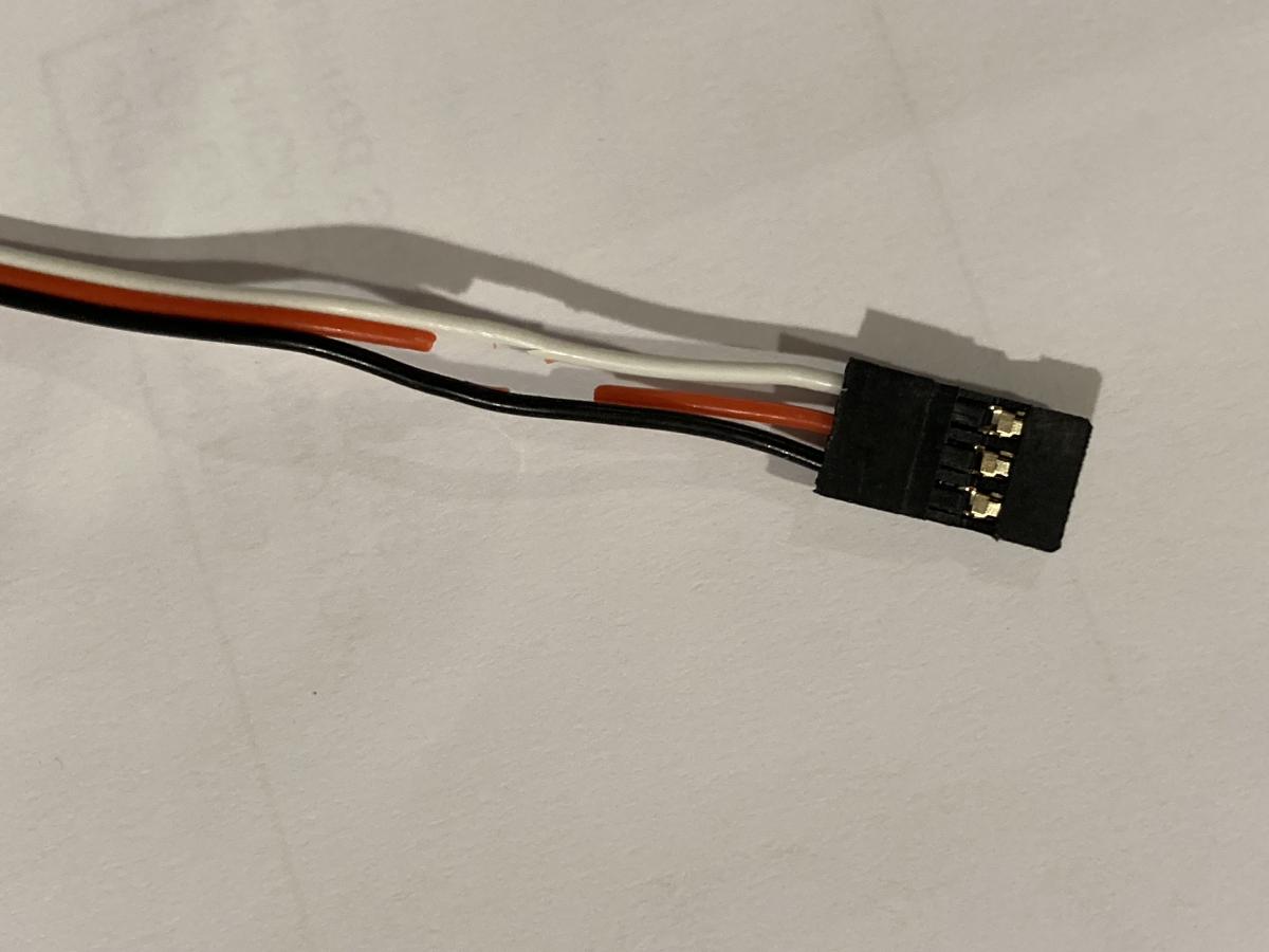

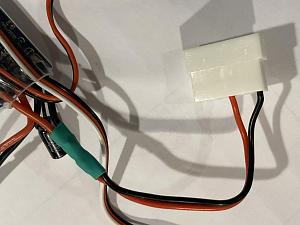

                                • kallend
                                  • 1863
                                  #36
                                  ​Some photos showing the various steps described in the previous post:
                                  Click image for larger versionName:	IMG-8313.jpgViews:	0Size:	67.8 KBID:	373576Click image for larger version  Name:	IMG-8314.jpg Views:	0 Size:	83.9 KB ID:	373577​​ Click image for larger version  Name:	IMG-8316.jpg Views:	0 Size:	83.1 KB ID:	373579Click image for larger version  Name:	IMG-8319.jpg Views:	0 Size:	92.9 KB ID:	373580Click image for larger version  Name:	IMG-8315.jpg Views:	4 Size:	92.7 KB ID:	373578​​​
                                  , and here is a video showing the fix, with the lamp turning on at approx. 1500 microseconds, which would be 50% throttle.
                                  https://youtu.be/YPt7kKDu_3o
