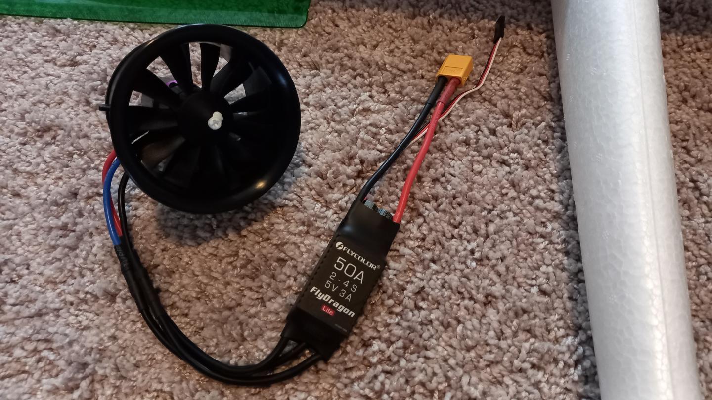

                    Click image for larger version  Name:	20230612_093136.jpg Views:	0 Size:	190.2 KB ID:	380714Sorry for the confusion. This is what I have. I bought a servo to test it but nothing happens when I plug in the turbine to the servo. I am thinking I have to charge this battery pack that's attached to the turbine in the pic to make it spin. Is that right?

                      The thing that's connected to the fan motor by three wires is an electronic speed control (ESC) not a battery. A battery to power the fan needs to be connected to the two wires (red and black) that come from the other end of the ESC. The thinner wires (red, white, black) also coming from the ESC need to go to a receiver or a servo tester (apparently you have a servo tester already but it isn't in the picture). The servo tester sends a signal to the ESC which tells the ESC how much power to send to the fan. Your picture does not show a battery. That ESC will take from a 2S to a 4S** batttery, which will need a connector compatible with the yellow connector on the red/black pair
                      Without knowing exactly what your connector is, il looks to me like the battery you need is something like this:
                      (which is overpriced but if you search around with Google you will find others like that at a reasonable price).
                      You will need to be able to charge the battery. I'd look for an inexpensive charger that has the correct connector and can handle a 4S pack..
                      ** 4S means it has 4 cells in Series.
                      Be careful, LiPo batteries can catch fire if mistreated and the fire can be very nasty and difficult to extinguish.

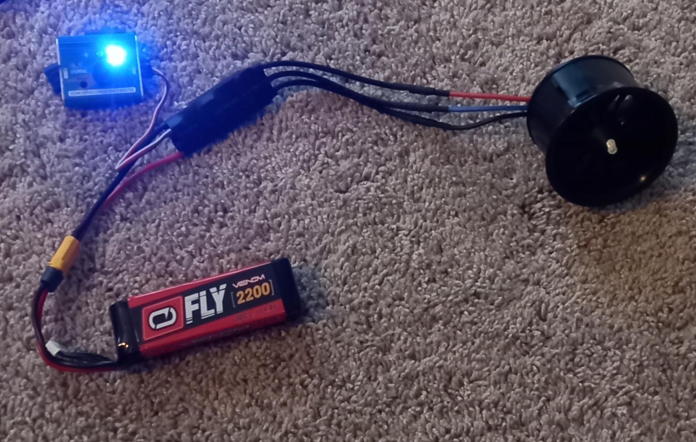

                            ​I have the servo tester, battery and ESC connected to the turbine. The turbine beeps and twitches intermittently when attached to the battery, so I'm assuming that means it has power and is standing by. When I turn the knob on the servo tester nothing happens. What am I missing? TIA. ​ Click image for larger version

                              • 5426
                              Plug the red black white into the left side of the controller
                              • lashrew
                                • Jun 2023
                                • 15
                                That worked!! Thank you!!
