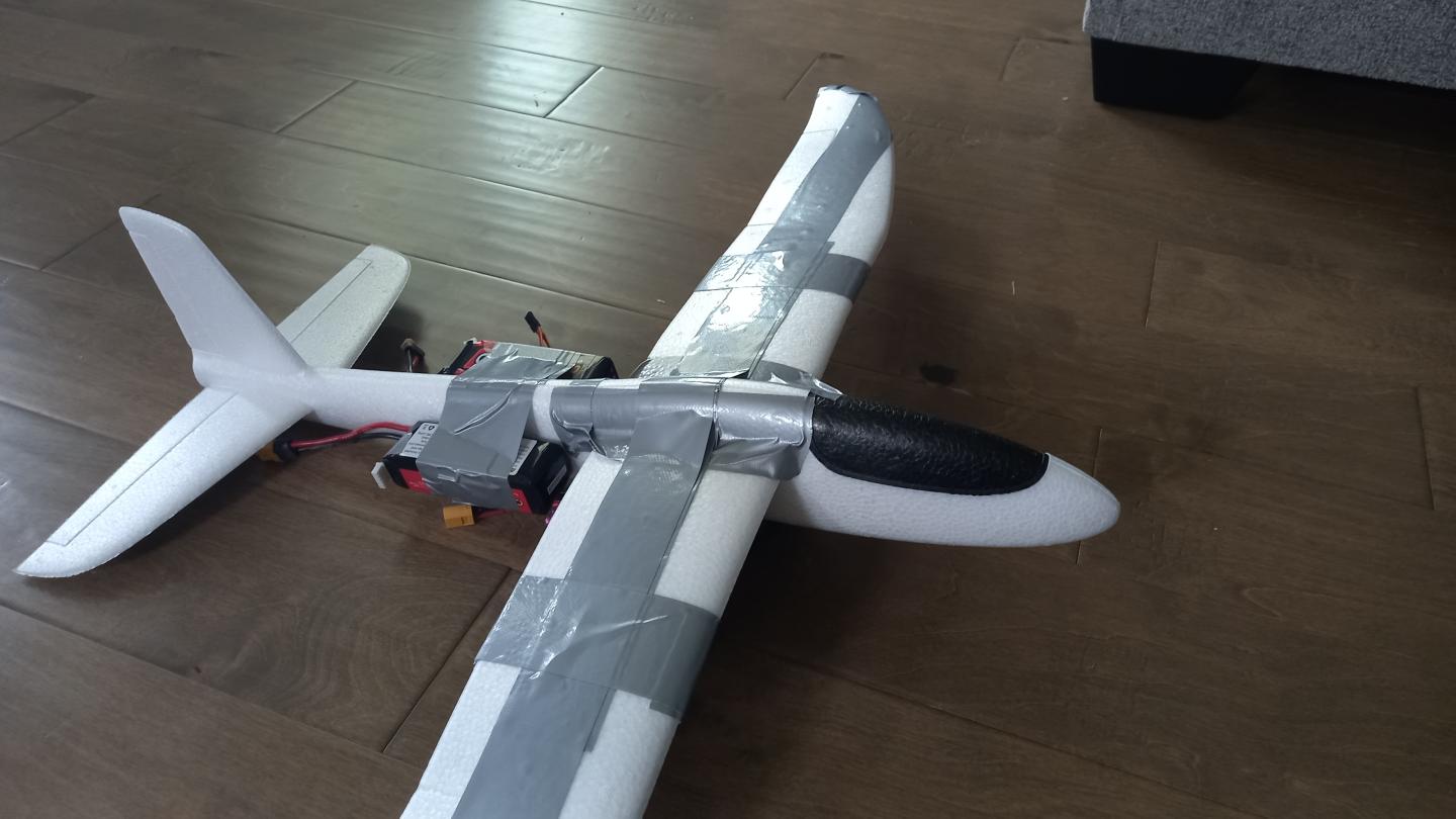

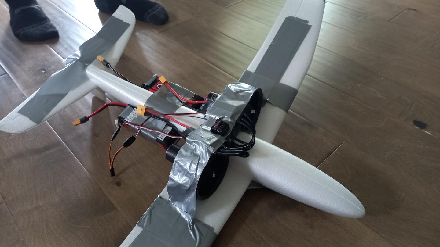

              #26
              Ok...I'm expecting this to hit the deck like a brick or rip itself apart. It's ugly and terribly built...but we're going to have fun anyway, throwing this in a field. Will bring a fire extinguisher as suggested...lol. Yes, the body is styrofoam. And yes, that's duct tape. I know. I'll post about the outcome soon.

                #27
                Are you sure that is balanced where it should be?

                  #28
                  Have you checked the centre of gravity ? With the nose facing towards you stick your left forefinger under the left wing close to the fuselage( body ) about a 1/4 of the way back between the front and back of the wing and do the same with your right forefinger on the right wing. Lift the plane up and it should be level. if it is not ( and looking at it I doubt it will be level and the tail will drop straight down and you will have a rocket that will go vertical then probably loop and hit you in the back of the head !!!!) then consider moving the batteries to where the front canopy is and maybe moving the motors forward a bit.. At the moment your model looks very tail heavy and has a high wing loading which means it has to fly fast to stay in the air !!!!.. spend a little time watching this
                  https://www.youtube.com/watch?v=uF8qCbuojcM.
                  Once you hit this youtube page there will be other design videos on screen you can skip through to help you. Getting the cg or centre of gravity right is a must for a successful flight and the lighter wing loading the easier it will be to fly ( a 3 sq foot wing area weighing 1 lb flies a lot easier than a 3 sq ft wing area weighing 3 lb ) I know you just want to see it fly but a little more time and patience now will lead to a more successful and less disappointing first flight.

                    #29
                    We got three test flights in before we had a non-nominal event that broke off the tail section. It was a lot of fun. At max power to the engines it went pretty far before tumbling and crashing. It was never in control because of the mis-balancing and all the duct tape holding it together...but now we've had a fun introduction and we're hooked. Thank you all for the tips and leading your knowledge and experience to our first attempts. Next stop is the hobby shop to talk to people there and get a proper body. There is also a model flyers club near us that we will check out. Again, thanks to everyone for your help!
