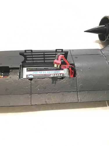

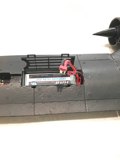

        Im going to fly this weekend with the 4s2600 with the stock motors, (still waiting for the new 64mm motors) if it handles that i will try 4s3000

                              with my 4s 2200 i am landing with timer going off at 1;30, so after its on the ground its about a 2 min flight, and the battery is around 3.75v . with the 4s 2600 i set the timer at 2 min and on the ground about 2;30, the battery is around 3.78v . My goal is to get a 3 minute flight, so I will go to 3000 or 3300mah that should do it.

                                those above times for the batteries are with 3/4 to full throttle, as it seems it would want to drop out of the sky at slower speeds. Although, it does float relatively nice coming in for landings with 1/4 to 1/2 throttle
