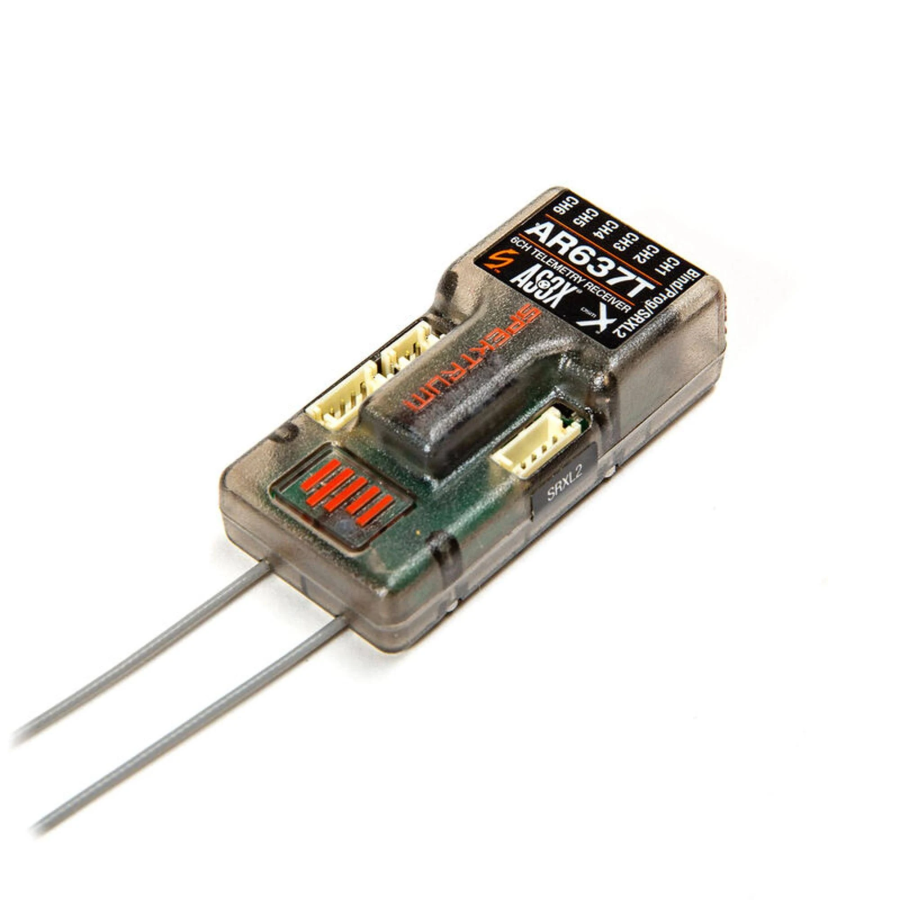

    Hey Guys,
    I'm new to RC planes and this forum. I'm currently building an E-flite Viper 70mm and I'm trying to install a afterburner but I can't Y-harness it to the throttle because the avian smart esc won't allow it. I would have to plug it to a separate channel and do some mixing. My question is, can I Y-harness the BEC to another channel or does it has to be plug to its own channel?​
  • kallend
    • 1877
    ASSUMING the receiver is a recent Spektrum with an SRXL2 port at position zero (next to the throttle which is at port CH1) you can plug the Avian into that slot (zero) and it will work. You can then plug your afterburner into port 1 and it will work too. If you look at the receiver you will see that slot zero is labelled "Bind/prog/SRXL2"
    Avian has an SRXL2 protocol input, which is why is messes with your afterburner (which doesn't understand SRXL2 coding) when they are Y'd together, and which is why the Avian works in slot zero.
    Incidentally, a Viper is not a good plane for someone new to RC.
    Click image for larger version  Name:	image.png Views:	0 Size:	379.5 KB ID:	398366​

      Thank you so much for your help.
