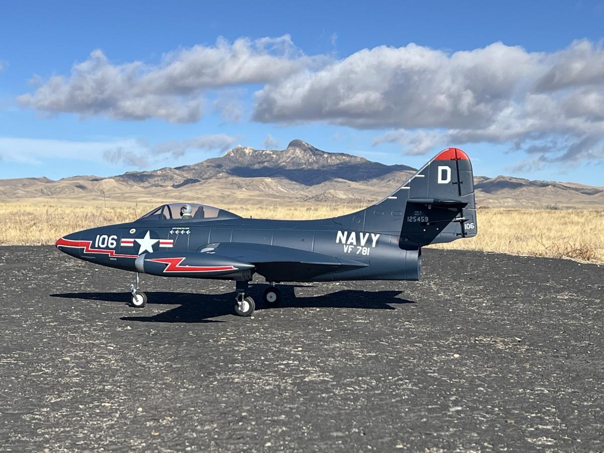

    I brought my new F9F Panther airplane to do the maiden this morning. I flew my "weather ship" E Flite Beech 18 and the air was pretty rough but got several flights in. The wind continued to increase to a direct crosswind so I decided to just do some ground tests for today, and then hopefully fly it tomorrow. It handles the rough runway pretty well, and is very responsive for taxiing. Range checked, full power static test, and ready for tomorrow, (weather permitting.)

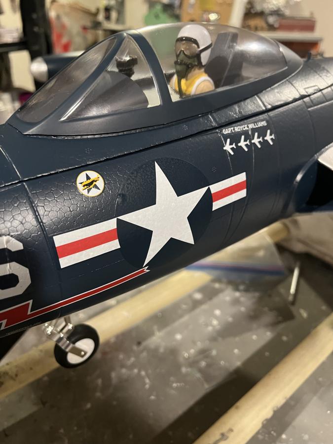

          Below is my latest detail addition to the Panther. I got a period accurate jet pilot from the Korean war era from Chris Wolfe, and painted him up. Also, I printed up a Mk 8 gunsight for the plane. I had files of this and other detail parts for the cockpit for the Flightline 1.6m Corsair, and made adjustments to the printer to scale it down to 72 percent of the size for the Corsair so that it would be the proper size for the Panther. Worked like a charm,learned yet another thing about 3D printing, for an old 3D printing nugget!

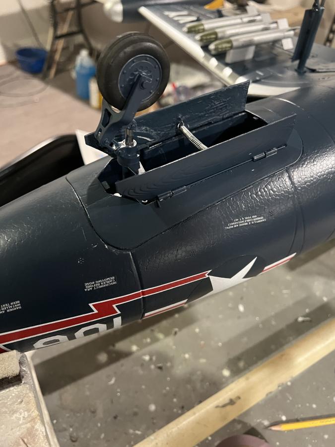

            After taking it up for a couple of flights the other day, I brought the Panther back into the shop for a few days to do some add-ons (bling) to make it look a little more realistic, despite its small size.
            These are the things I added lately:
            1) more scale gunsight for cockpit
            2)new pilot from Chris Wolfe to better reflect the 1950s Korean War period
            3) printed and installed new nose gear doors that use a spring to keep them open or pull them shut when the gear retracts
            4) Alhhough not scale, a better looking cover for the main gear doors. Looks better, although the real ones had inboard gear doors that cycled open and closed. This is good enough for this little bird, for me

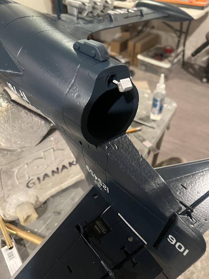

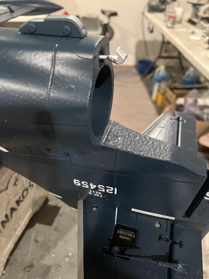

            5) Did a semi-scale tube and tail hook that comes out of it. It could eventually be made to cycle up and down if I decide to do that down the road. I did do one of these for an F6F Hellcat that worked ok and was a similar design, being a Grumman aircraft, too.
            6) A two-position printed tail skid that can be mounted open or closed for display or flying
            7)repainted the wheel hubs and struts in Navy Blue paint to follow the paint schemes of the era.
            Not much else to do on it now, although other things might come up down the road. Really a great and easy flyer.
