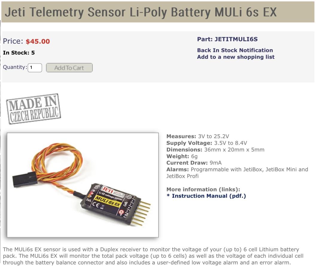

          My 35 year old AMA RC Club is all Electric. Many fly large heavy 90mm EDF Jets. A cell going bad in flight will crash the jet so we have this Battery Cell Sensor plugged into the LiPo Balance connector. But the Afterburner light also plugs in to it. We need a Y-connector for the two of them. Know where we can buy one?

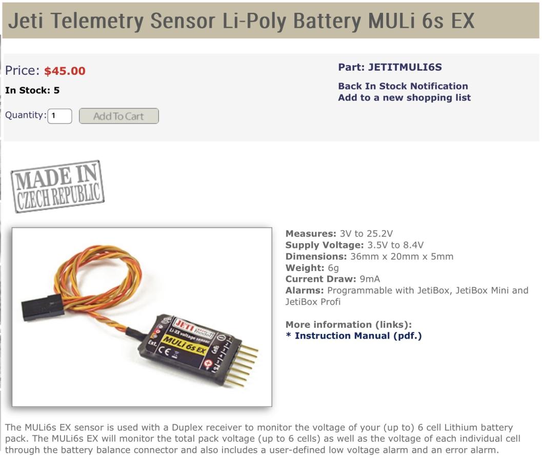

              You can buy balance cable extensions and solder up a Y pretty easy. "large heavy 90mm EDF Jets", not flying 8S?

                    Get what? The afterburner? A Y? With what he is doing he still needs a Y. Of course, he could do what I do and run my AB through a 25V+ to 12V regulator. That way the AB is drawing off all 6 or 8 cells and not just 3 or 4 which will show an unbalanced pack through his cell checker.
