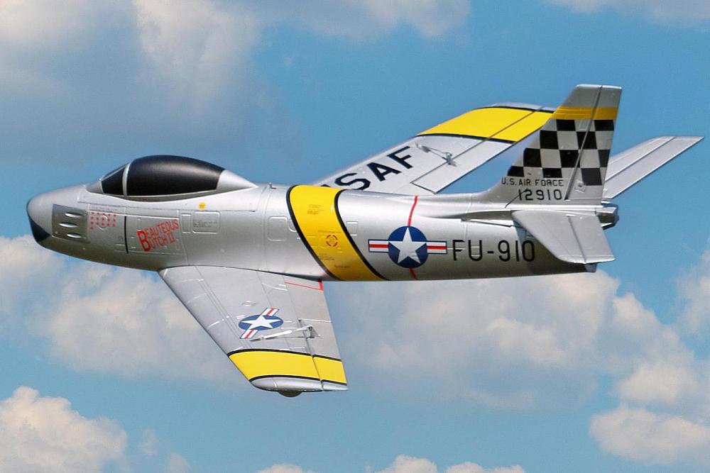

    F-86 Sabre 64mm V2 EDF Jet from Freewing - PNP - FJ11521P
    The legendary F-86 Sabre returns in an all-new V2 design, featuring updated molds and an improved scale appearance. This 64mm EDF jet captures the essence of the iconic Korean War fighter, with molded panel lines and a sleek, refined finish with Joseph McConnell’s Beauteous Butch II livery.
    Designed for both convenience and performance, the Sabre’s detachable main wing allows for easy transport, while the compact size makes it a perfect toss-and-go flyer. A simple assembly process gets you airborne easily.
    Powered by a 2840-2850Kv outrunner motor and a 64mm 12-blade EDF, the F-86 delivers impressive thrust. It’s optimized for common 4S 2200-2600mAh LiPo batteries, with a spring-loaded battery hatch for quick, hassle-free access.
    Built from durable EPO foam, this F-86 Sabre V2 is made to last, offering pilots a stunning blend of scale detail, easy handling, and thrilling jet performance.
    Completely New Design
    The next-generation F-86 64mm EDF showcases a range of performance and design upgrades that elevate realism, flight capability, and convenience, thanks to completely reengineered design.
    Detachable Main Wing
    Conveniently secured, the main wing attaches and detaches easily with 4 screws for easy transport and storage.
    12-Blade 64mm EDF with 2840-2850Kv Outrunner Motor
    Efficient 2840-2850Kv Outrunner motor and 12-blade EDF offers great power, speed and sound on common 4S LiPo batteries.
    Convenient Size
    Compact size makes it perfect for tossing in the car and easy hand launches.
    Features:
    • All-new design with new molds for improved scale authenticity
    • Iconic Korean War-era US military jet featuring the livery from Captain Joseph McConnell’s Beauteous Butch II
    • Included, scale drop tanks add extra scale realism and attach easily with a sliding rail system
    • Detachable main wing secures conveniently with four screws for easy transport or storage
    • Compact size makes it perfect for tossing in the car and easy hand launches
    • Simple assembly gets you airborne easily
    • Molded-in panel lines enhance the realistic scale appearance
    • 2840-2850Kv outrunner motor paired with a 64mm, 12-blade EDF’s for strong, efficient thrust and great sound
    • Compatible with common 4S 2200-2600mAh LiPo batteries with an XT-60 connector
    • Spring-loaded battery hatch allows fast, hassle-free battery changes
    • Durable EPO material offers superior strength and durability
    Includes:
    • Freewing F-86 Sabre 64mm V2 EDF Jet - PNP
    • 12-blade 64mm EDF power system (installed)
    • 2840-2850kv outrunner motor (installed)
    • 40A ESC with reverse thrust and XT-60 connector (installed)
    • Servos (installed)
    • Instruction Manual
    AGE LEVEL :14 and up
    SKILL LEVEL :Intermediate
    BUILD TIME :1 Hour
    Scale 1/14
    Wingspan 805mm / 31.7in
    Length 843mm / 33.2in
    CG (Center of Gravity) 131mm from the leading edge of the wing at the wing root
    Flying Weight 570g / 1.2lbs without battery
    Power System 2840-2850Kv Outrunner Motor with 64mm 12-blade Fan
    Speed Control 40A Brushless ESC with thrust reversing
    Propeller / EDF 64mm EDF with 12-Blade Fan
    Servos
    Landing Gear None
    Required Battery 4S 14.8V 2200-2600mAh LiPo with XT-60 Connector
    Required Radio 3-4 channels (Throttle, Aileron, Elevator and optional thrust reversing)
    Ailerons Yes
    Elevator Yes
    Rudder No
    Flaps No
    Lights No
    Hinge Type Live Foam
    Material EPO Foam
    Skill Level Intermediate
    Build Time 1 Hour

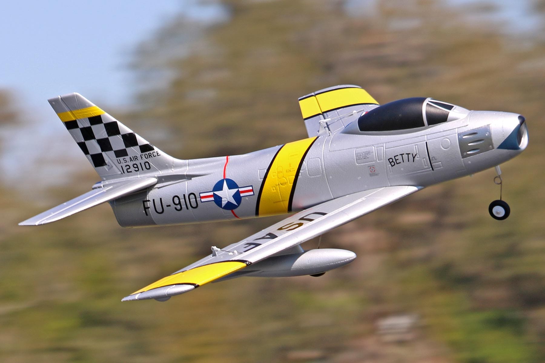

    Landing gear option:
    Buy Freewing F-86 Sabre 64mm V2 EDF Jet with Landing Gear - PNP online at Motion RC. Order online with fast delivery.
