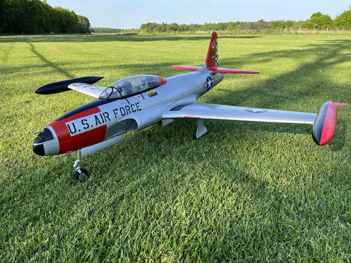

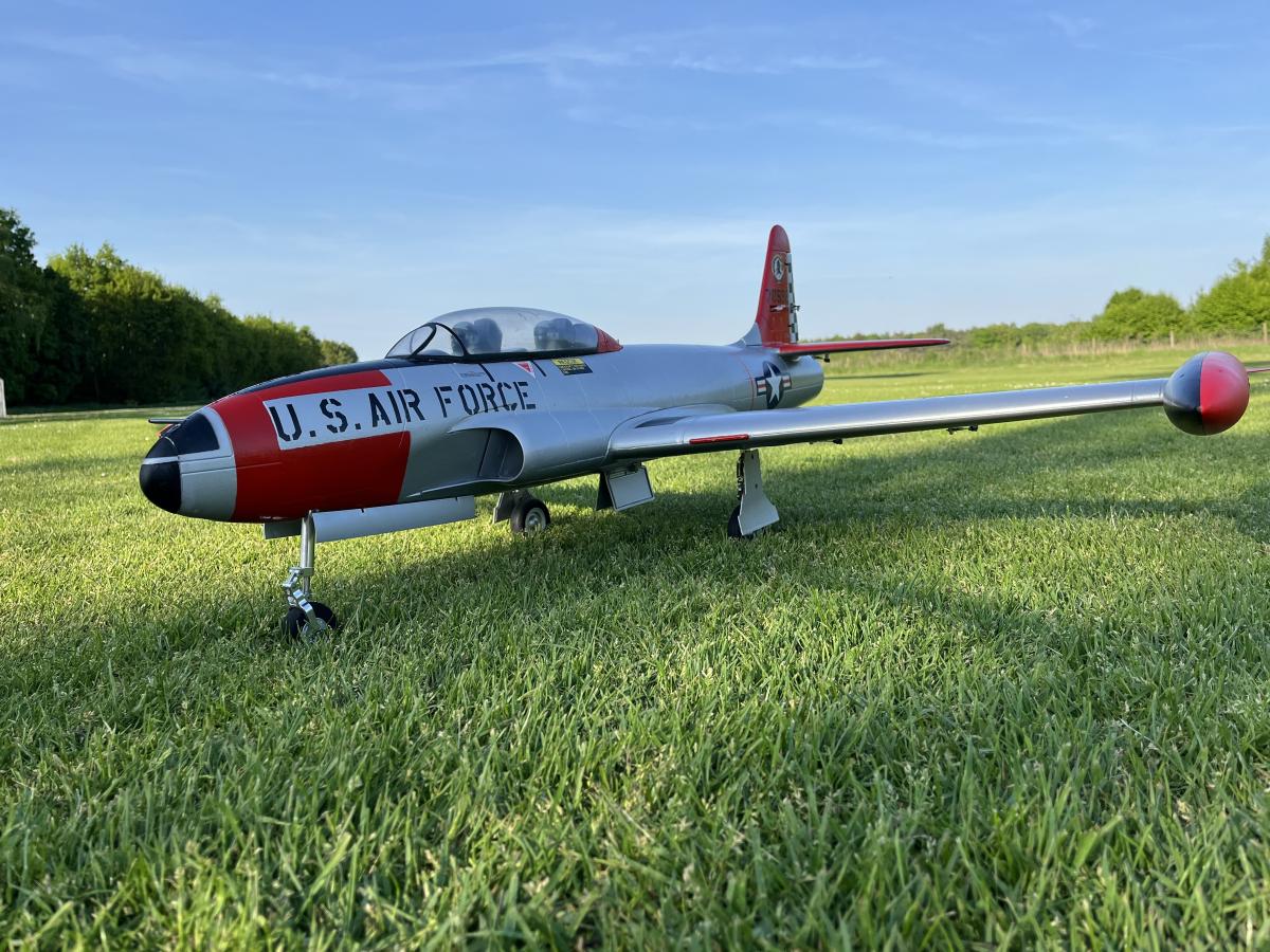

              Hi
              I crashed mine a few weeks ago in heavy wind conditions, in a turn a wind gust hit the plane no lift and was able to recover only some trees where in his pad, complete loss.
              I bought me a second one long ago as spare so Yesterday I was able to fly my beloved T33 again.
              Grtz Hans
