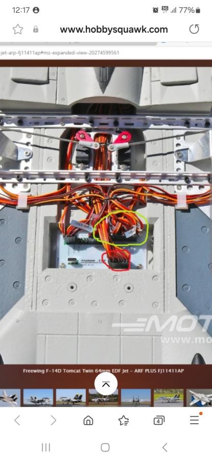

    How do i get these wings to line up properly? One of the wings is about 5 degrees off of the other, even when I match them at forward sweep. One of the servo arms is not the same as the other and I cannot adjust the arm to match. I’ve watched all the build videos I can watch and even their wings do not line up perfectly.
    TIA.
    Stock servos and setup.

    What do you mean one is not the same as the other?
    Go here and look at the photos:
    F-14 Tomcat Twin 64mm EDF Jet from Freewing - PNP - FJ11411P Easily one of the most iconic jets in history, we’re excited to bring the new, officially licensed, Freewing F-14 Tomcat to market in a twin 64mm EDF size. Featuring sweeping wings, retractable landing gear, full flying stabilizers and a livery based on the
    Particularly this one:
    "Clock" (IE, remove one arm or the other off the servo and rotate it one or more teeth) those red arms on the servo so they are both at the same angle when at full sweep or at no sweep (take your pick which ever looks more clear to you). Adjust the lengths of those rods so that both wings are at their end stops (more or less).
