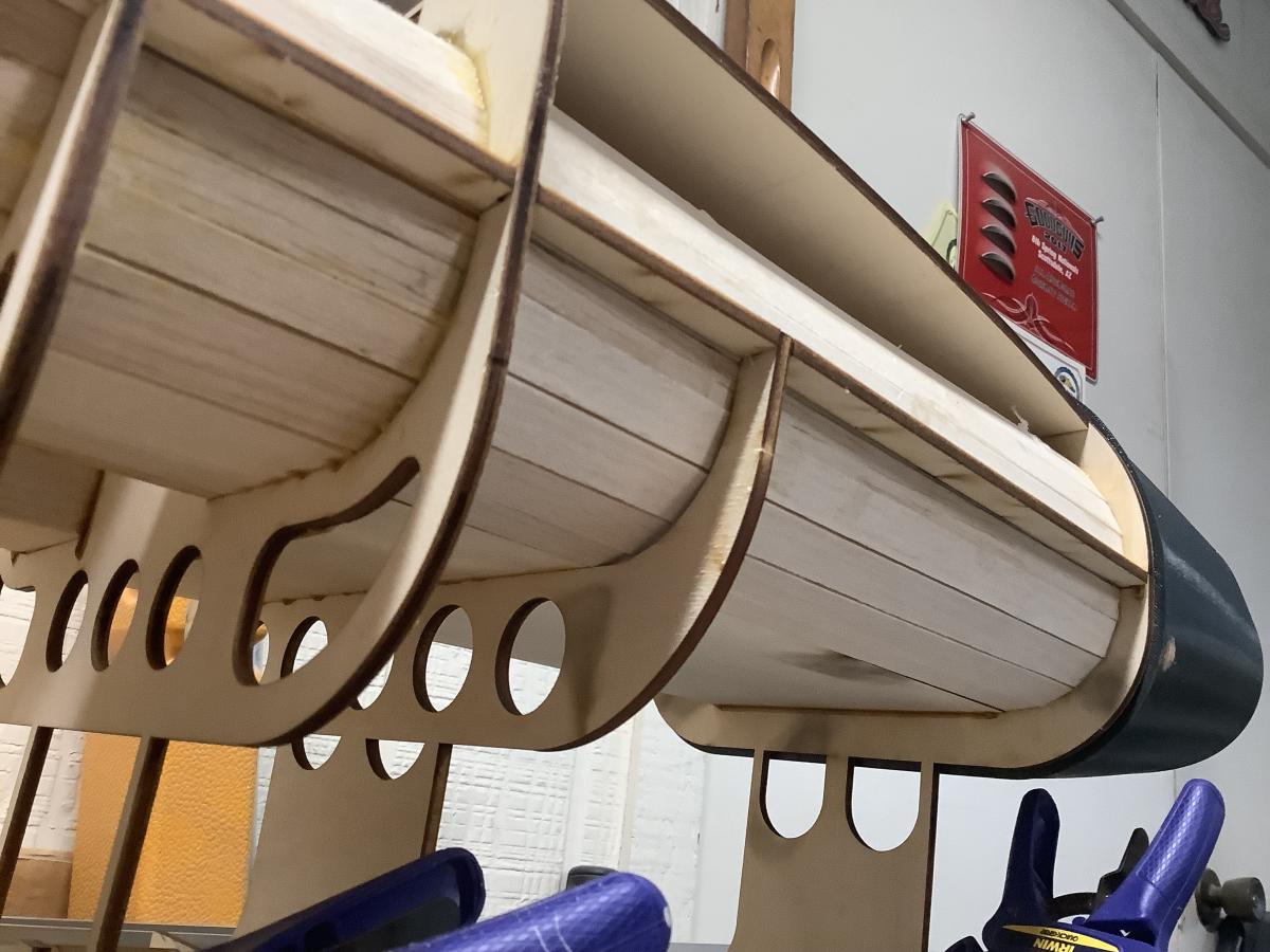

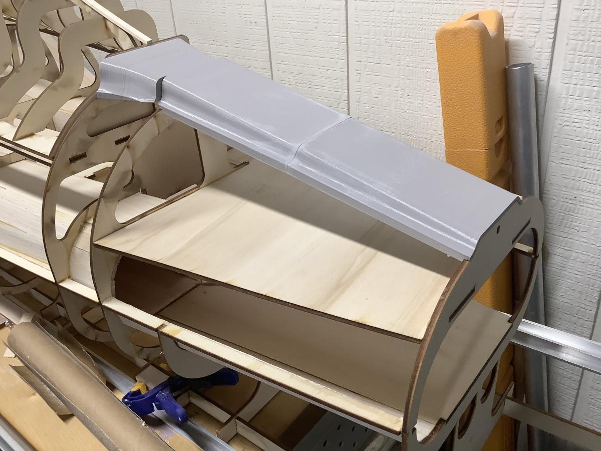

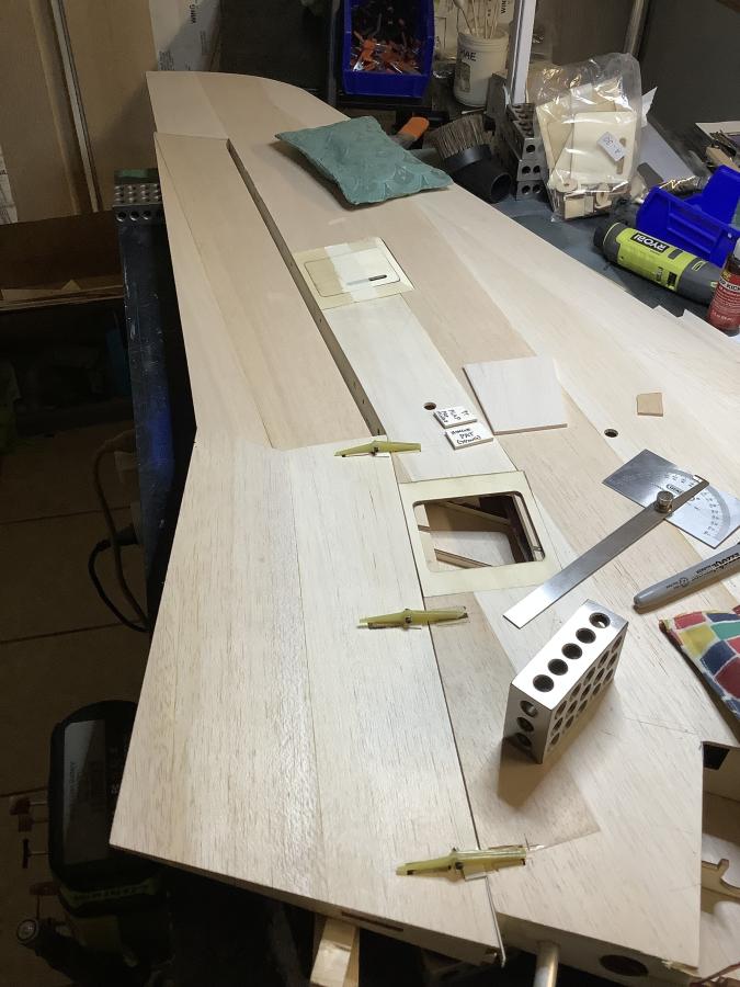

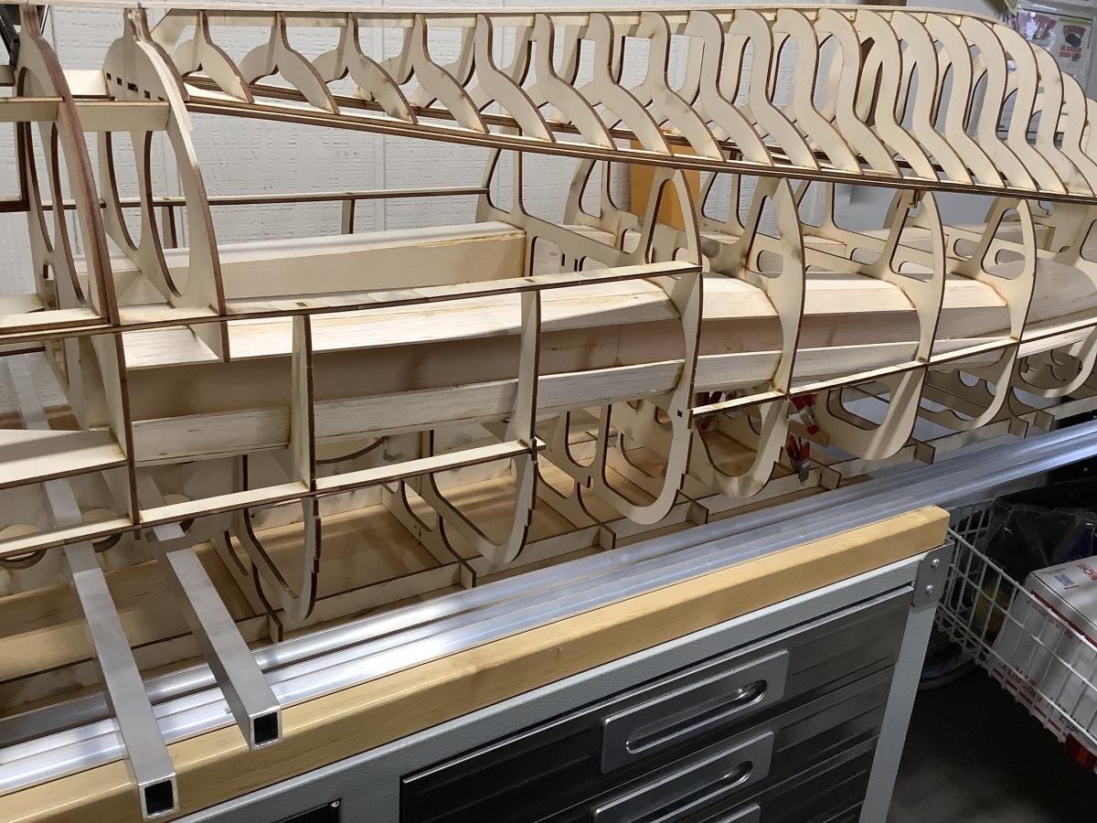

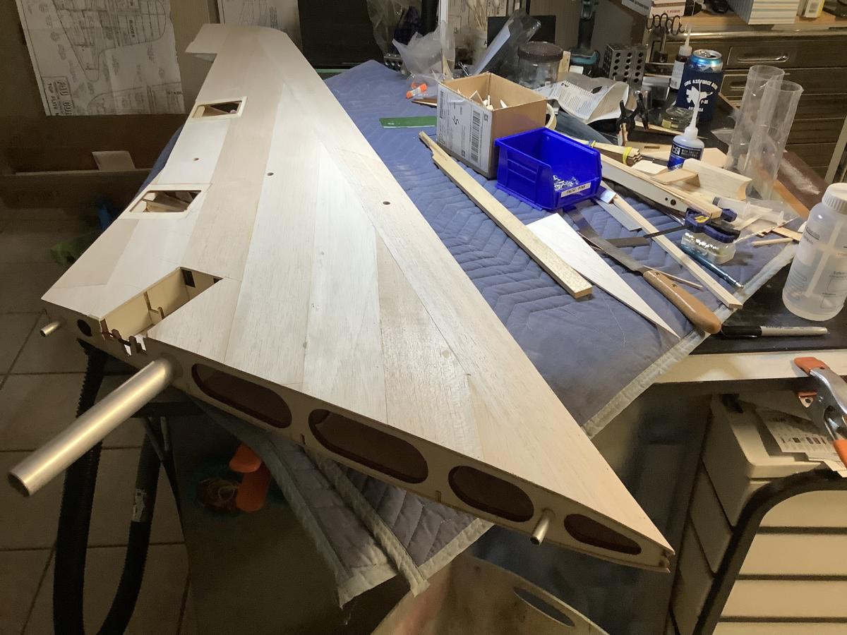

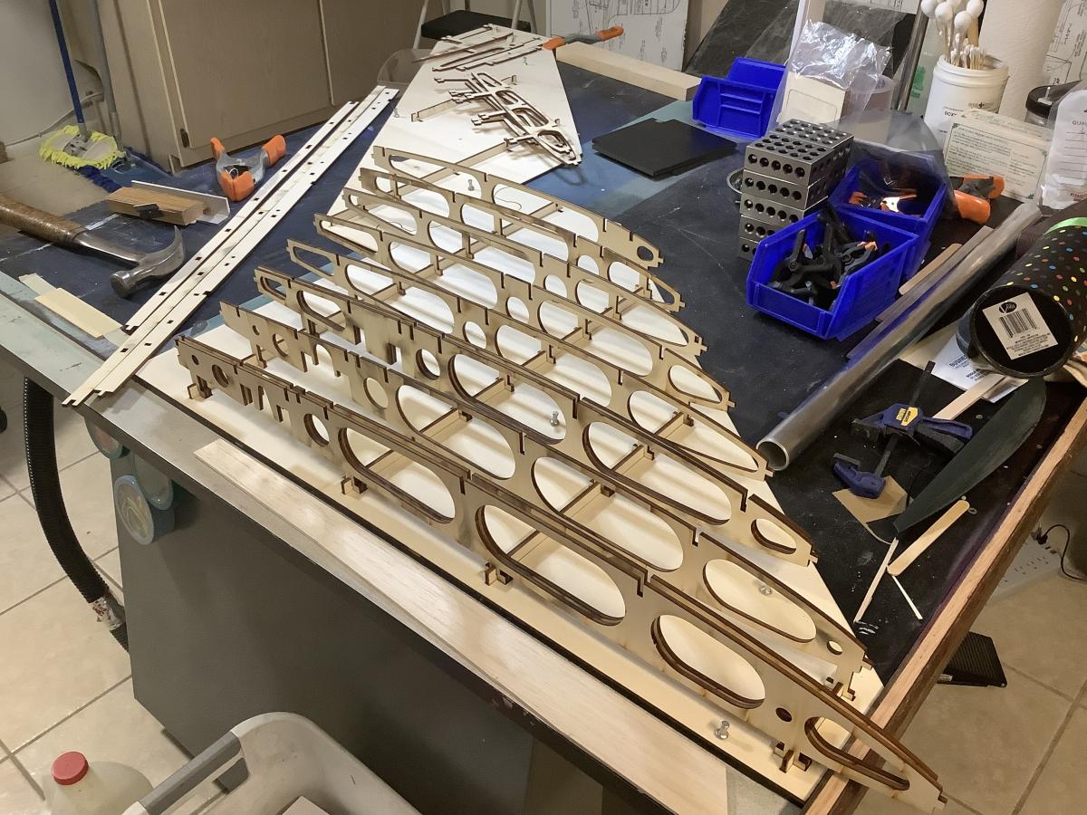

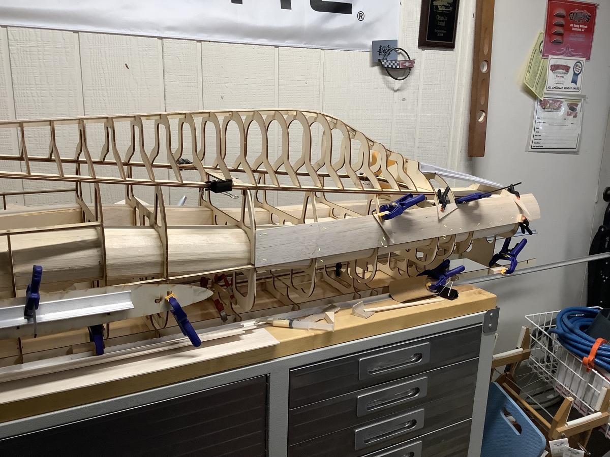

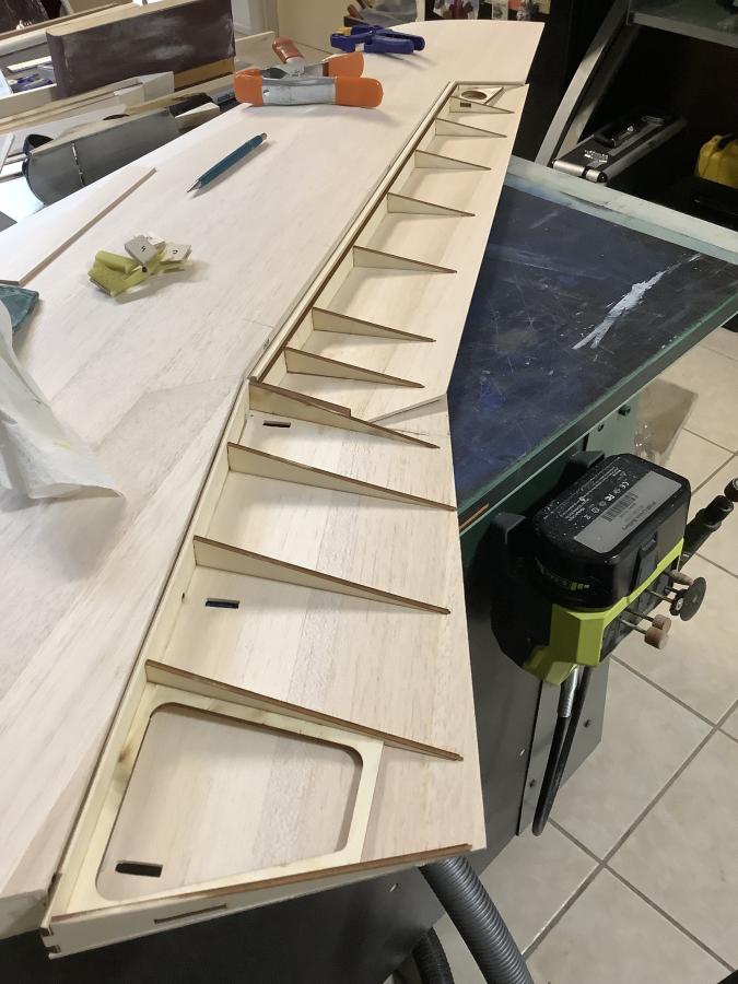

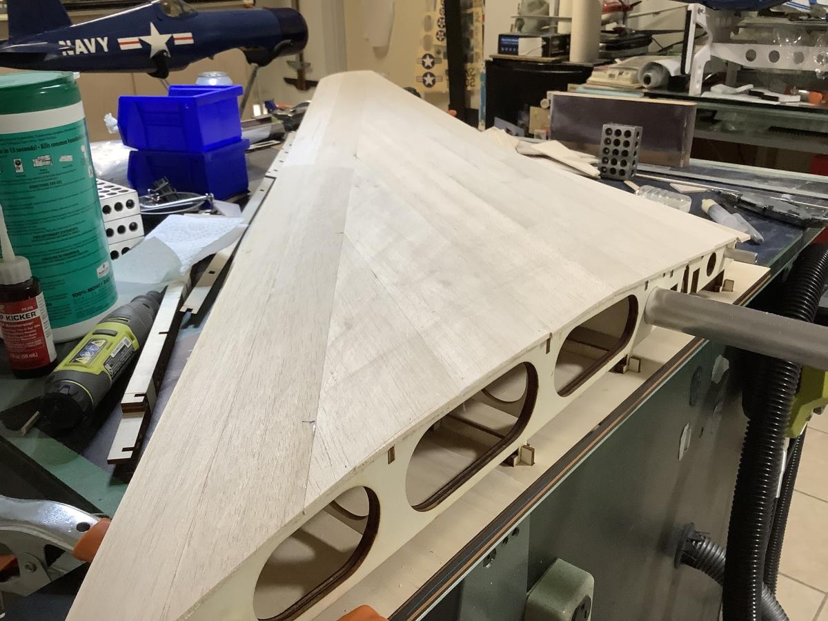

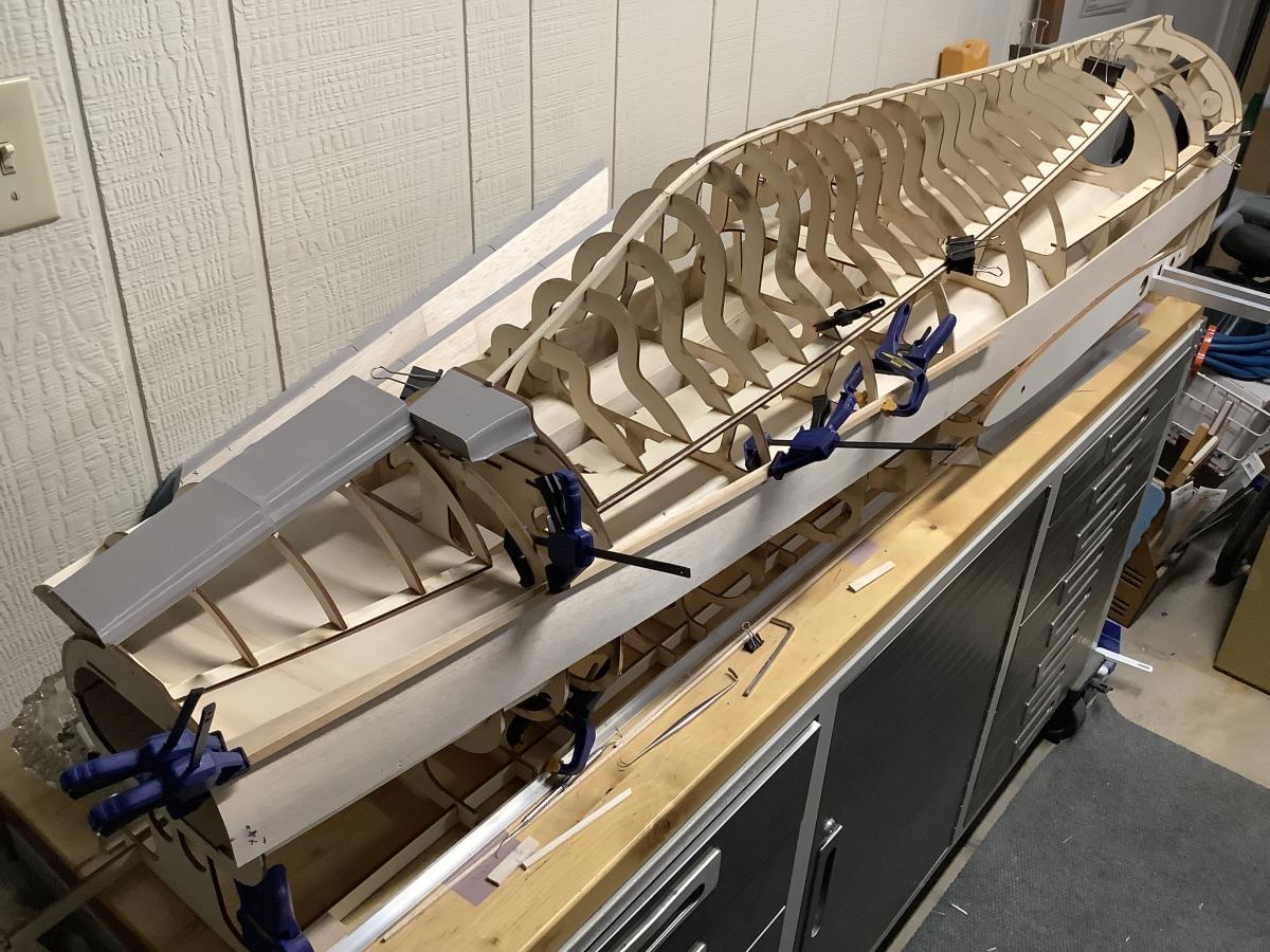

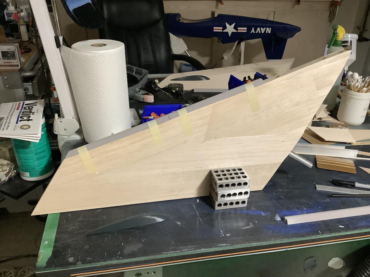

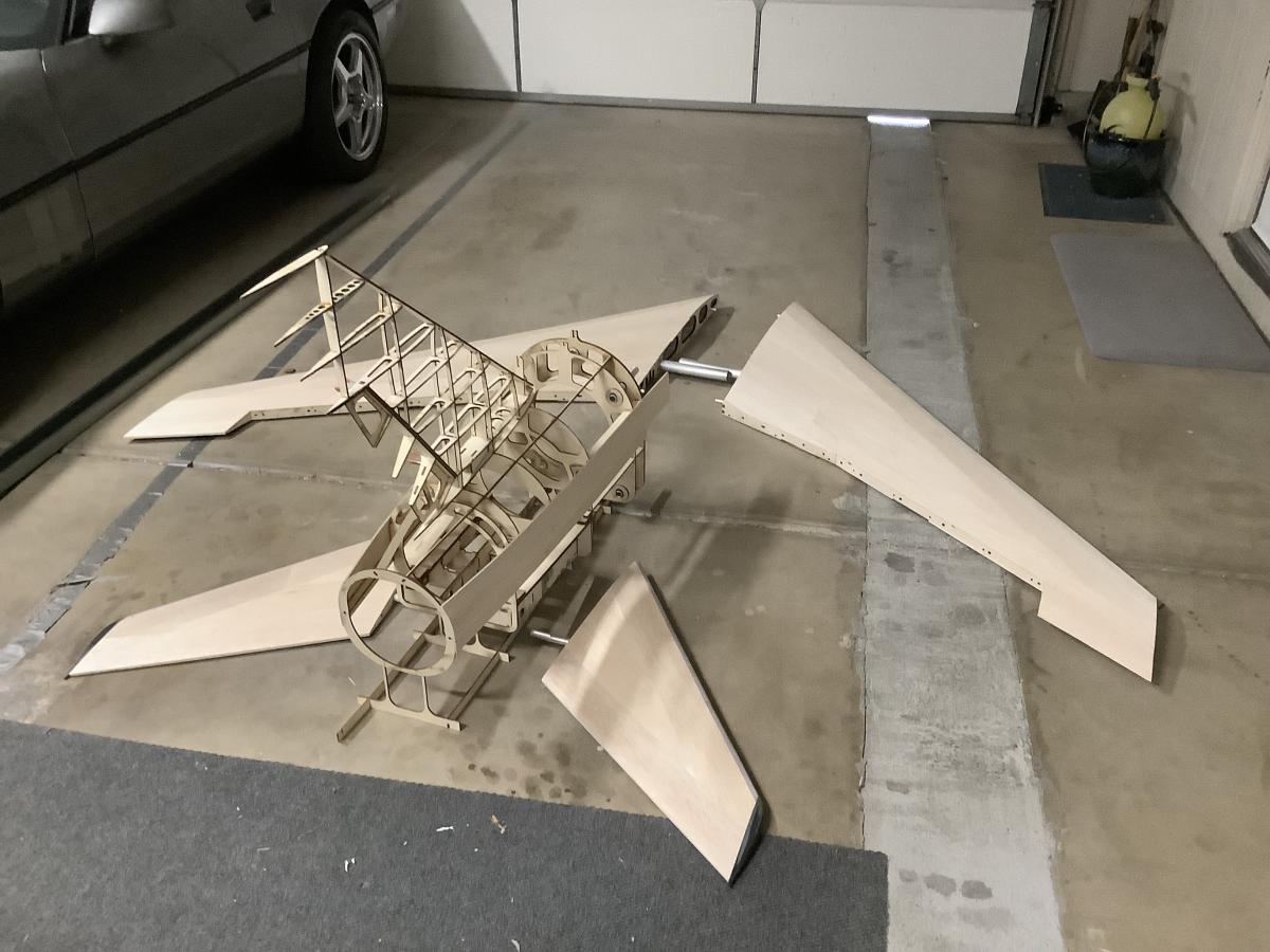

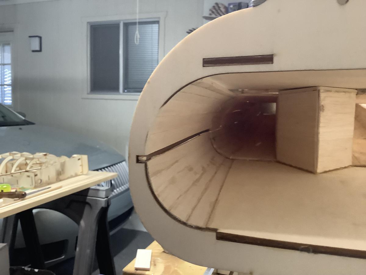

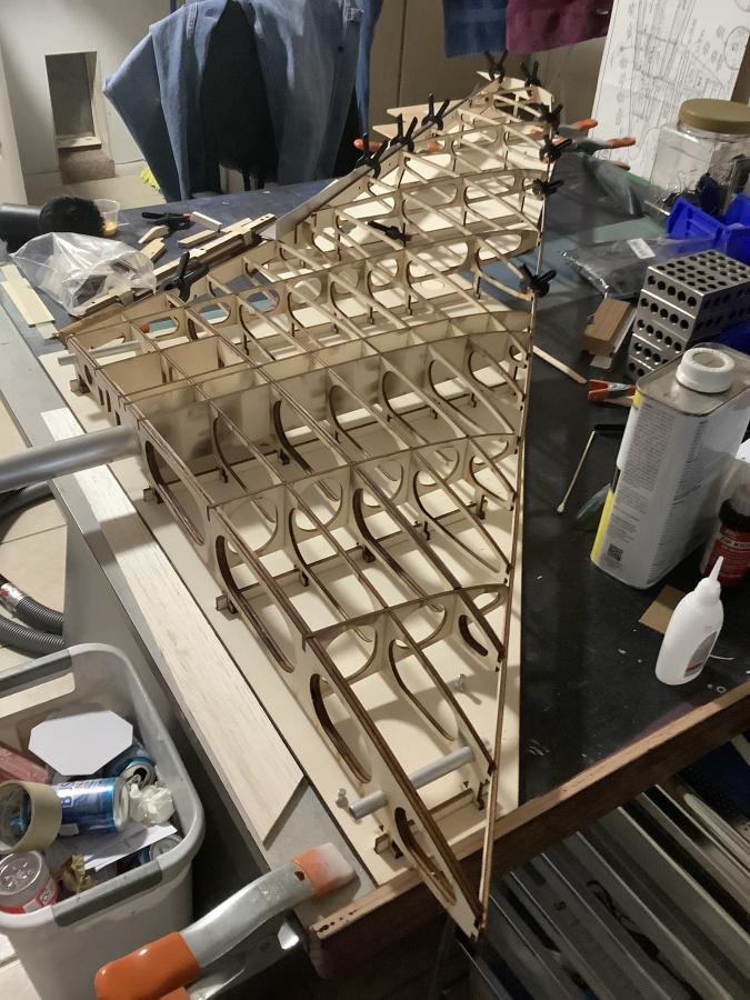

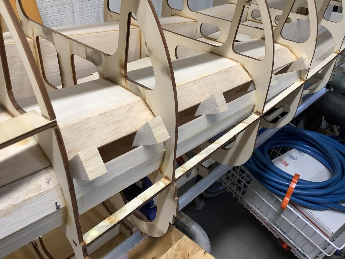

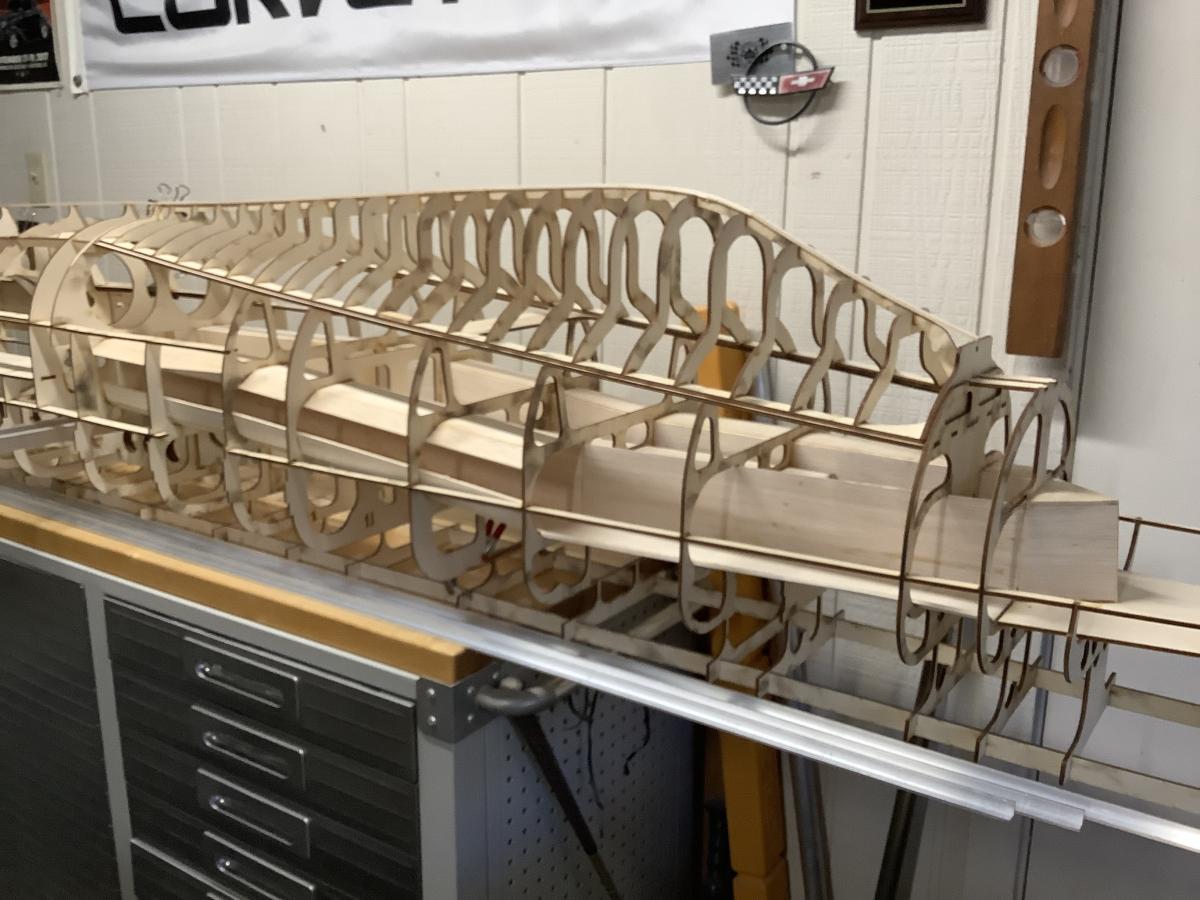

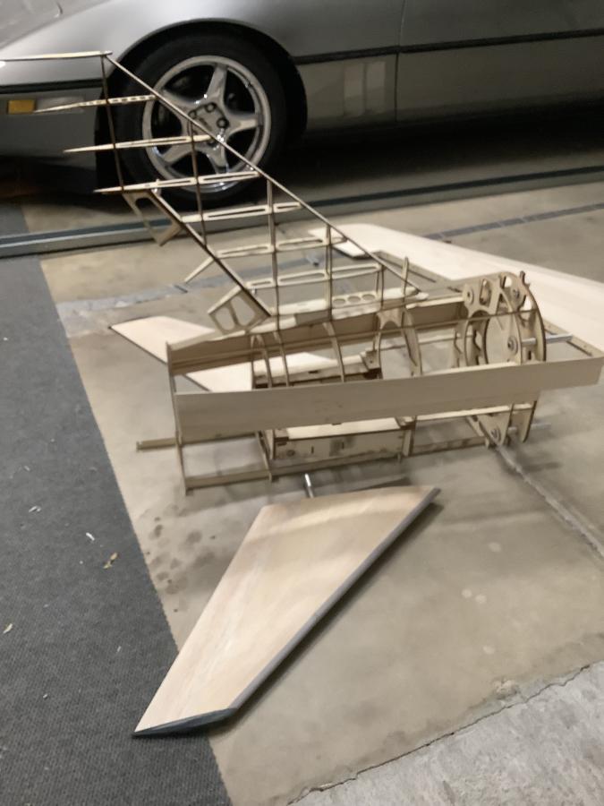

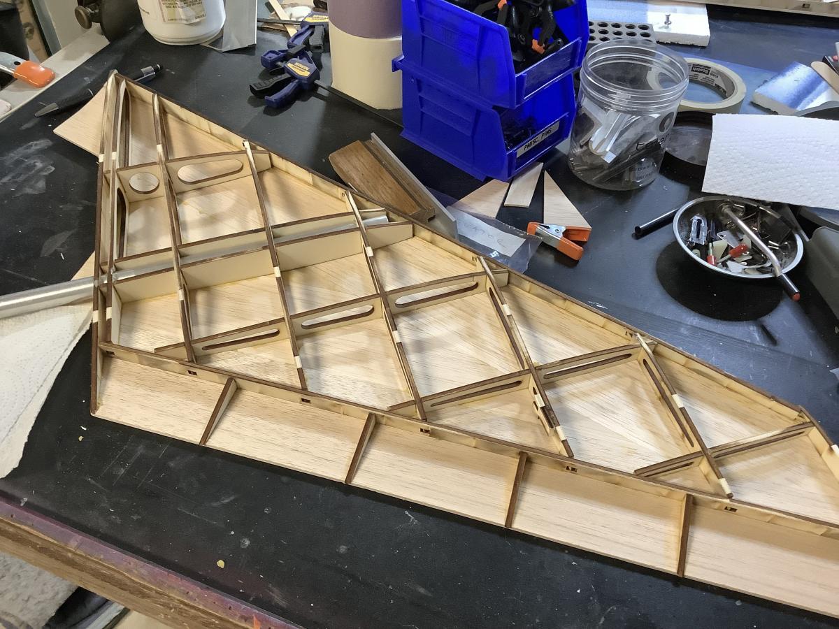

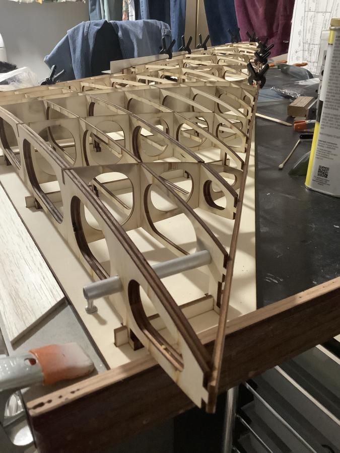

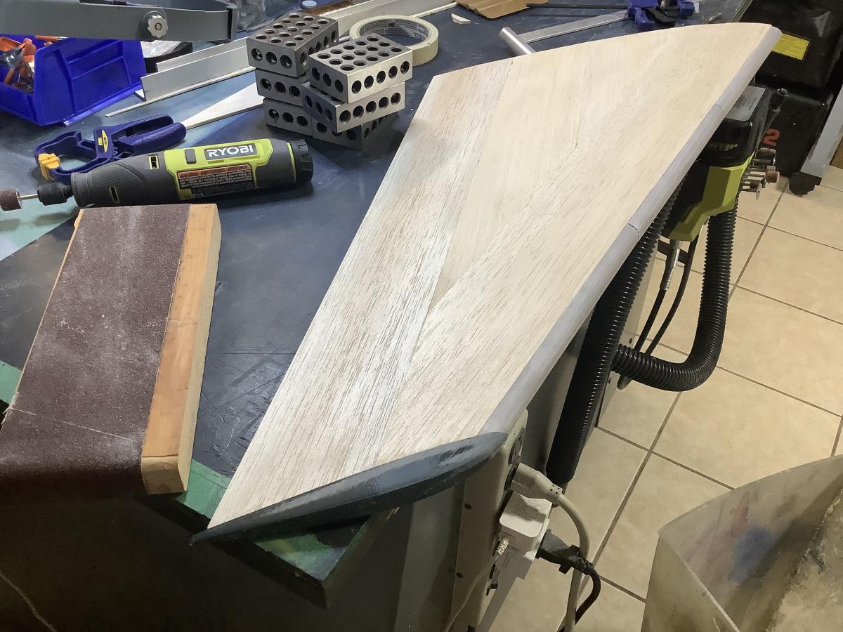

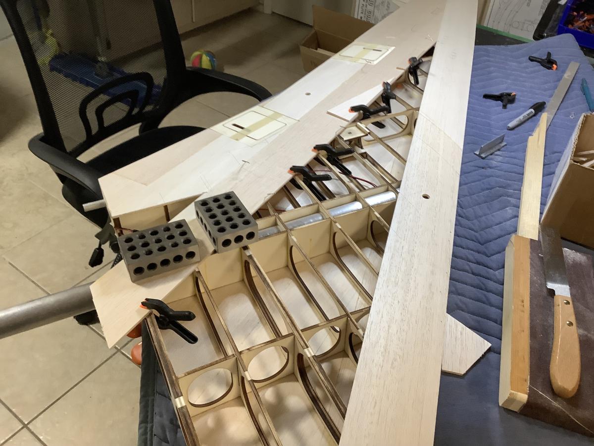

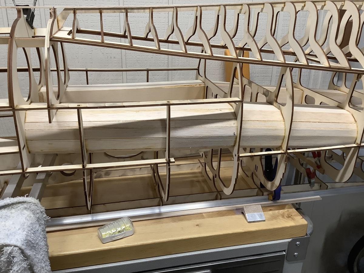

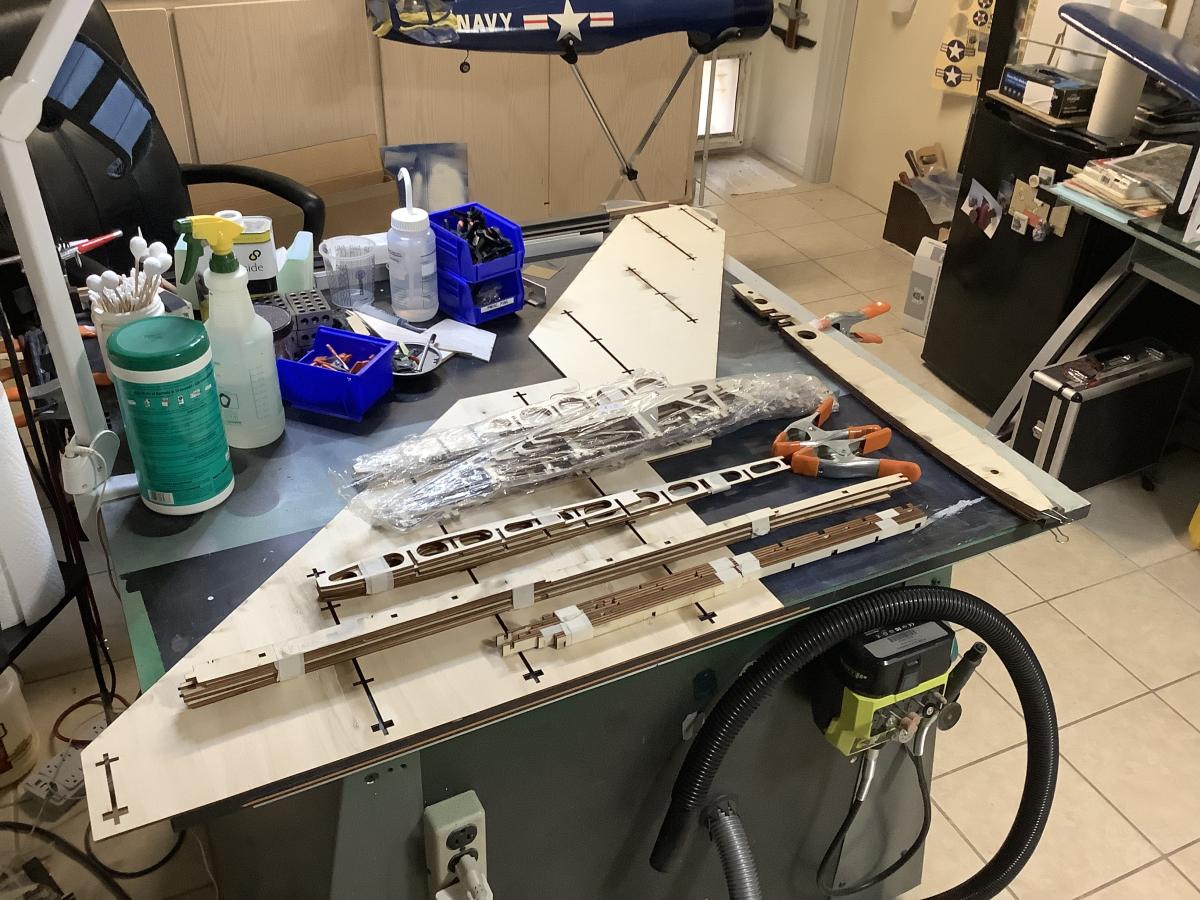

                    Much has transpired. Suffice to say my 1/6 scale version has had to take a back seat. The 1/4 scale version has taken over every available space in both the ‘Lab’ and the garage. Wings, elevators, and flaps are completely sheeted and hinged. The fuselage has starter sheets on both sides, after the the balsa intake ducts were installed. Those 2 structures are a huge part of the design process and bring everything to a straight line in the jig. AZ heat has slowed down that progress because it’s too big to fit in ‘The Lab’.
                    i did purchase the Vasyfan 120mm and Hacker motor for my smaller airframe and have begun the fabrication of the transition duct from the intake wall into the 120mm fan. All acrylic/ plexiglass.templates are cut and fitted, so machining is coming soon.
                    but, here’s a few photos of the giant 1/4 scale bird, which measures 12’ nose to tail.
