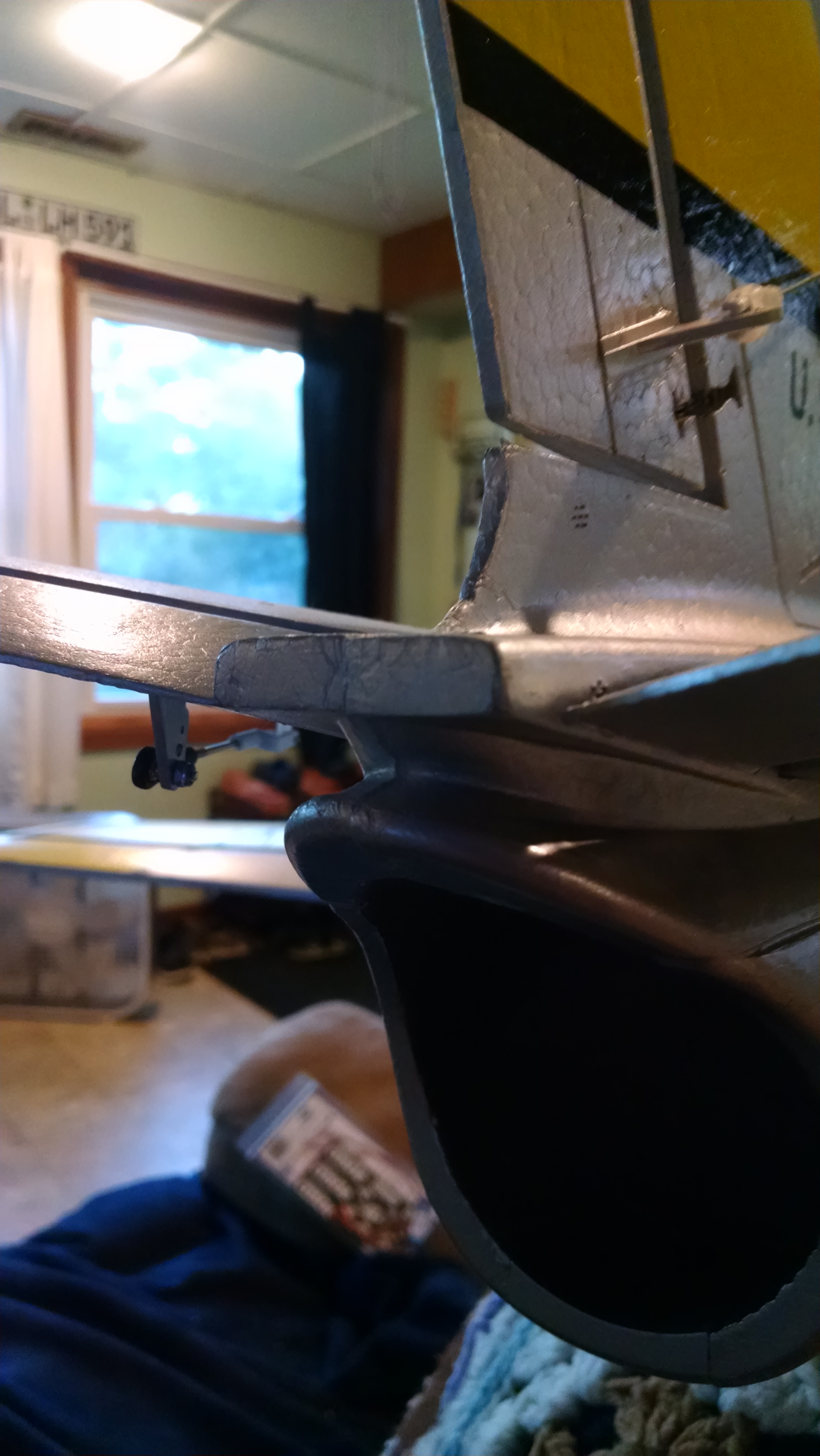

                          Finalizing all my surfaces for a maiden soon. I noticed my left elevator stab does not move linear with my right. It is fine with sudden movements but a slow roll on the up or down stroke causes the left to move .5 ahead of the right. Is this going to matter causing a roll on the tail? I also noticed the ball links are very fragile and dont appear to allow the rod to pass through the link. So I had to set subtrims on my taranis to offset the neutral location setup from the factory. I just want to make sure I get everything right.
                          Also where is everyone setting their elevators at? In between there is a small rectangle piece of foam. Are you lining them up to the top lip middle of bottom of this centering piece.

                            Here is where mine is

                              I have 20mm for up travel on the elevator and 15mm for down travel. Will this be enough. It seems to be in spec for low rates but high rates seems crazy for elevator. I set 20% expo on elevator.

                                Here is my elevator trim. Your throw seems about right, but I would try to adjust the travel and make it symmetrical if possible.

                                  yeah I think its a delay response with the servos them selves. They are set on the sample spline same thread for ball nut. But one is visibly slower or delayed.

                                    As long as it is a barely noticeable delay you will be fine. You're not really going to get any noticeable rolling moment generated from the tail. But, if it is a significant difference in servo speed, you might consider replacing the servo. The last thing you want is a servo on your elevator locking up or dying mid-flight.
                                        I would recommend more expo for elevator to start out.
