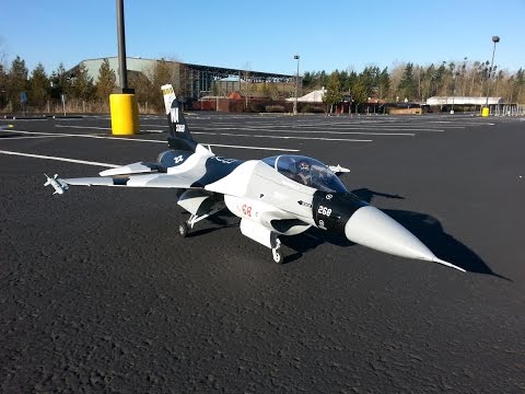

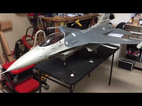

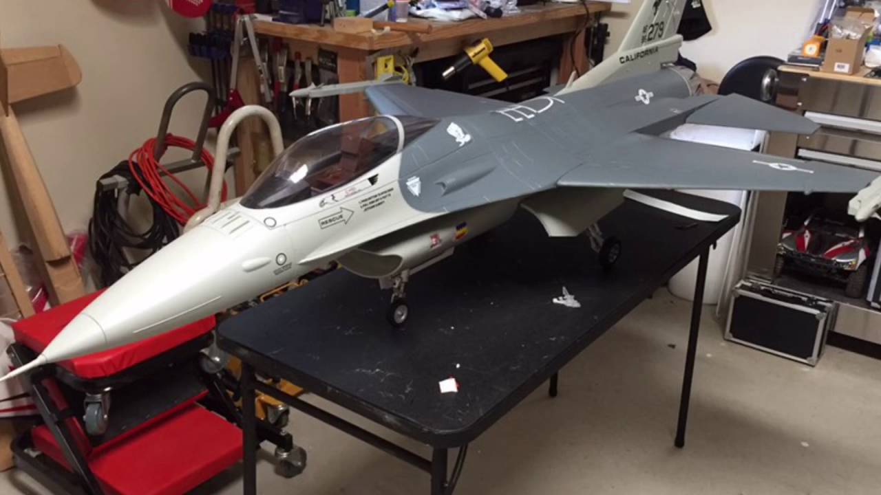

                                      I went ahead and bought a replacement front nose gear unit so I could fly this sucker....
                                      Stuck it in the other day so I can take it to jet jam.... But I didn't want to take it in the blaaaaaa grey. Well I already have a tan aggressor (tams) and a blue aggressor (90mm FW), and the Israeli camo I love (FW 70mm)....so I decided to do the arctic.
                                      Painted it, weathered it a bit and decals in about four hours.....
                                      Didn't come out to bad
                                        #39
                                        Nice! I love the Arctic scheme on the F-16. Just finished flying my 70mm version. Did you fly it yet?
