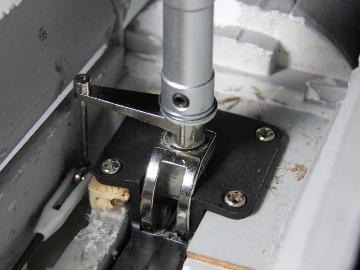

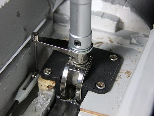

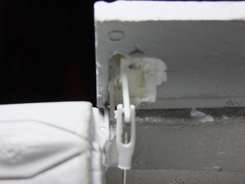

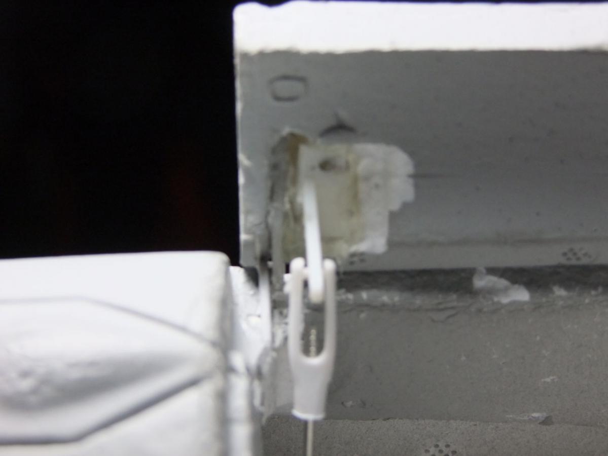

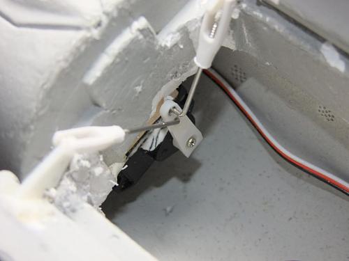

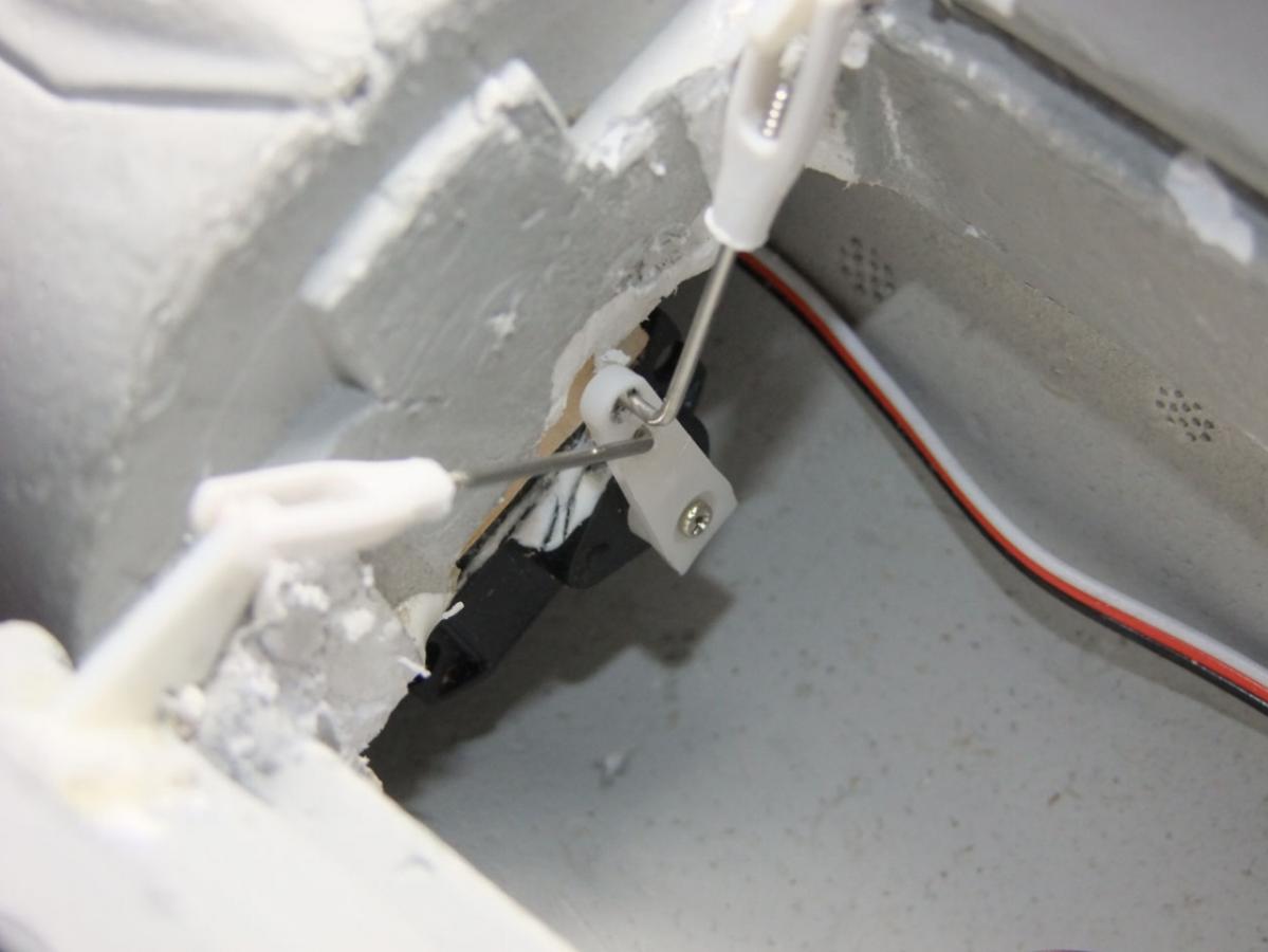

        After spending way too much time on my nose gear, it's finally complete. I moved the gear door servo down and forward to give more room for the nose gear itself. I also moved the clevises forward as well (2nd pic is blurry, sorry). This allowed me to fit larger wheels and raise the nose gear a little bit, all while ensuring the gear doors will still close. All of this was to help increase the AoA on the ground and allow for smoother takeoffs so it doesn't pop off the ground. We'll see if this was worth the effort the next time I fly. I must have cycled the gear 1,000 times to make sure the gear doors close without the servo buzzing.

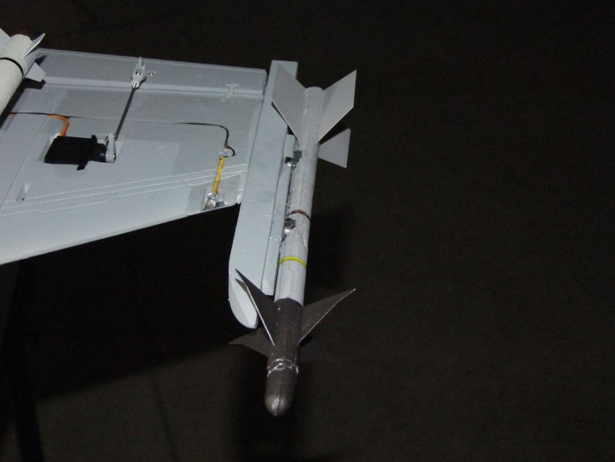

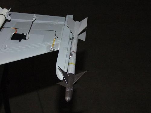

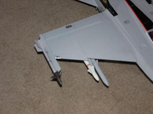

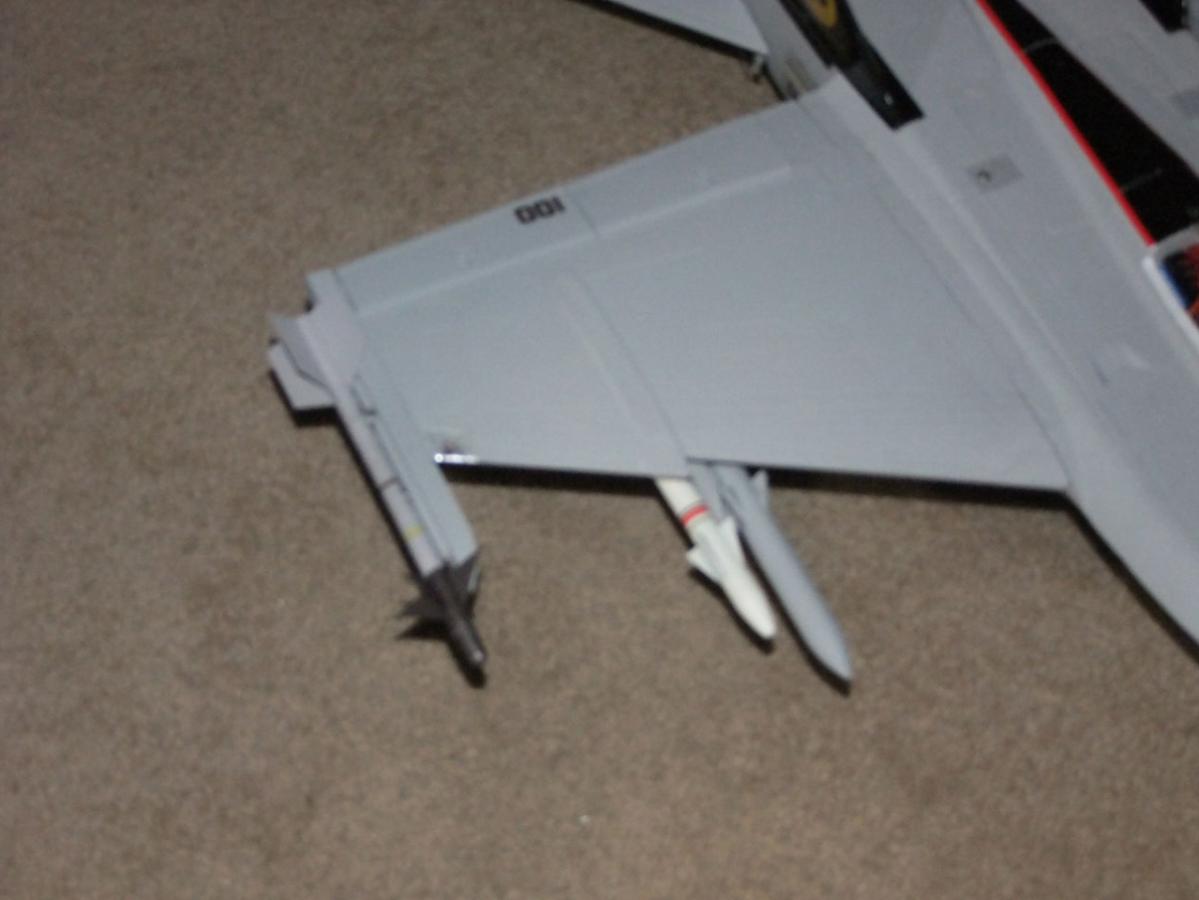

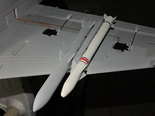

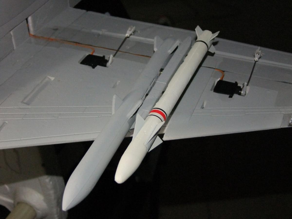

        Something else I did too was fit the AIM-9 missiles from my defunct F-14 to the wingtip rails. I then fitted the two missiles that come with the plane with magnets and attached them to the hardpoints under the wing. I really like the way it turned out and am looking forward to seeing what it looks like in flight. I was going to use the AIM-120 AMRAAM missiles that also came with the F-14 but they were just too big. I looked at pictures of an F/A-18E online with missiles and even the ones that come with the kit are too large for scale, but the AIM-120s are just cartoonish too big.

          Nice work Mike! I'm anxious to hear how your first rotation goes post nose gear mod. Armament looks great.

            Thanks Aros! I look at the missiles and I don't know if I like them. I may feel differently once I get it up in the air and see what it looks like in a flyby. I'll also report back about my takeoffs; I hope this helps. My V1 took off nice and smooth once I raised the nose gear pretty high, but I had to sacrifice the gear doors to do it. Was hoping to keep the doors this time. ;)

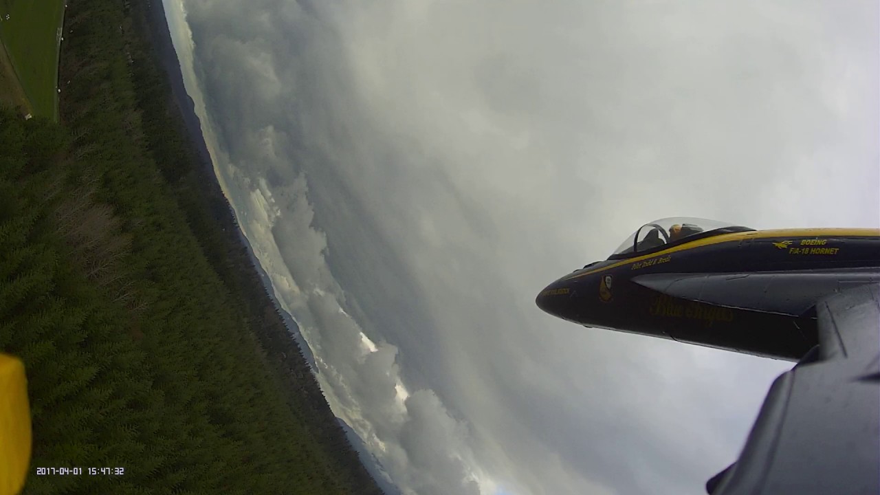

              Took my Blue Angel out for a couple quick sorties before the rain came back in. First time I tried out my flaperons for landing. Worked great. Always love to fly this jet any chance I get.

                                          Back to the F/A-18E. Flew it for the first time since installing the new missiles and raising the nose gear. Still pops off the ground, even with the aggressive AoA, but not as bad as it used to. So I'm just going to roll with it as it flies great and still comes off the runway no problem, even if it's not pretty. And I'm hoping for some longer flight times now that I properly calibrated my throttle.... was wondering why I was killing a 5000 mAh battery in a 4-minute flight.
