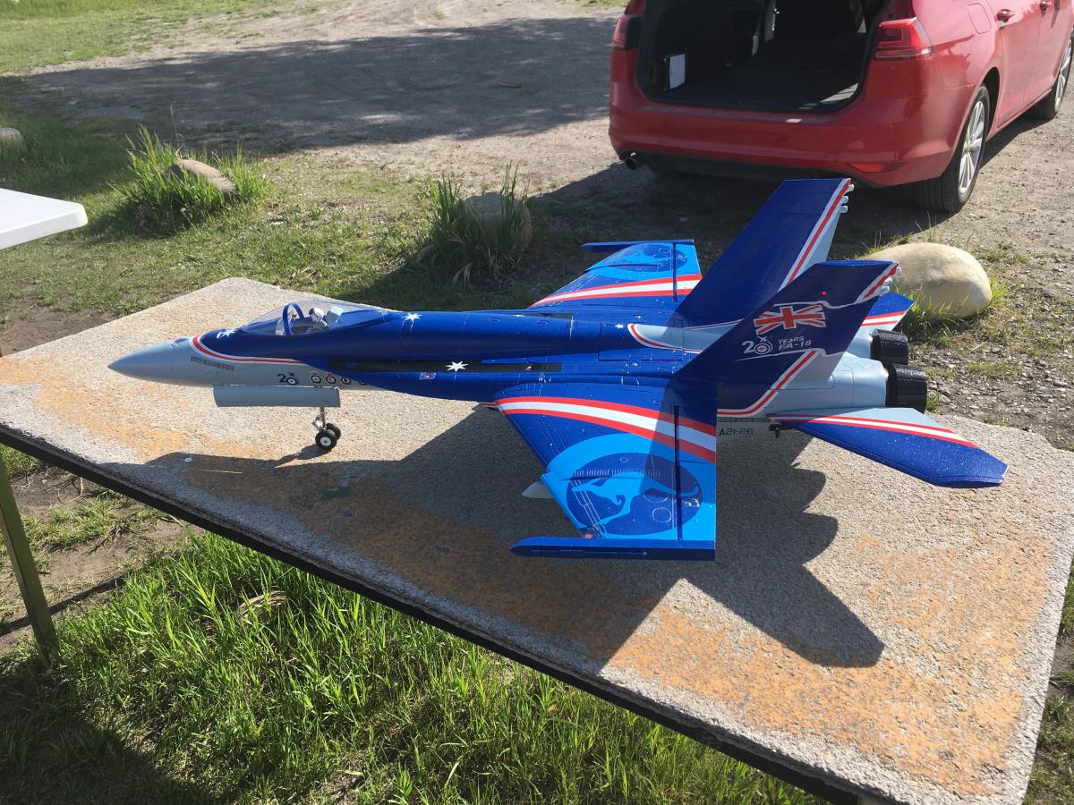

                        No flight video yet. First video attempt failed.

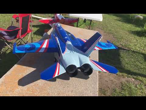

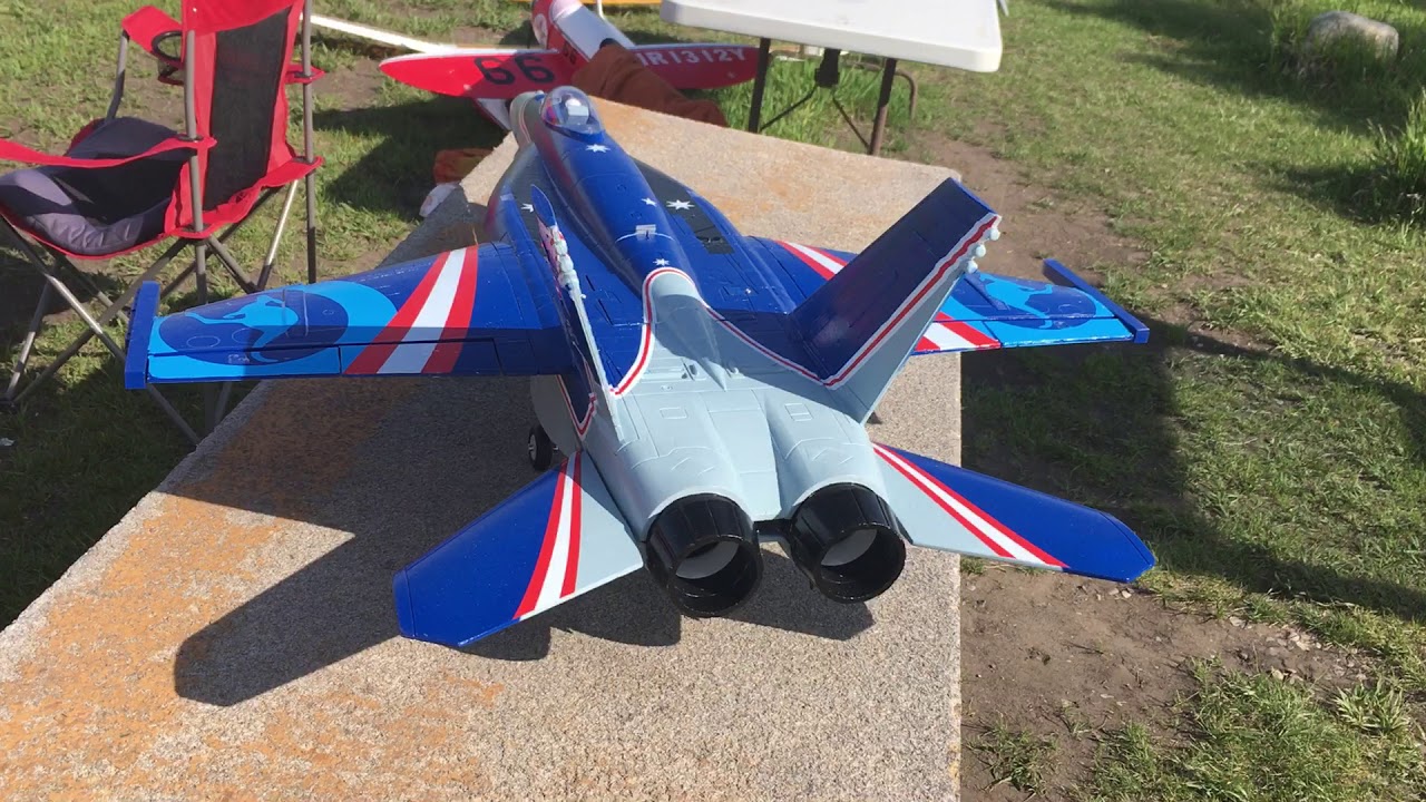

                            Finally got that flight video …………………………..

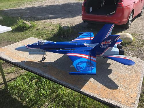

                                  I just want to add a small footnote to the effect that credit goes to Motion RC for indulging me in the acquisition of this model. There were only a handful left and they got me one. It was even a V2.
