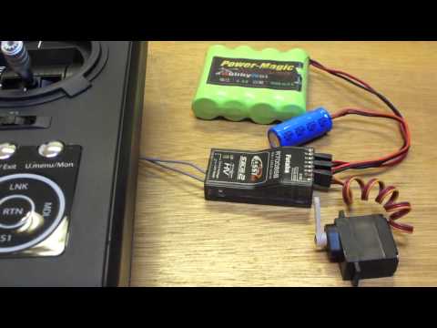

      I think a voltage protector is a much simpler solution if you are just looking to keep a constant voltage level. It is basically a capacitor that plugs in to the receiver.
      I have one installed on my T-28 and it might had actually helped keep control of the plane when the ECS recently failed.

          Evo, thanks for the pointer to the capacitor backup.I checked the HK website and this model is out of stock. I love the idea. So, I'll just DIY one... get a some 3300uF 16v capacitors off Amazon or eBay and solder servo connectors to them. For my 262, I'm going to plug in the Scorpion Battery Guard that I'd picked up a few weeks ago (to use on my F-86, but never actually installed it). It's a much more costly solution, compared to the capacitor, but obviously will provide bus voltage for much longer. the Scorpion Battery Guard provides 5v output (when the RX bus voltage drops to 5v or lower) and has a 500 mah. I plugged a servo meter (on voltage setting) into my RX. My 262 RX was running at 5.6v nominal and with max draw all servos (including retracts and flaps) dropped to around 5.3v. With the battery backup installed, everything worked fine. I then disconnected the main battery and still had full control of my servos. I'm probably sweating over nothing (which is nothing new for me... LOL), but I watched my buddy auger in his Freewing 262, when he turned onto base and browned out. There is a lot of current draw when all those servos and retracts are moving while setting up to land. Here's a demo of the Scorpion Battery Backup: https://youtu.be/vzy1aPTDeEY

                I'm going to run the Scorpion Battery Backup on my Schwalbe for it's maiden (and probably subsequent flights), but I've really warmed up to Evoman's capacitor solution. I've never thought about doing that before, but it seems a near perfect solution for filtering out short-duration voltage dropouts. I've ordered a dozen 16v 3300uF capacitors and will start putting these voltage protectors on all of my planes. It's such a cheap and easy way to put a voltage filter into the RX power bus..
