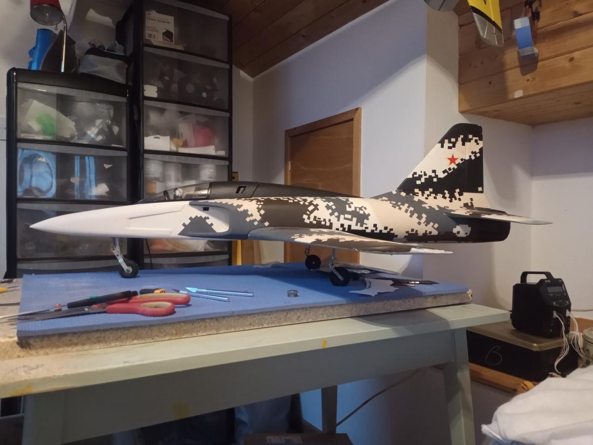

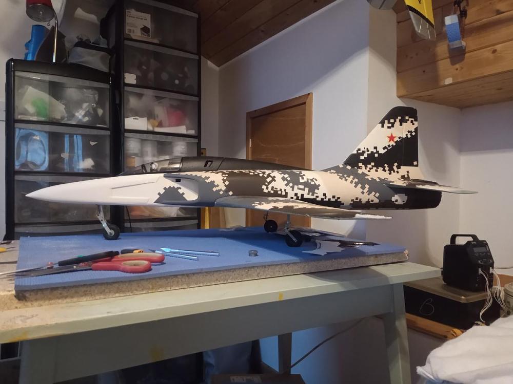

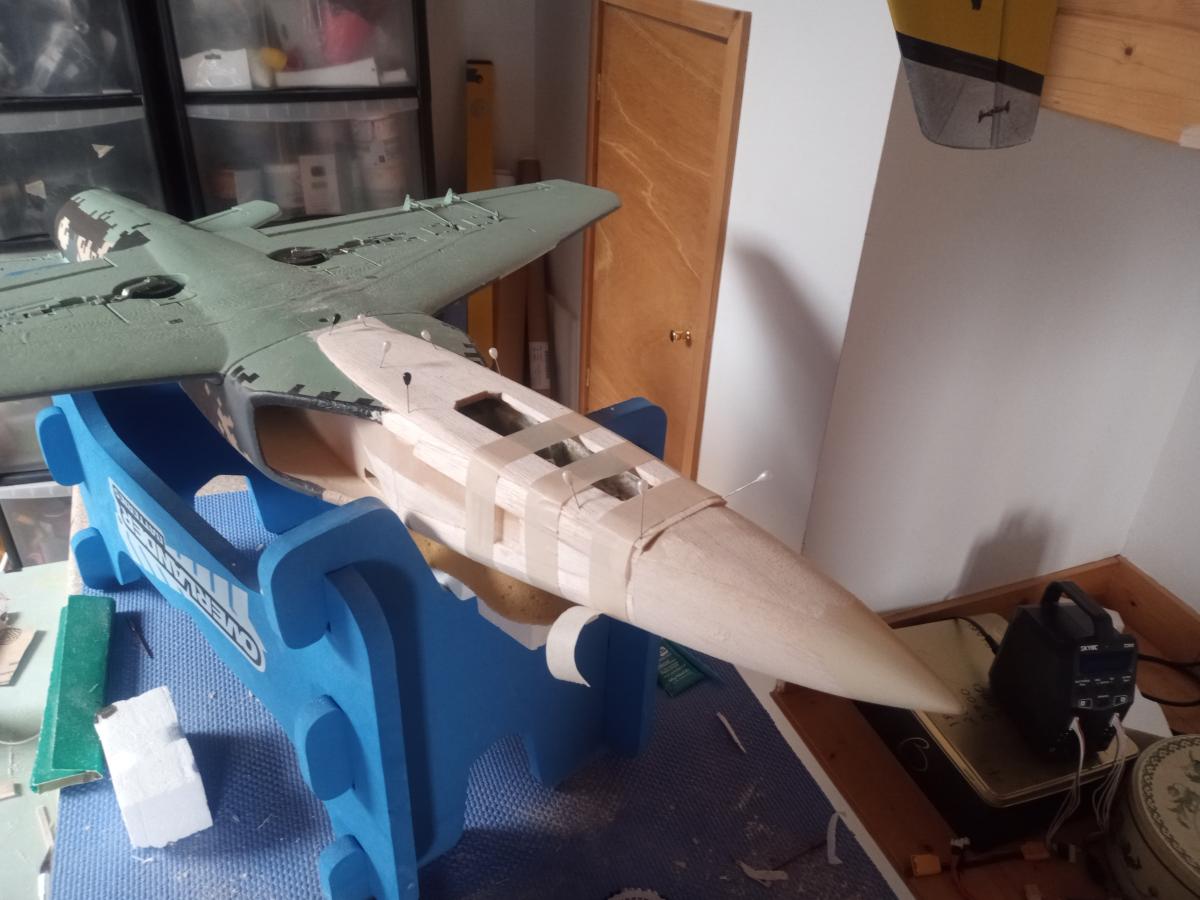

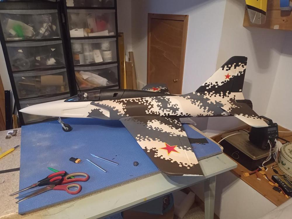

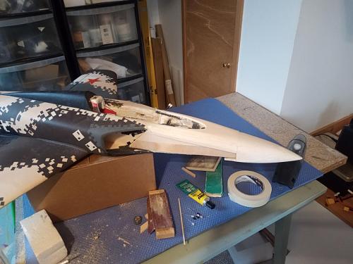

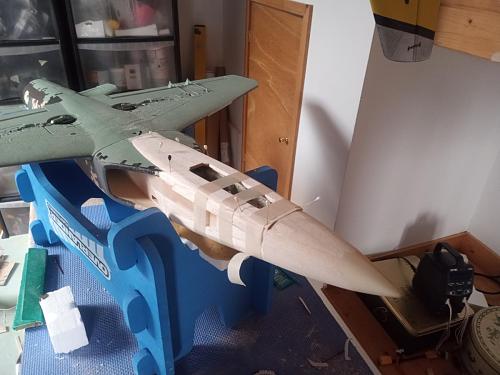

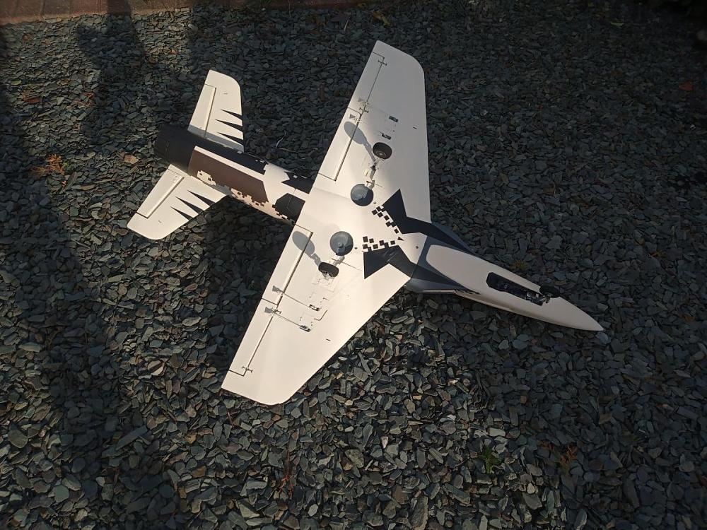

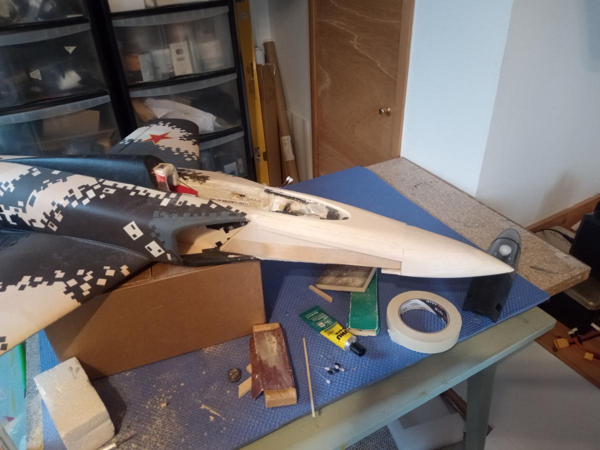

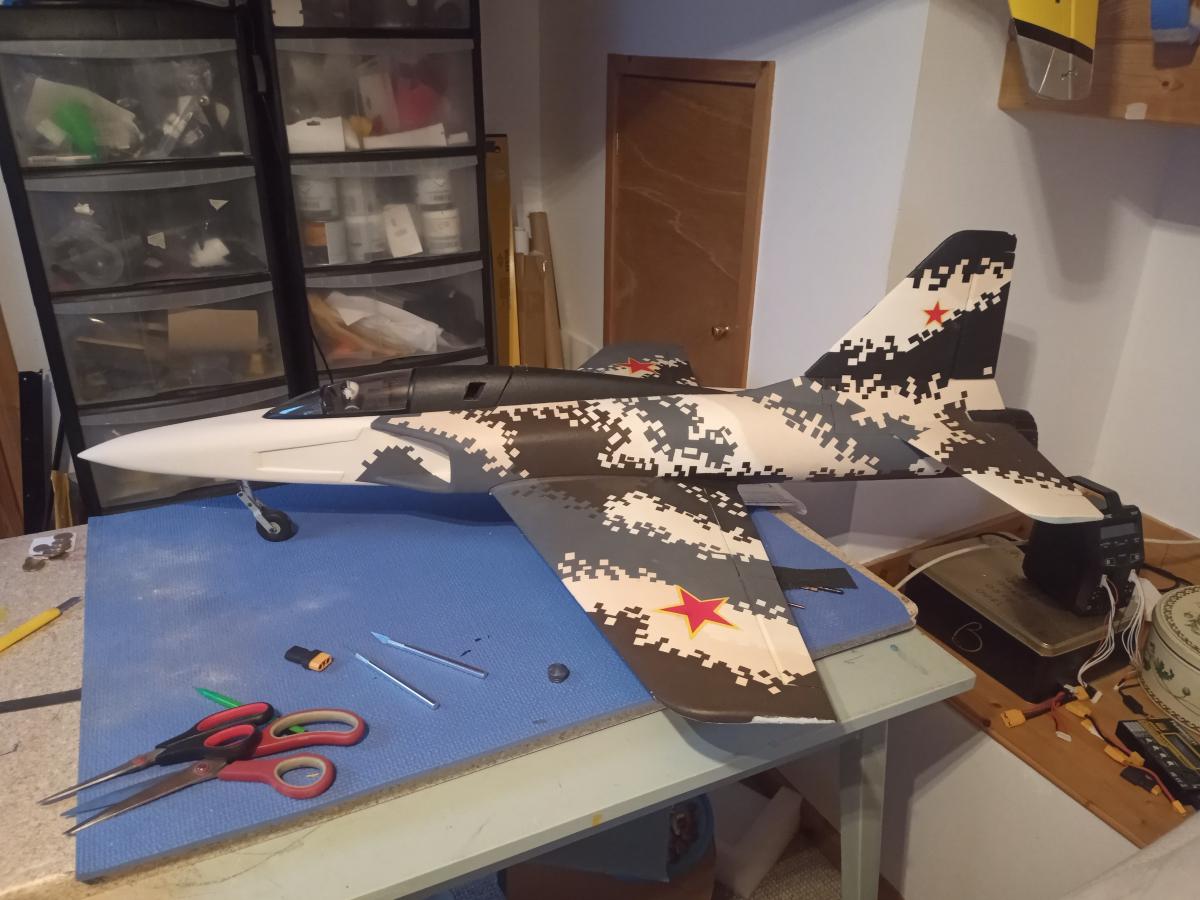

    One of the weak spots of the Rebel is the thin and fragile nose section so I finally decided to upgrade mine with a balsa and light ply glove to avoid the nose wrinkles. I cut off the tip of the original nose which had 70gm of lead weight in it , ended up adding back 30gm weight plus the balsa and light ply to add15gms overall and a bit of length to the nose. Just waiting for the F5n missiles and rails to complete the picture!!!
    Freewing Rebel 900mm span 20.7dm2 Skywalker 80amp esc 4no TG9e, 3x9gms HXT900. cg95mm from LE.
    70 flights no flap/elevator mix. Upgraded to fms 3060 1900kv 70mm 6s edf inrunner, 327 gms 2.5 to 2.7kg thrust 2200mah 6s 50c battery 360gms gives auw 1775gms wl 86gms/dm2 Static thrust 1.5 to 1. super smooth and quiet. My original fms 70mm 4s 12 blade in-runner fan gave 1.6kg thrust. With 2200mah 4s 60c battery 1700gms wl 82gms/dm2

      That looks great!

        Very nice job with the construction and the paint! Beautifully done. 👍🏼👍🏼

          Thanks guys, the balsa and ply really stiffens up the fuselage and in my eyes the extended nose helps the look of the model and gives new life to one of the older Freewing jets

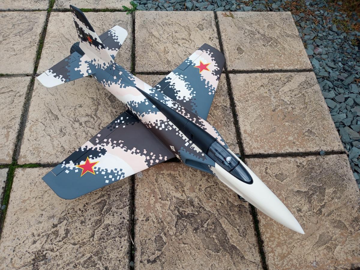

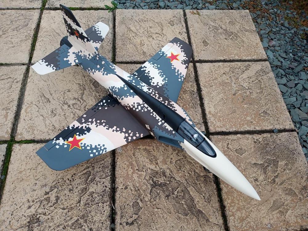

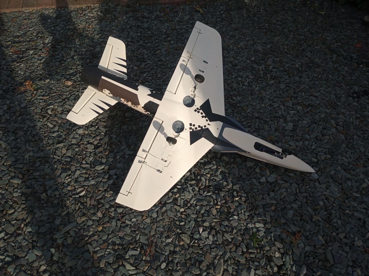

                Decided against the missiles, I will stop now

                    Looks great and I noticed you put a trailing link nose gear to avoid the bent strut from landings on grass fields. I too upgraded mine to a 6s system. I use the T1 Hawks fan and an 85 amp ztw esc and HRB3300 mah battery. I can get 6 minutes mixed flying. It's fast too.
