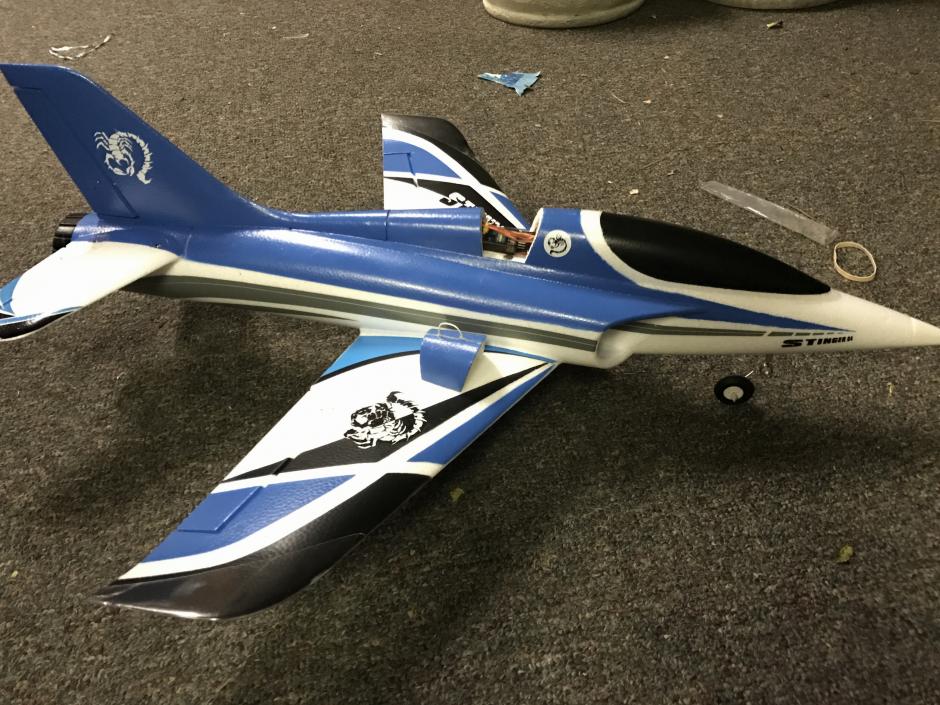

    Hey guys...I just finished assembling this plane and marked the CG at 60-70mm from the LE at the fuse. This is CG as recommended by the manual.
    Can you let me know if you are using the recommended
    mark or have you found the CG to be further back?
    Thanks in advance,
    Tim, Jefferson GA
    PS: 3s, five blade version.

      IfIHadWings, (nice! :cool:​) Is it the HP with a 4 cell 2200 mAh recommended, or the 3 cell version with the 1600 mAh recommended? I don't have the gear installed on mine, so maybe someone else can chime in on what they have found with the gear. This is what I have found with this kit as a belly lander...
      I acquired the HP version first, installed an Admiral 2200 mAh, and found 60mm CG too tail heavy for me. 70mm CG was still about 5-10 degrees (guesstimate) tail heavy with 2200 as far forward as possible, and no gear. Almost installed nose weight before maiden but didn't (I like a little nose heavy on every other plane I have). Left it that way, prayed, threw it on maiden, and loved the way it flew! What's that about having a little faith :angel:​? Has been a blast to fly ever since.
      Picked up an SD standard kit (3s) from MRC, a couple drops of glue, nose fixed - slightly bent (just like mine) :p​. Installed a 3cell 1600 mAh recommended, and at 70 mm CG tried to repeat the same angle as my HP version, 5-10 degrees tail heavy. Added 7 g of nose weight, came out more like 20 degrees tail heavy - deal breaker for me. Decided to use 1800 mAh 3 cell Admiral instead, with the 7g of weight installed, and it matched up to my HP 4 cell, closer to 5 degrees tail heavy. Flew great on maiden this way for me, and ever since. Not sure what the CG is like with gear installed. Bueller?....Bueller?

          Thanks Westsider! It is the 3s, five blade version. Simple and cheap but I'd rather not destroy it on my first flight. I have 1800s and 2200s. Like you, I believe it will need nose weight using the 1800 but the 2200 lets me move the battery back a fuzz to get it to balance just behind 70mm. Looking at a buddy's much larger Cobra swept wing (similar design to the Stinger) his CG is more near the middle of the wing along the fuse...much further back...about the end of the finger slots on this model.
          im using the gear after failing "hand toss school" and destroying my nice Freewing Panther (my first EDF). I learned a lot....most of all...use gear. Not new to RC, but an EDF noob for sure.
          I like your experience and I'll add the prayer, too!

            Maiden flight yesterday. Range check, CG check, fail safe check, taxi check complete. ~6mph wind down the runway.
            Rotated after about 60' of gradual throttle. Climbed to three mistakes high while trimming.
            It was a handful but got safely on the ground with a nice three point landing. Got some tweaking to do.
