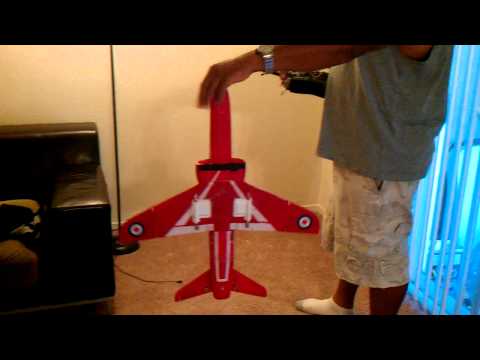

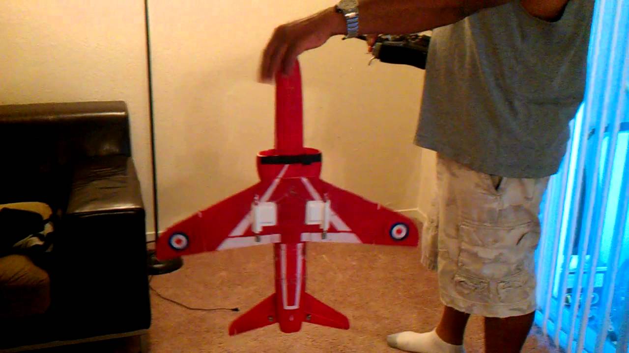

        A lot of times it is the way that you are launching the plane. If you hold it like a football it will do like a football.... and spin. The best thing to do is use an underhand toss by placing you hands just a head of the CG and releasing just above waste level. If you want to launch it over hand hold the plane with your thumb and index finger only with the other fingers underneath the plane to point it up just a little. Give it a push with the emphasis being on the last flick of your forearm. Not a football throw. with a 3s pack the plane should be launched at about 3/4 throttle. It should just go out of your hand...
        Yes there is torque rolls with edfs as I have proven in a playlist that I have showing it. But the planes only exhibit this with zero airspeed. A good push will get it into the air before it can spin....

            Thanks for the input. I did try to launch underhand with the second attempt, and the same thing happened. Interestingly, I am readying for another attempt and did a "dry run" in my garage at full throttle while holding it. It did not display any tendencies to roll while I was holding it. It acted like it would go straight and true if I were to launch it. I will try again and post again soon.
            here take a look....
