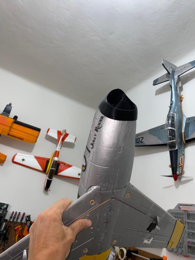

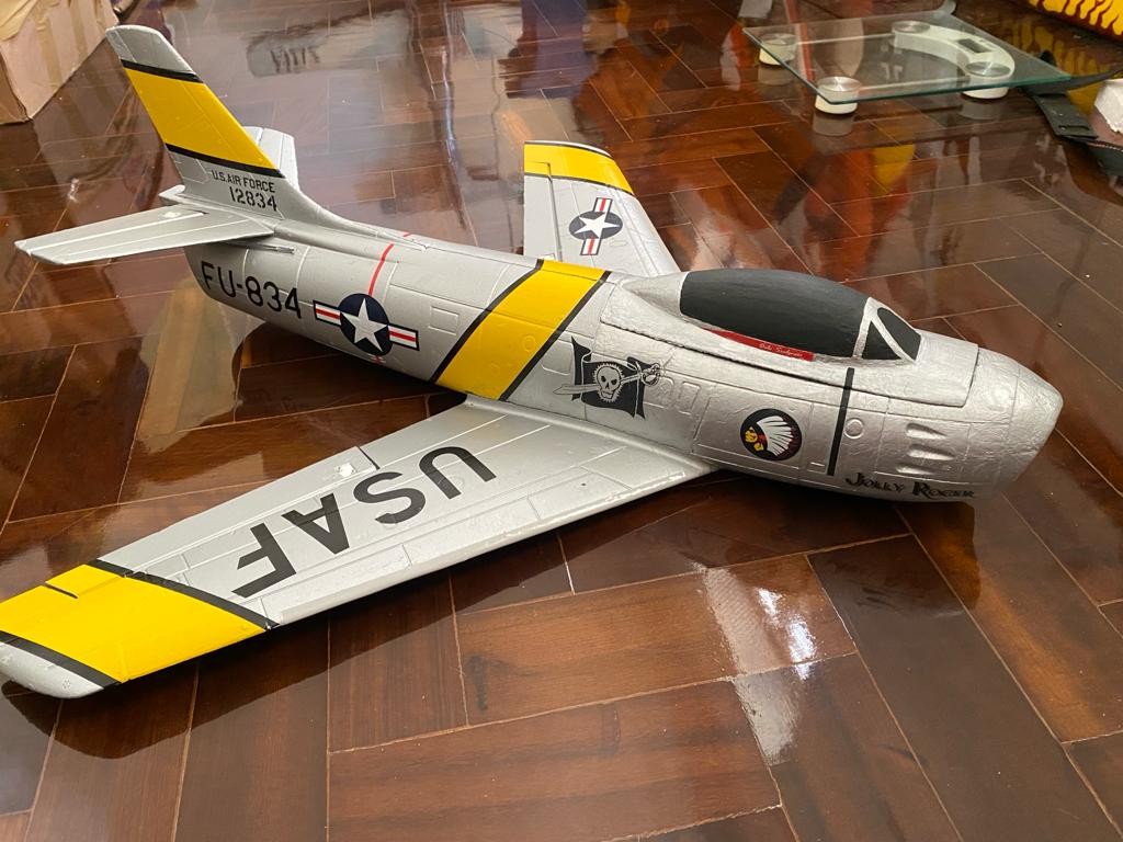

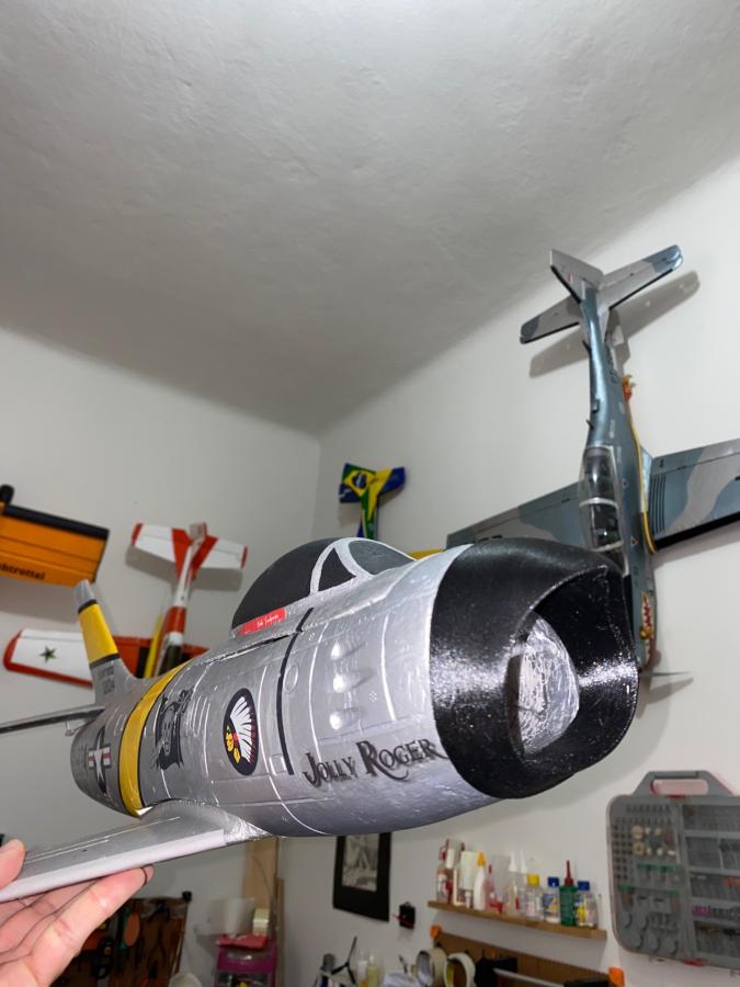

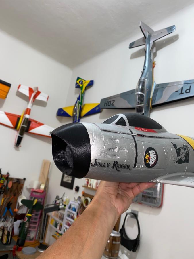

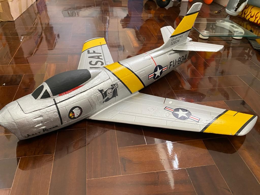

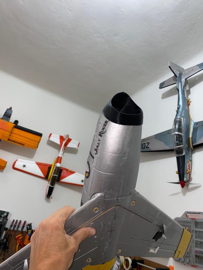

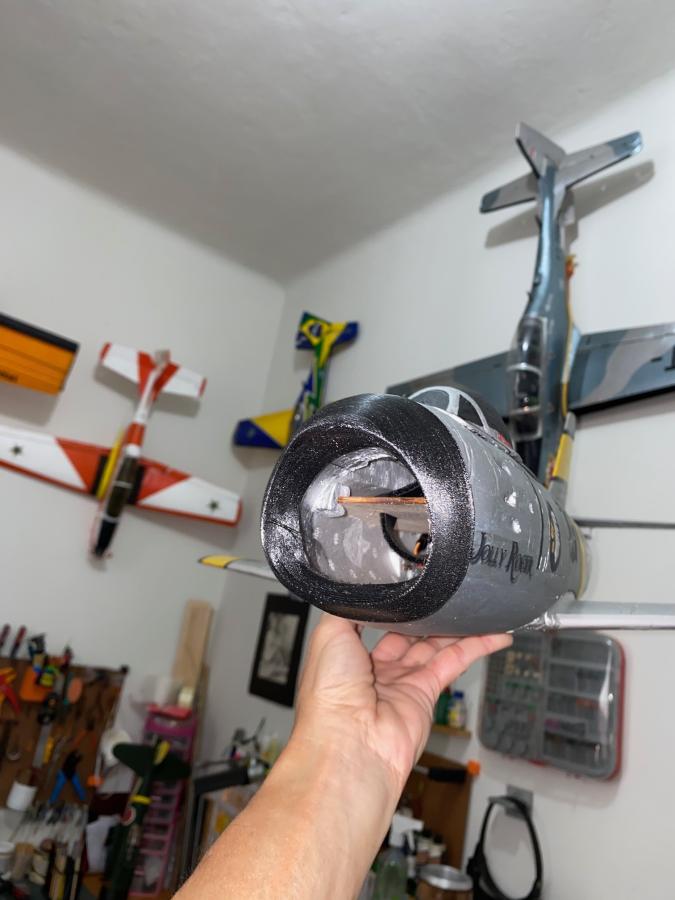

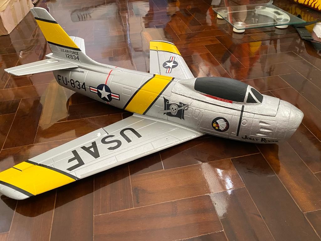

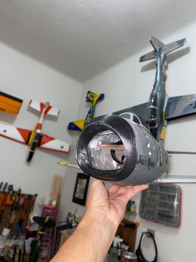

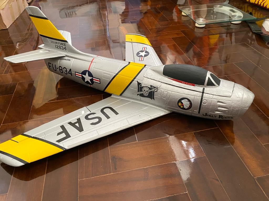

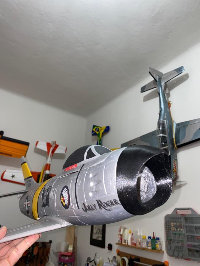

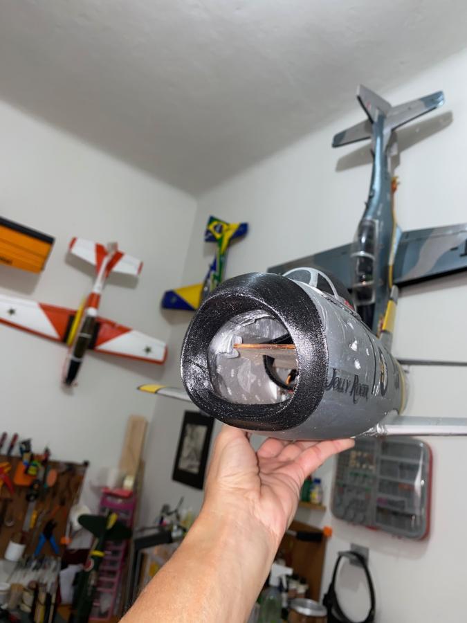

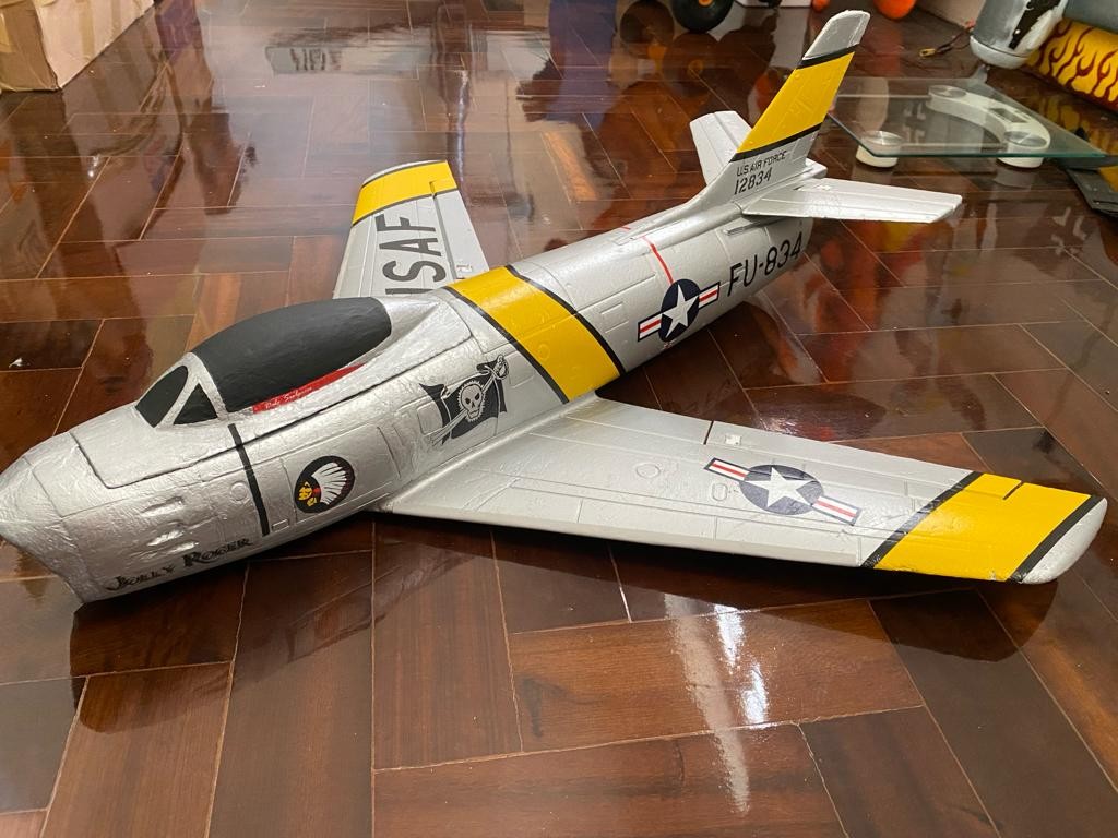

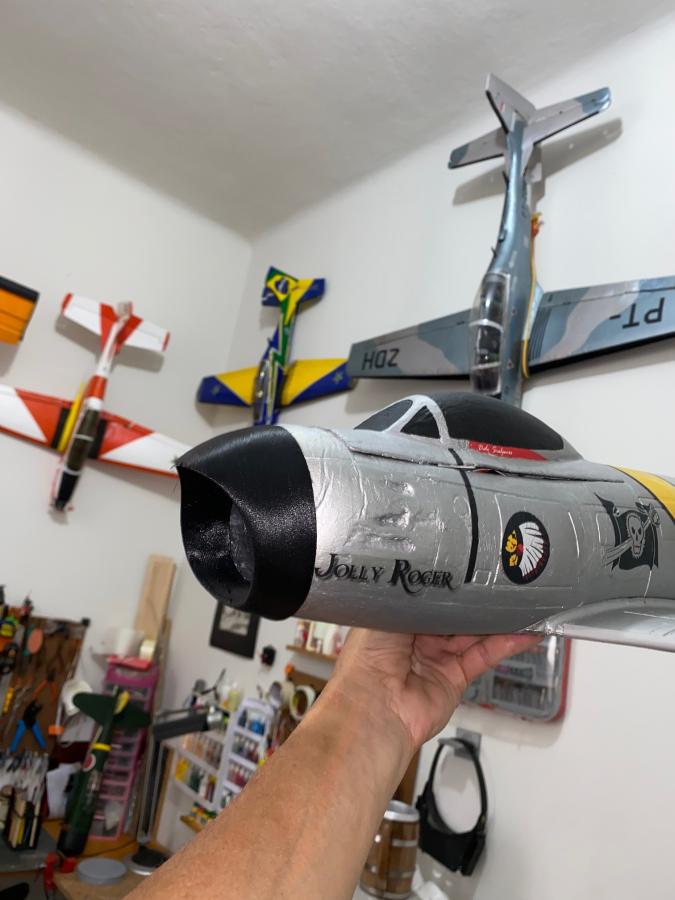

                                    Hi friends,
                                    Hi friends,
                                    Two weeks ago I was at the club and my friend tryed to fly the Freewing F86 Sabre with a 4S lipo. He hand launched with success but when turning back
                                    it went directly to the ground, could no recover.
                                    So when he saw it broke, he gave it to me, and lets bring it to life again
                                    When I started to put the parts togheter, I didn't know that hot water could make my work easier. So this was made with so much pulling and pushing.
                                    To hold the parts used some tape and pins. I applied hobby filler to smooth the smashed and then applied some primer coat to let it ready to be painted.
                                    Yesterday I went to the club and took my FreeWing F86 Sabre to maiden. I Had only an old 3s2.200mAh Lipo left, once I
                                    bought a 3S 1800Mah on AliExpress but still waiting. So, I could not resist. CG checked battery charged let's go to the maiden.
                                    I acrossed the track, where the grass is high, and I launched it with energy, holding the Sabre down, by my leg side, and
                                    with my left hand, once the right was in the stick to control aileron and elevator. I put full throttle (one of my mistakes),
                                    and It traveled about ten meters (30 feet) but didn't had enough lift and went down to the grass with her nose,.
                                    A few wrinkled nose only and let's go. This time I'll wait for the new LiPo, which is lighter and brand new, must have more
                                    power.
                                    To help to reinforce the nose, I 3D printed in TPU, a flexible material, a new nose for my F86 Sabre. Some print tests and I think
                                    I found a model to glue in .
                                    I'll primer it, paint and glue.

                                      Nice repair job👍🏼! Can't really even tell it was previously smashed up .. My F-86 had a similar crash... Vertical dive at nearly full throttle into the deck 🤦🏼.. took me a few months of working on it here and there to bring it back to life.. though it definitely does not look anything near "new" looking lol..
                                      Had a question about that nose piece you 3D printed.. Ive been searching for one forever.. would you be willing to share the .stl file by any chance..? Figured I'd ask. I still think that shouldve been in the original design like the mig has 🤷🏽.. 🤙🏼
