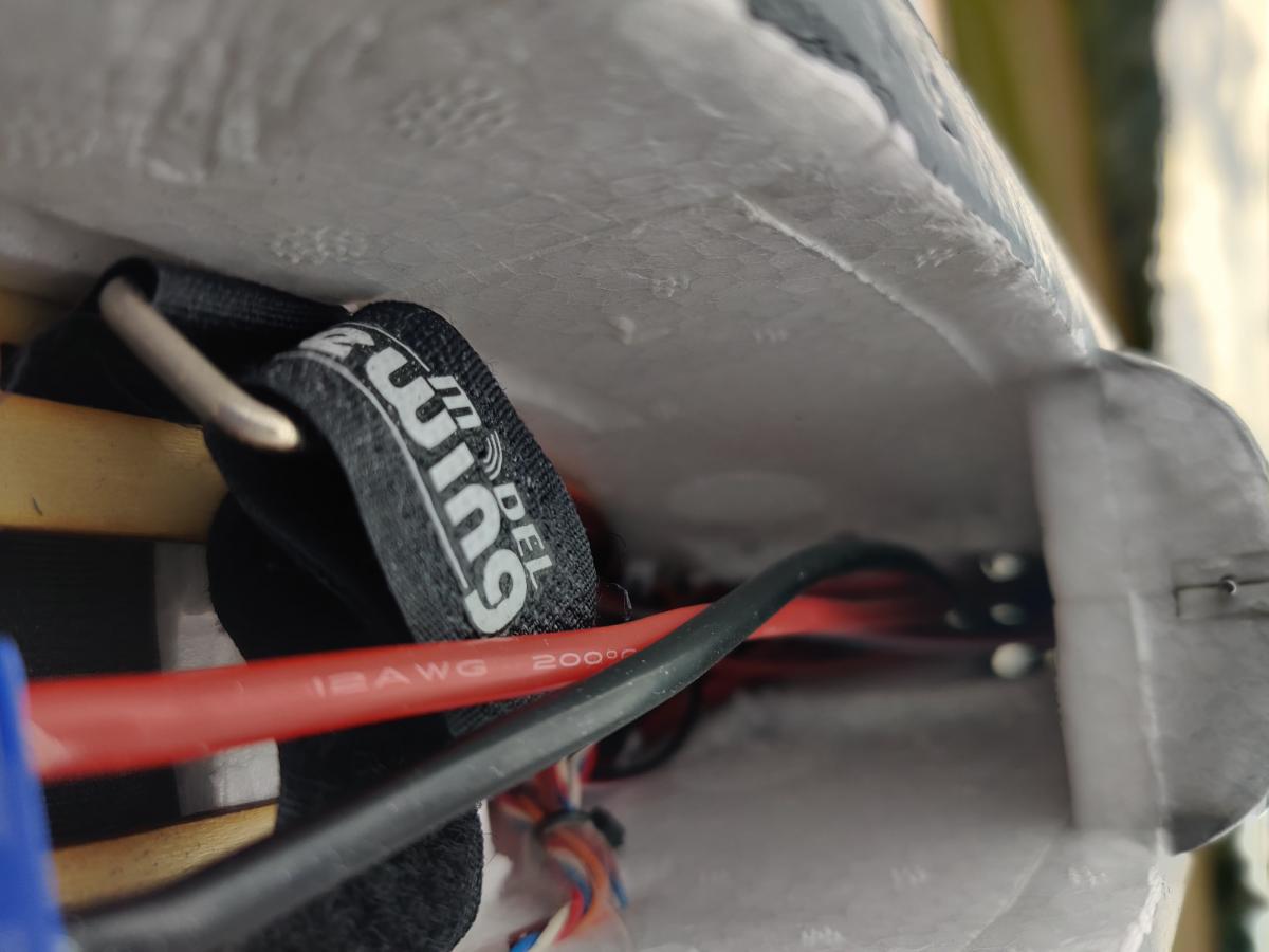

      My favorite is a Hobby Star 5200, 620-640g. This gives me a slightly more rearward balance than the book CG. I did remove a slight amount of foam on the sides so I could move the battery back slightly but have added no weight. I also use the Admiral Pro 4000 which is the same weight and dimensions and even 3700 Zippy compacts and the Hobby Star 3500.

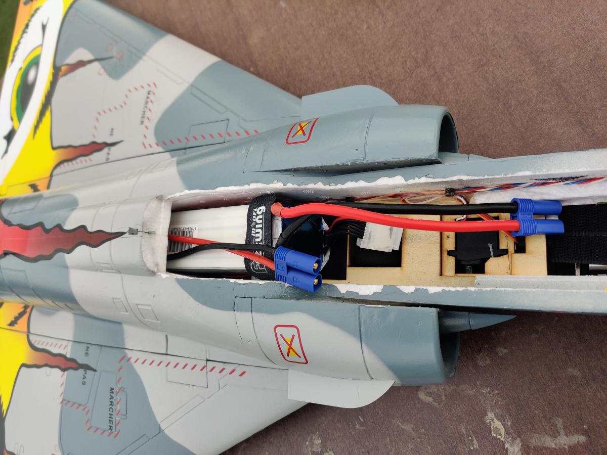

      Post a pic of where your battery is (also want to see how you set up the compartment. And a picture of specifically where you are trying to balance it.

        I'm going out flying later today, will try to remember to snap some shots.
        In short, my battery is as far back as it goes, unless I'm going to poke actual holes in the inside walls of the intakes. The strap in its stock location wraps over the battery at the very front end of it.

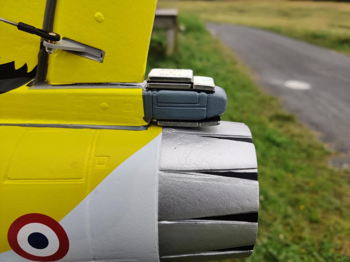

        Measured my CG fairly accurately yesterday, with that battery location + 40 grams stuck to the small pontoon behind the vertical stab, it balances at 520mm measured from the very aft of the model (the end of the exhaust).
        Which, unsurprisingly, is still a bit nose heavy.
        I do have my rx up front, but that thing weighs next to nothing.

          Somethings not right. With a 620g battery pushed as far back as I can It balances easy at 520 and I can balance and fly it at about 507mm. It flies really nice there too. But the odd thing is that on mine the front of the battery is at the rear of the square opening where you can see the front wheels retracted. Sounds like my battery is further forward than yours.

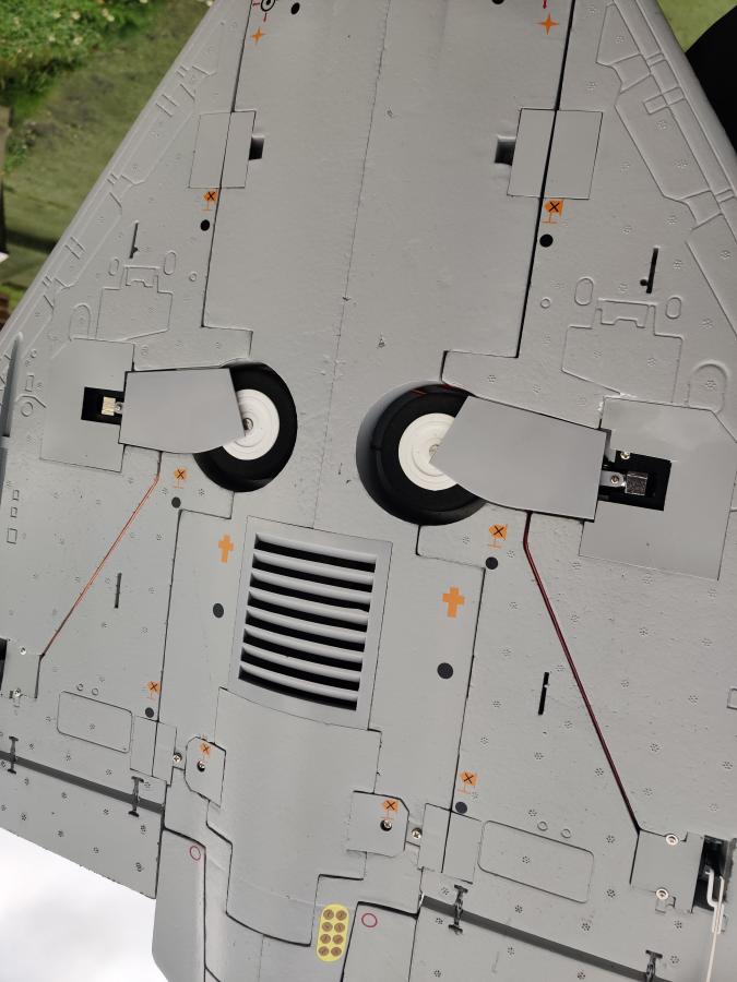

            Yes it is. Possibly my scales are off, so I might be flying a heavier battery than I thought? Just about the only remaining explanation at this point.

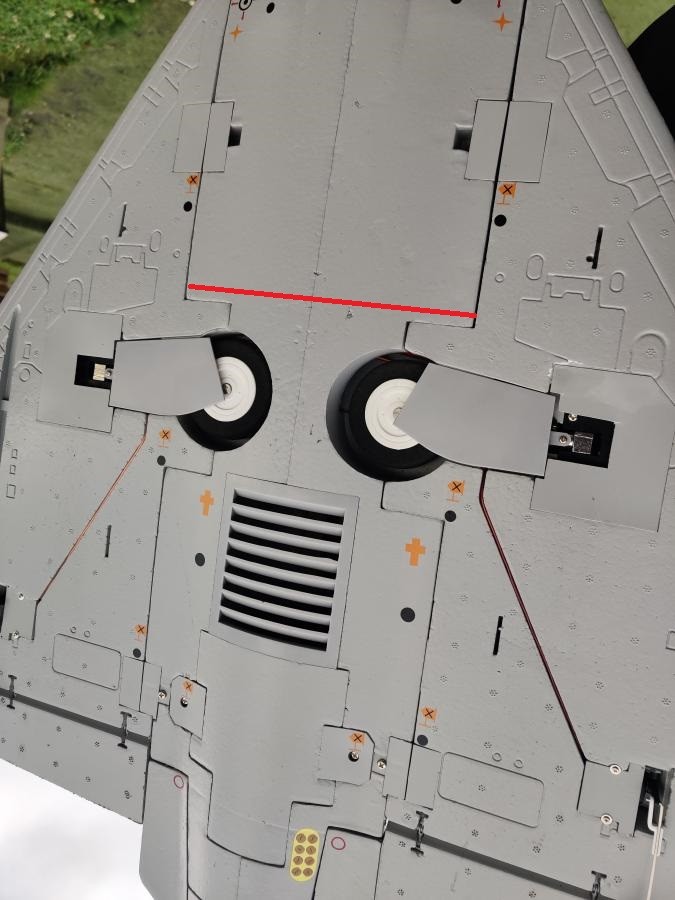

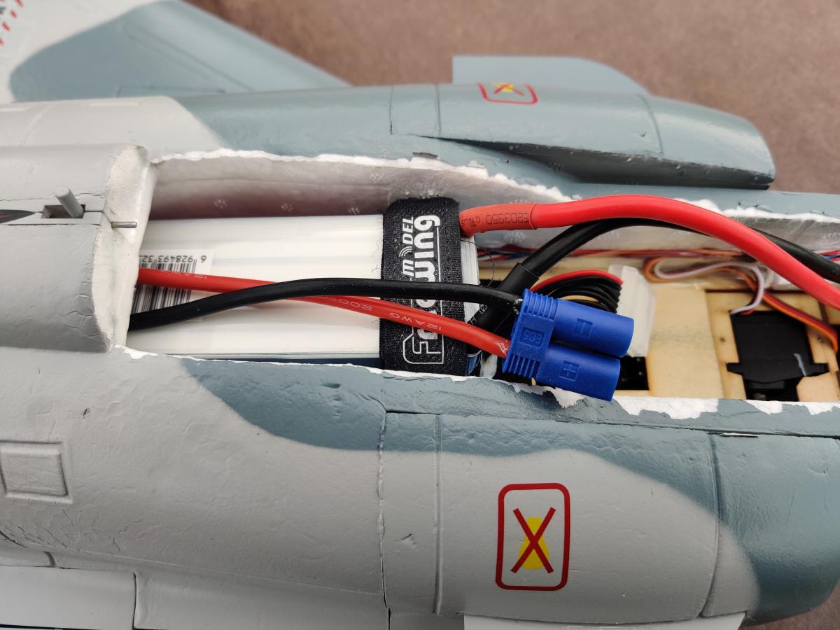

            Attached some pics. With this config, it balances pretty much exactly at 520 (and like you said, I want it further back)
            520 is just a smidge forward of the foam joint in front of the wheel bay

              Your battery is about 10-15mm further back than I have mine. So either a heavier battery or it's the wires? I don't have any magical suggestions. Maybe put the receiver aft and plug in the battery and then insert it with the wires aft?
              Either way I wish you luck in getting it sorted.

                The rx weighs about 15 grams, and a few more for the servo leads I guess, and it is very far forward currently. Will try to relocate it, but it is difficult to see that making enough of a difference.
                Will double check the weight of my batteries.
                The only other difference is that I haven't glued on the pylons for the tanks. But let's be real... they weigh like 3 grams each and are just the tiniest smidge behind cg. So should make any real difference neither.
