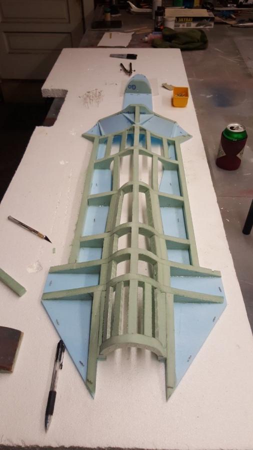

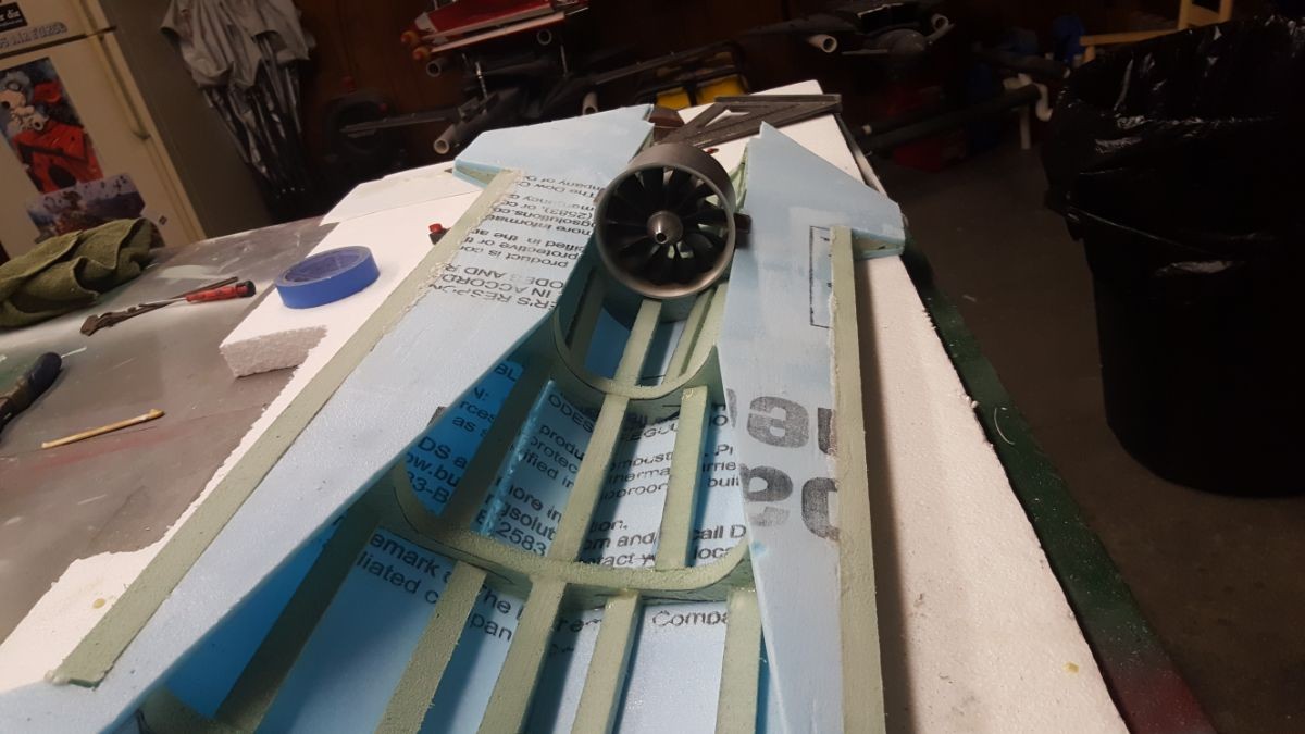

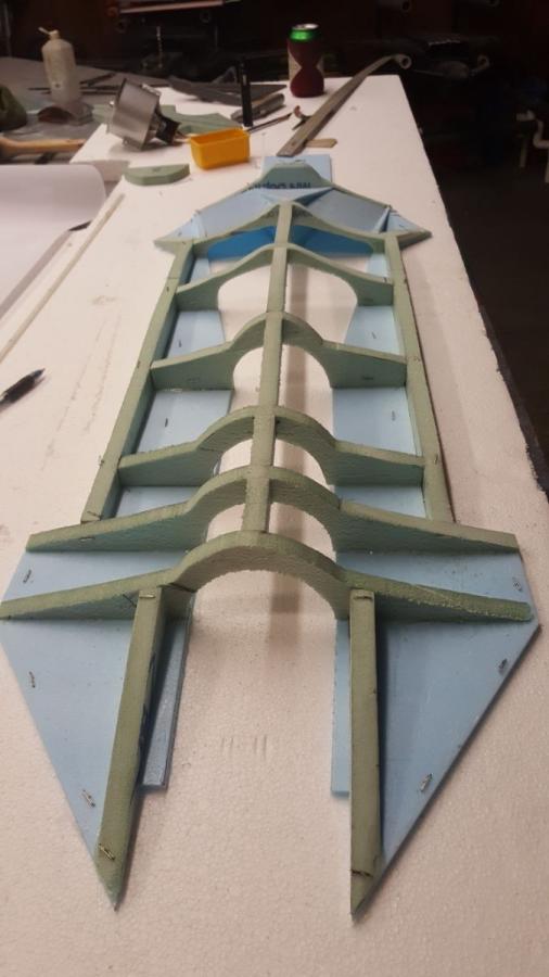

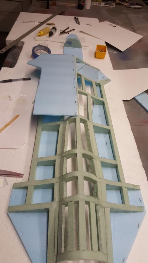

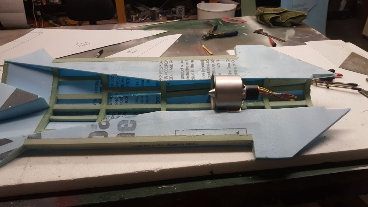

    Hello again my peeps!!
    Drawings are complete, and construction has begun in earnest. The model is going to be powered by a 90mm inrunner, on 6S 5000 mAh with a Castle Creations Talon 120A ESC.
    Built up ribs construction for the fuse, the ducting will be achieved with poster board, lightly brushed with fiberglass resin for waterproofing and durability. Wings will feature a radial spar design. The landing gear are rotating, so I think I am going to use the new A-4 Skyhawk landing gear in it. I am toying with the idea to make the wings removable, but I have not gotten that far in yet, so I will wait to see the viability of this option when I get there. The span is only 43", so it will not be totally cumbersome. The tall tail (which I have decided to go rudderless) will present more transportation problems than the wings I think.
    Anyway, here are the start of construction photos, I hope you guys enjoy the build!!

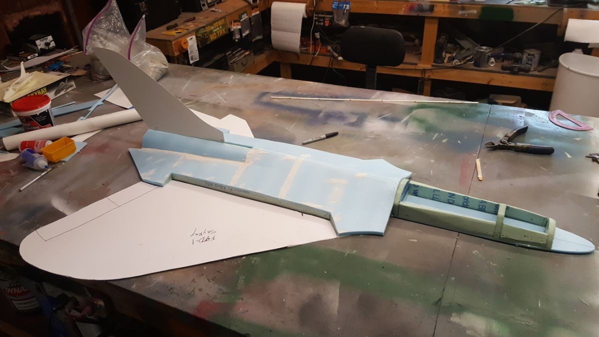

                          Last nights progress...

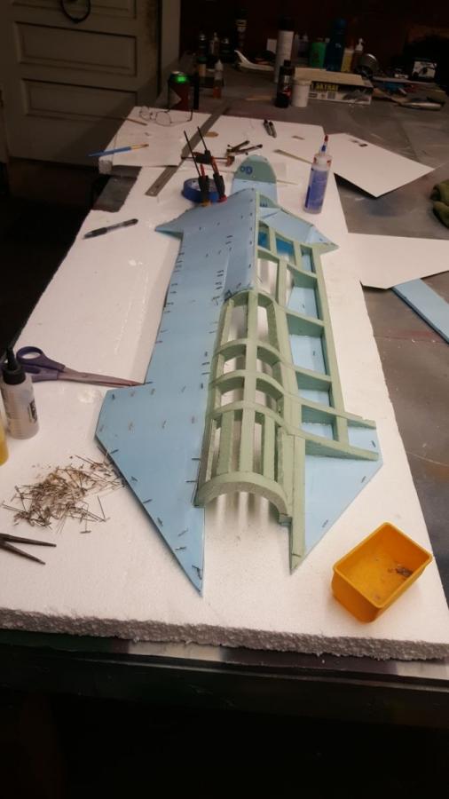

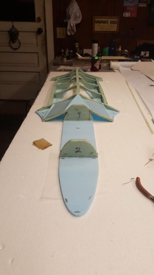

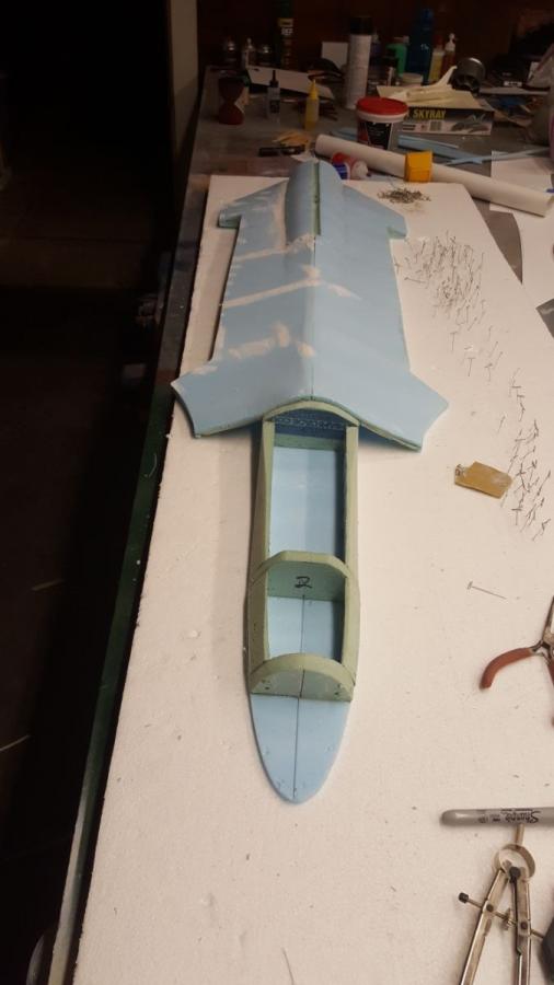

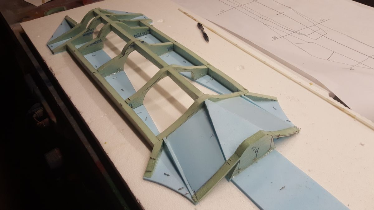

                          • #14
                            Progress from last night. I finally got her off the board!! Wow, super light and super strong!! She is straight as an arrow and very rigid. Tonight, I will get the upper ducting in and the fan mounts, get the top sheeting filled and sanded, and start working on drawing the bottom formers. I also went ahead last night and made the templates for the tail and the wing, so maybe I can get a few snapshots of what the whole picture will look like!!

                            • #15
                              This is really cool! Same materials as the Bronco, half inch blue with 3/16 sheathing and epoxy? Brilliant! I might build one as a belly lander, and power it with a 80mm 6 blade on 4s. Probably make a great edf trainer.
                              • #16

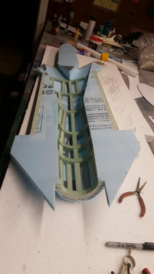

                                Yup, same material as the Bronco!! After getting it off the bench last night, I am seriously thinking about shrinking the fan mount section and putting the 80mm fan in it. The top of the fuse doesn't even weigh 6 oz, I think the empty weight for this one is going to come in about 24 oz or so. That will put it all up minus the battery at about 4 lbs. There will be three servos (No rudder or flaps. Nose wheel steering and elevons), three retracts, receiver, ESC and fan. I am afraid that 90mm inrunner will tear it to pieces, because you know, if I have the power, I am going to use it!! I am taking a short stay home vacation, so today is my last day at work until Wednesday, so maybe, I can have it pretty close to finished by then, and get a maiden next weekend!!
                                Here she is with the posterboard wing and tail templates!!
