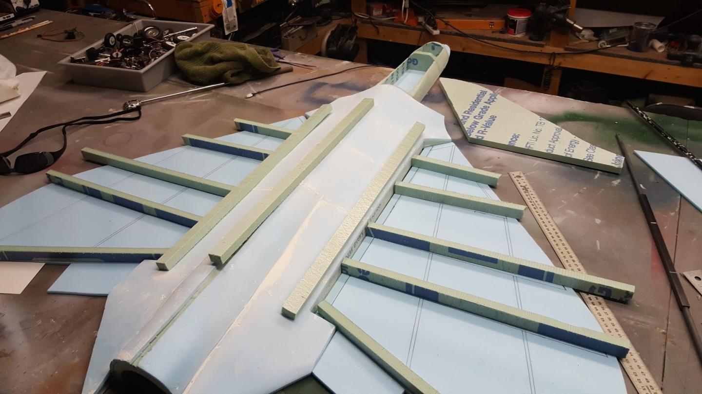

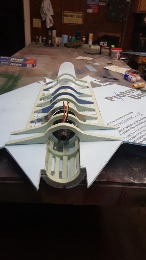

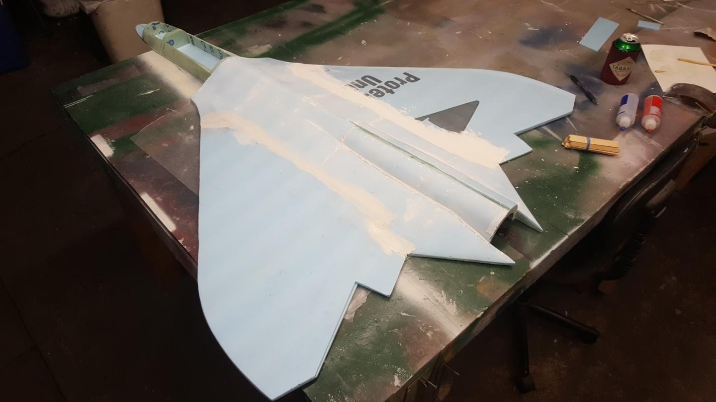

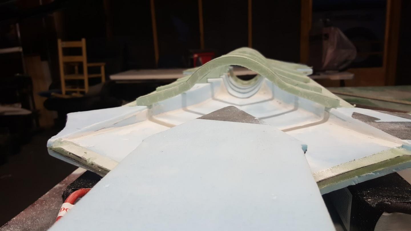

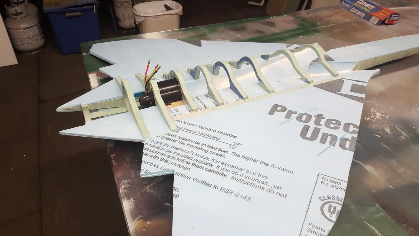

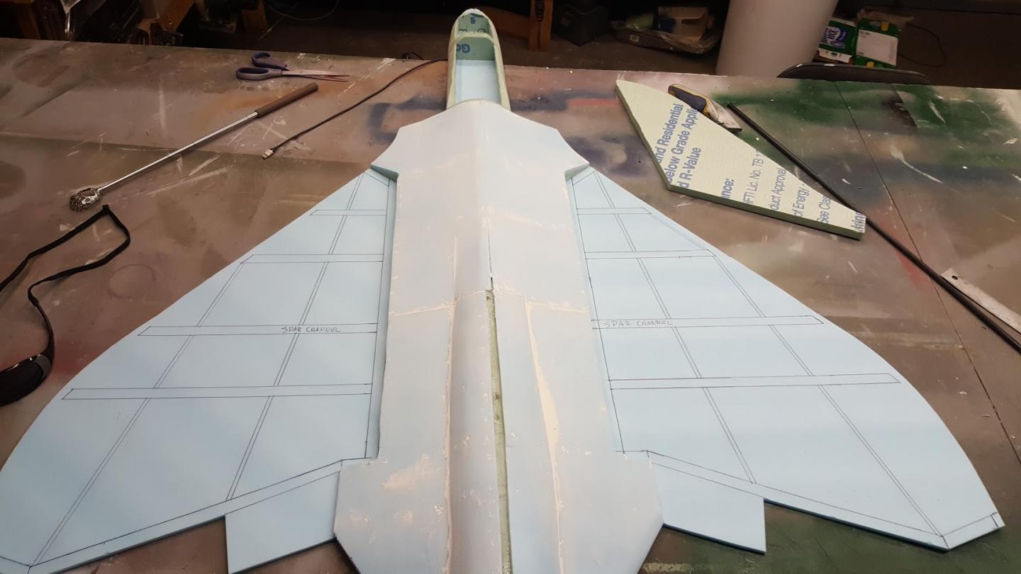

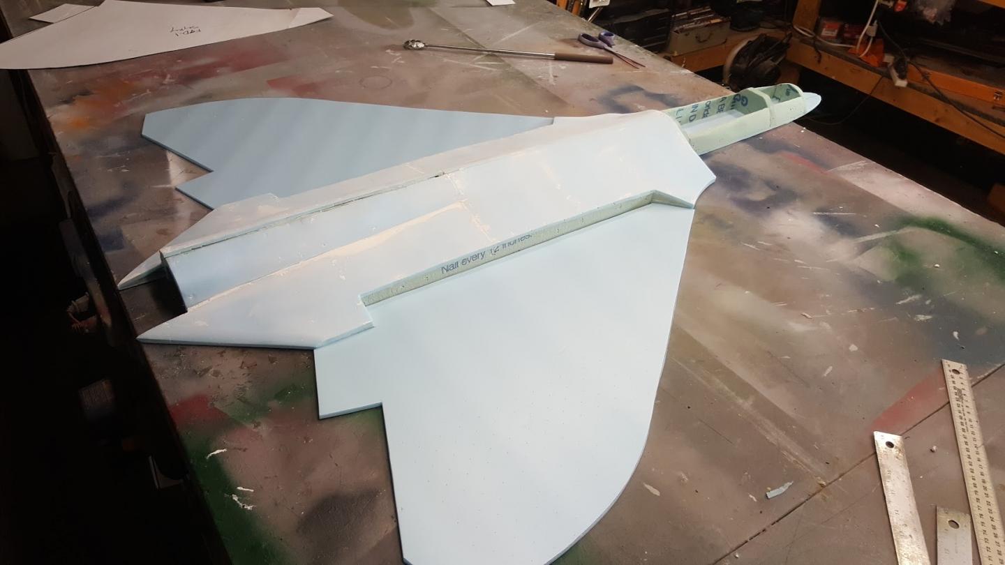

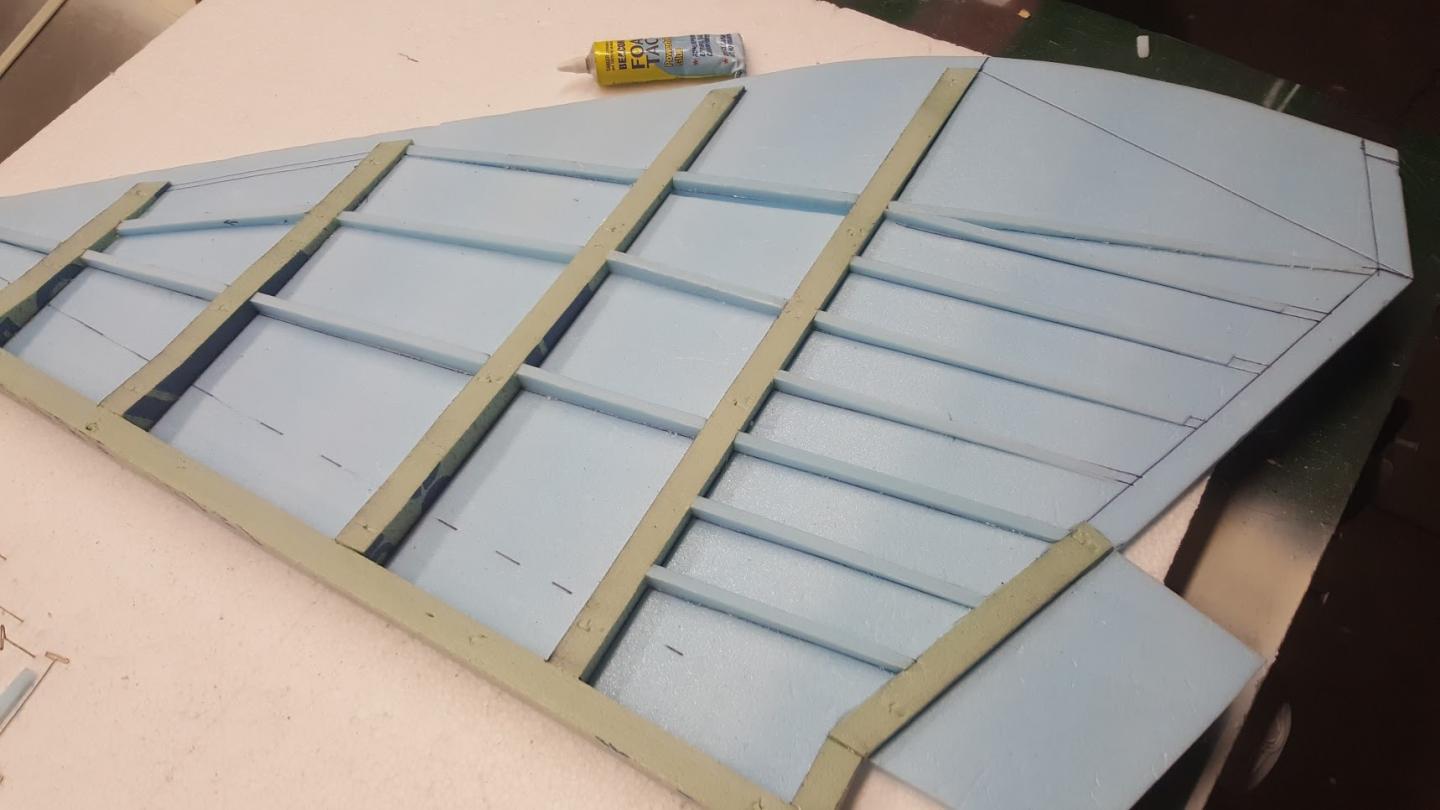

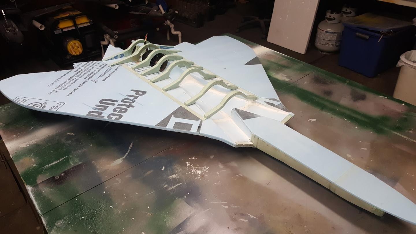

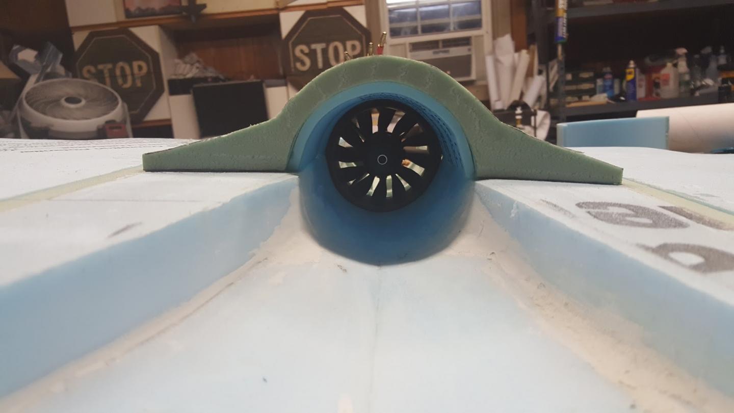

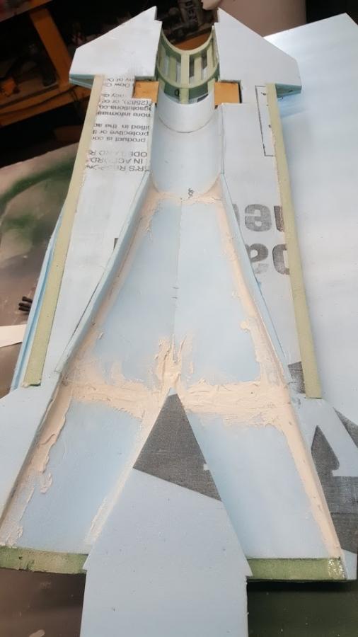

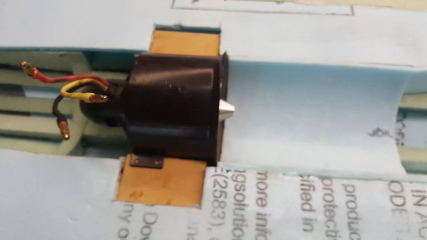

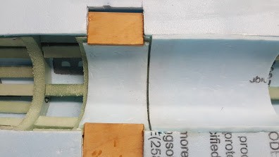

                        Okay, so here is what I managed to get done over my little "staycation"
                        The upper duct is in. I opted to go with the 3/16th foam, which put the duct at the perfect size for the 80mm fan. This all that this thing is going to need!! I also got the lower formers drawn and cut from the intakes back, and got the fan mounting plates installed.
                        Before I start gluing all of the lower formers on, I think I will tackle the wings. I have decided to make it a solid unit, the wings will not be removable. They also, according to my 3 view, have no dihedral or anhedral, so I felt it best to build the tops while I can still have the plane flat on the board. This will ensure that everything stays straight and true. Once I have the internal structure complete for both of the wings, I will glue them to the fuse, and then sheet the tops. I can then flip the model over, and route in the spars.
                        The front section looks a little wonky at the moment, as I want to sheet the sides of it in one piece, so I am waiting until I get the bottom formers on for that.
                        So, here you go!!

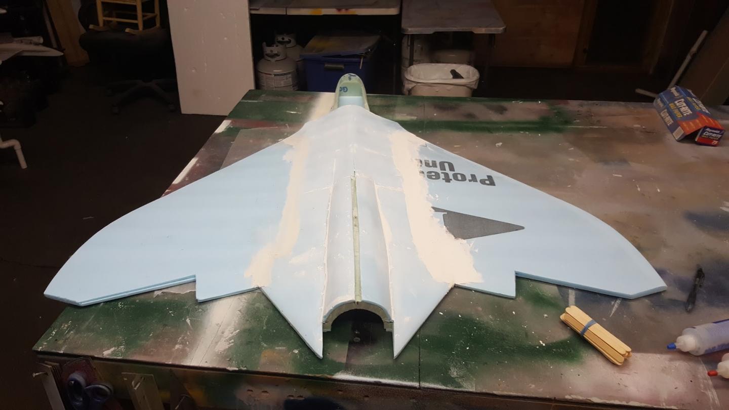

                                      #38

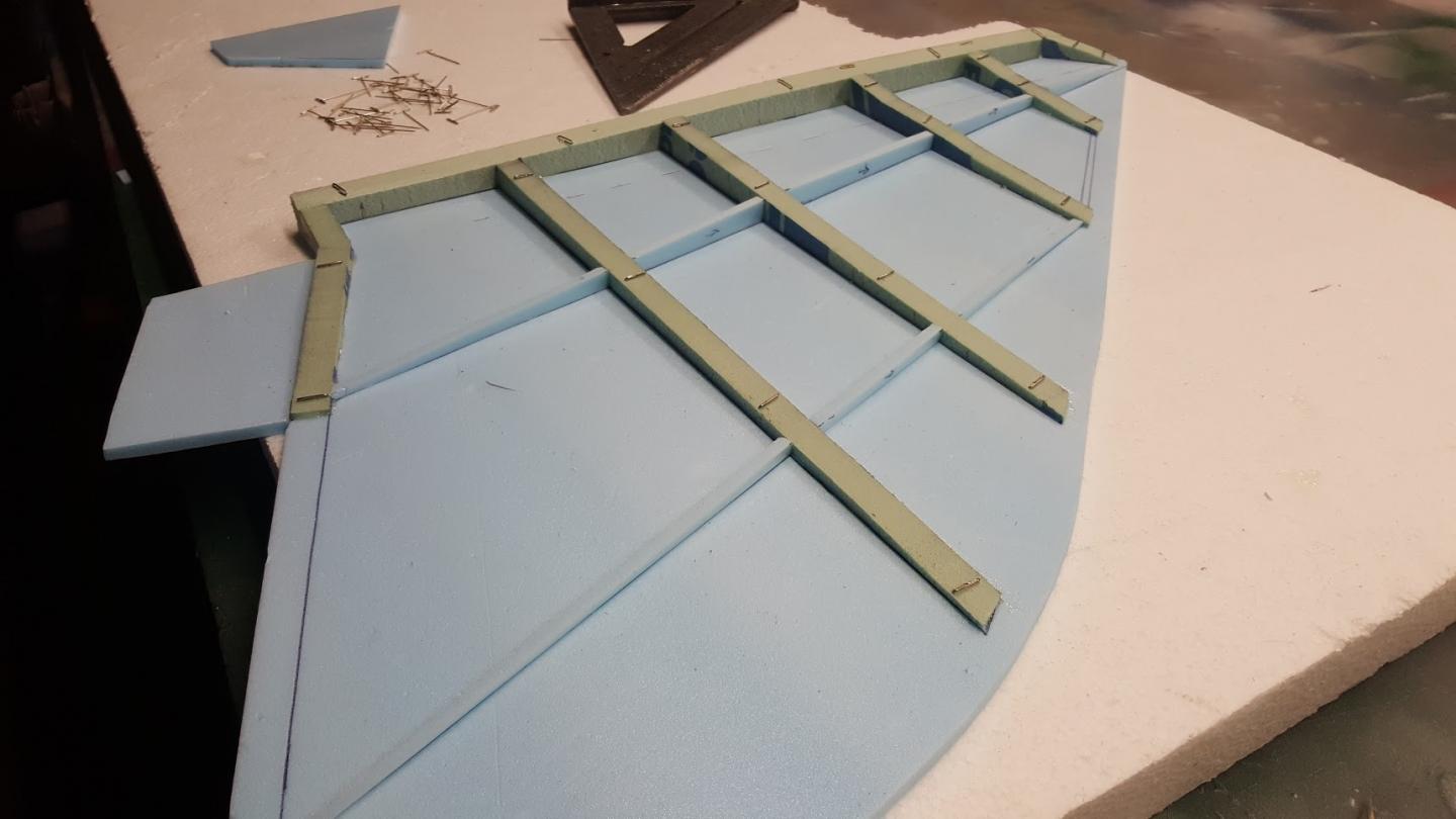

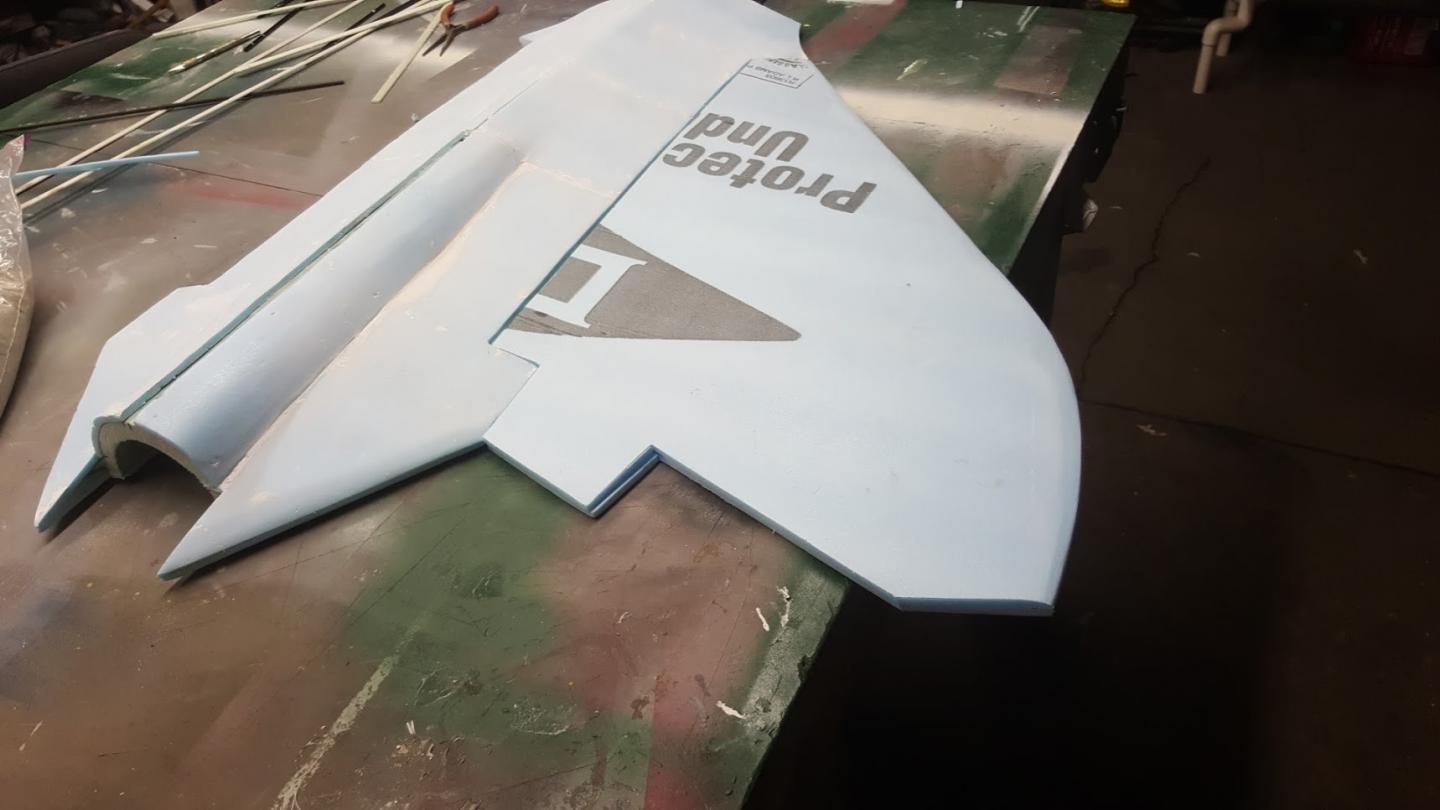

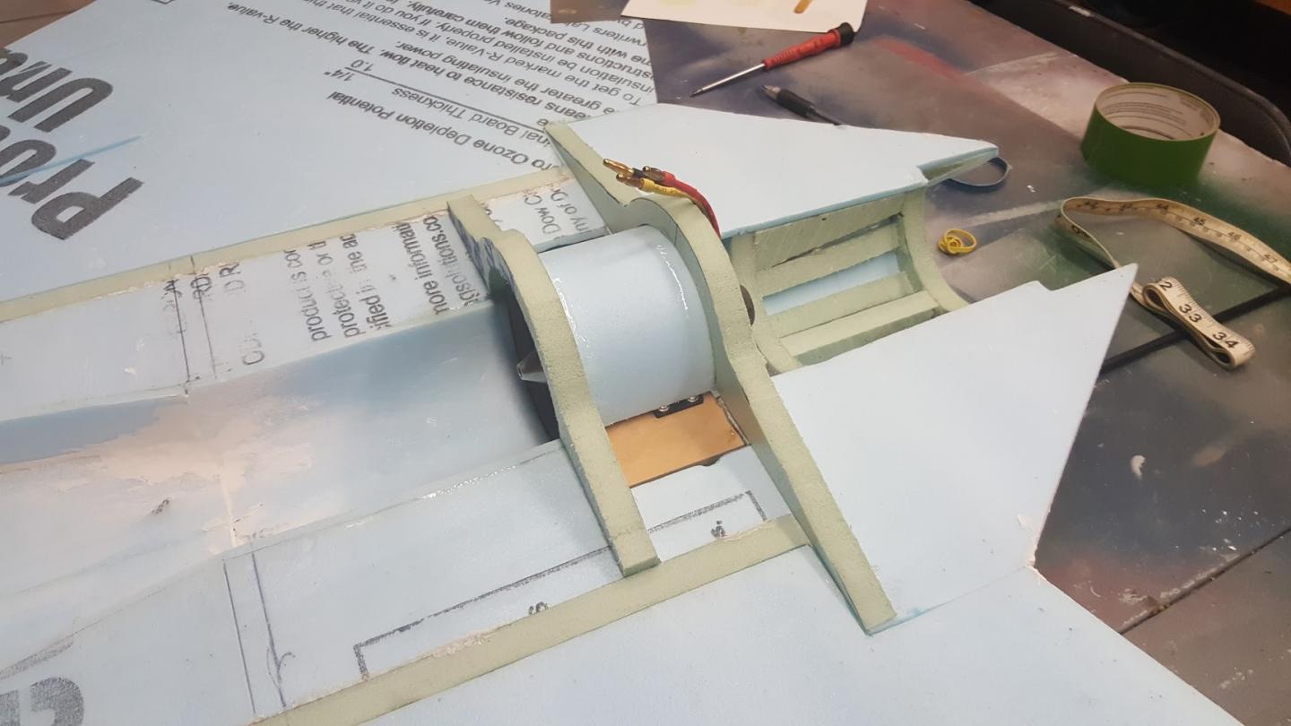

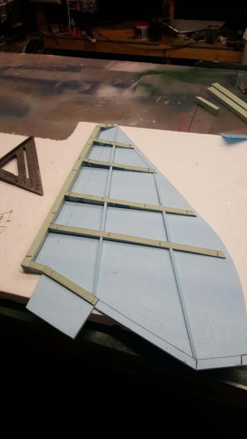

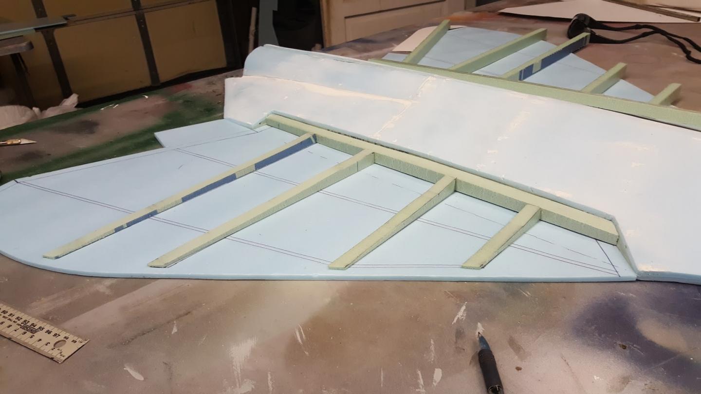

                                      Alright!! I have the top of one wing done and attached to the fuselage!!! It is starting to become something now!
                                      I cut a slot on the inside of the center sheet right next to the two main riblet line so that I can route it out from the bottom and put longitudinal spars in, as well as the lateral spars that will span across the fuse.
                                      Hoping that I can get the other wing half done tonight, and get it sheeted and attached as well!!

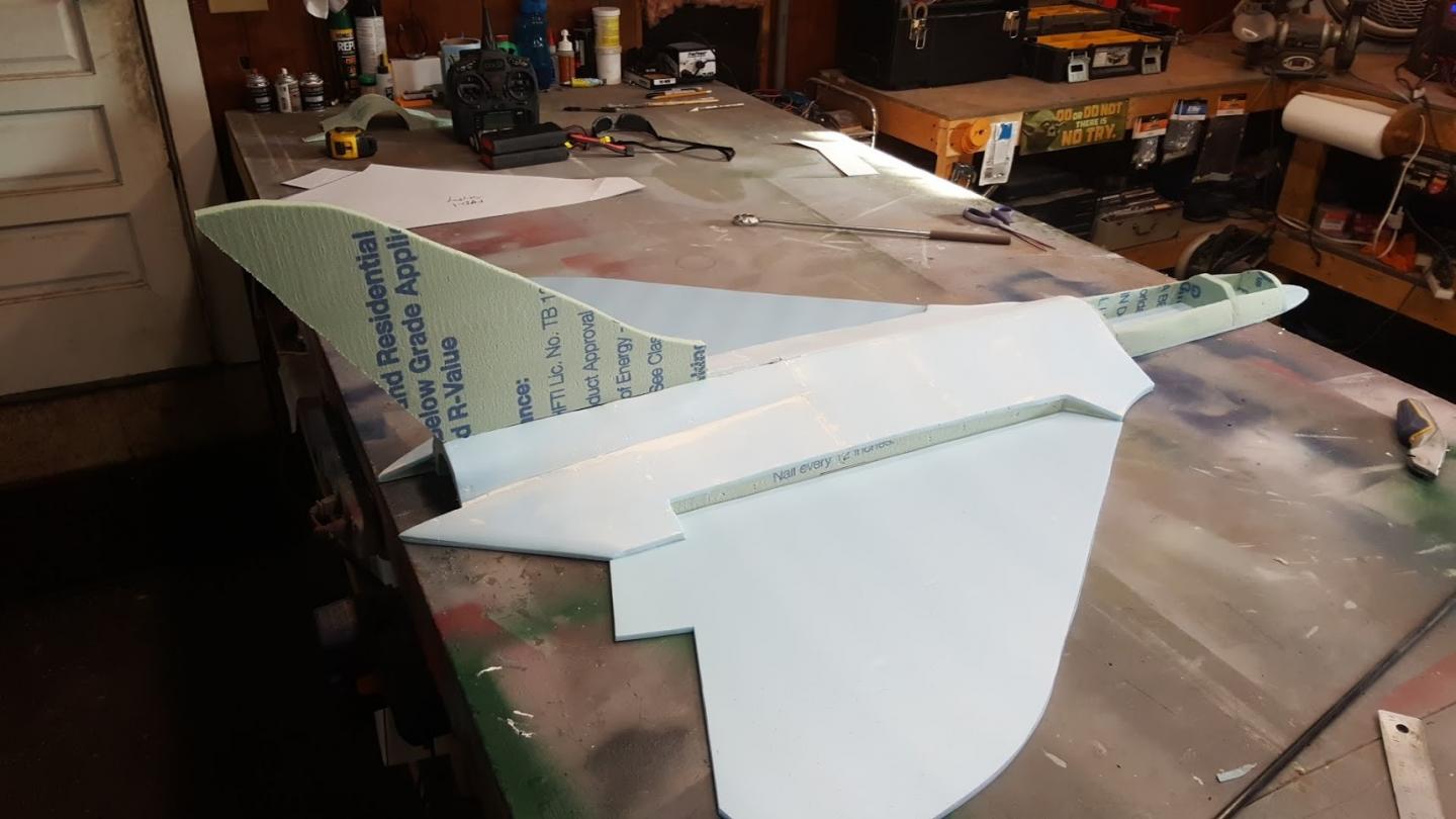

                                      She really shows her 54" length in the last photo!! Hopefully I will have a new set of photos tomorrow!!

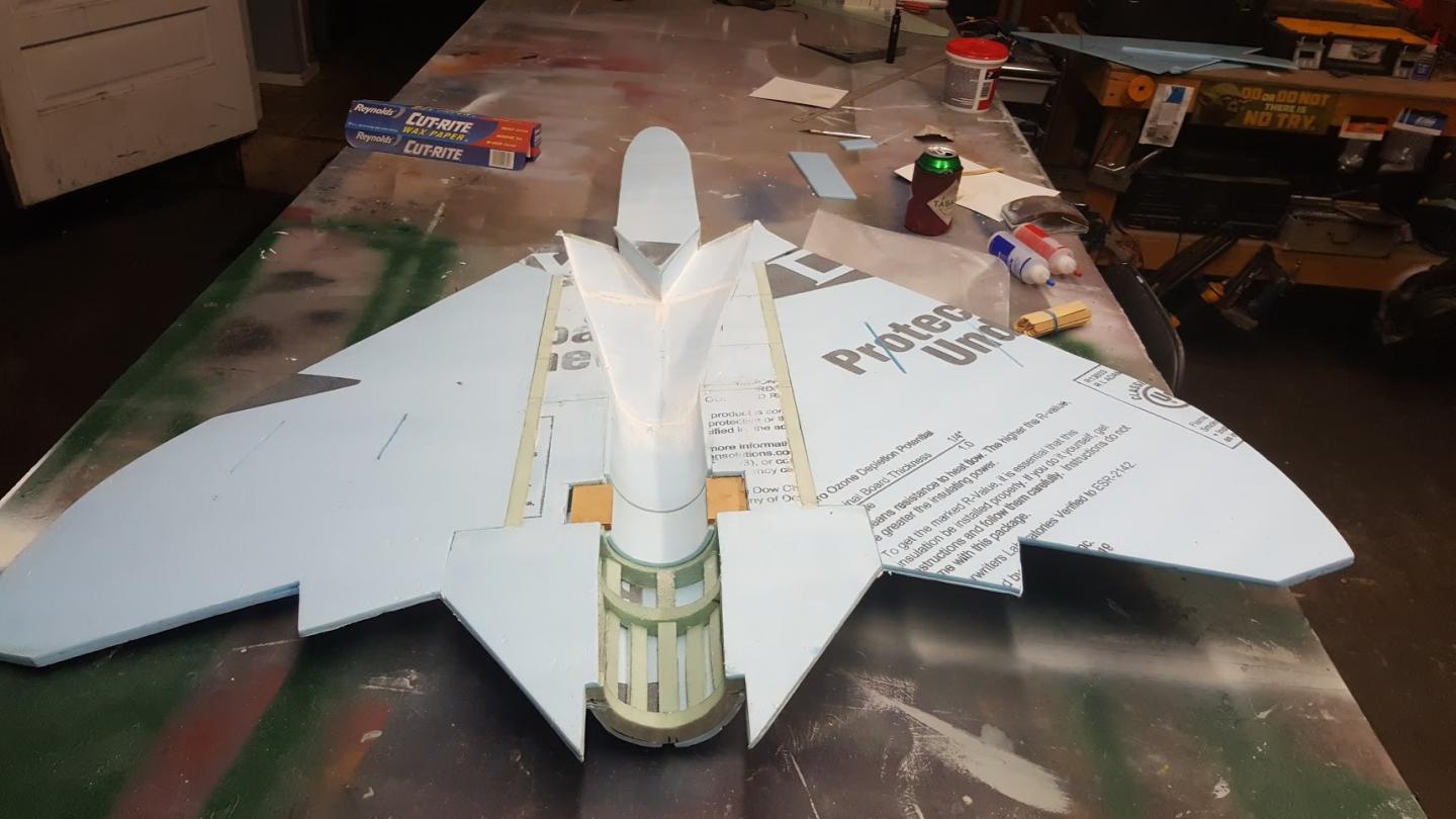

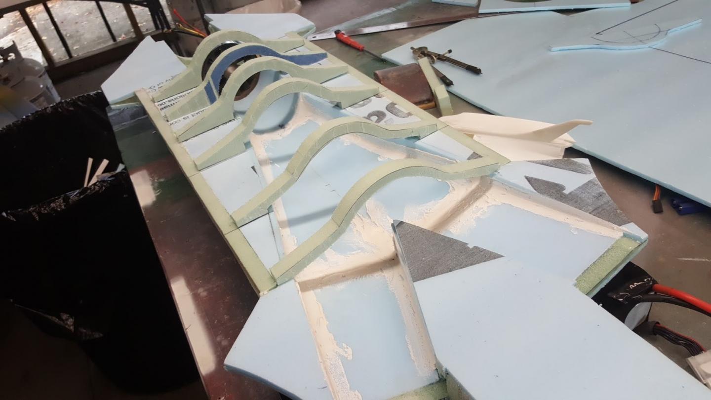

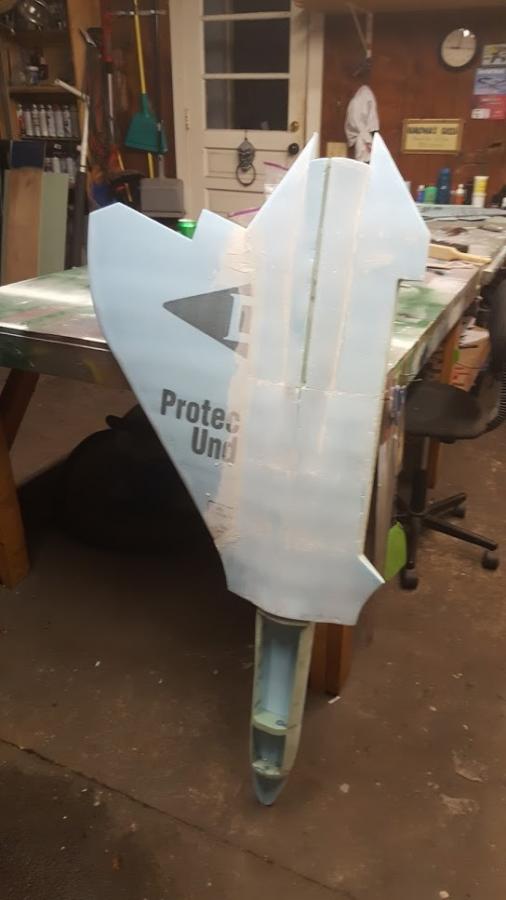

                                        #39
                                        Success!!
                                        Then I flipped it over and set the formers on for effect!!

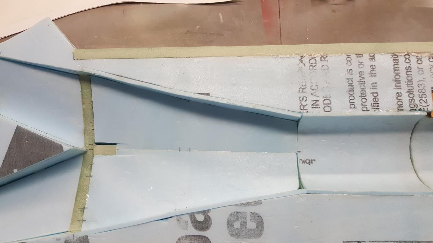

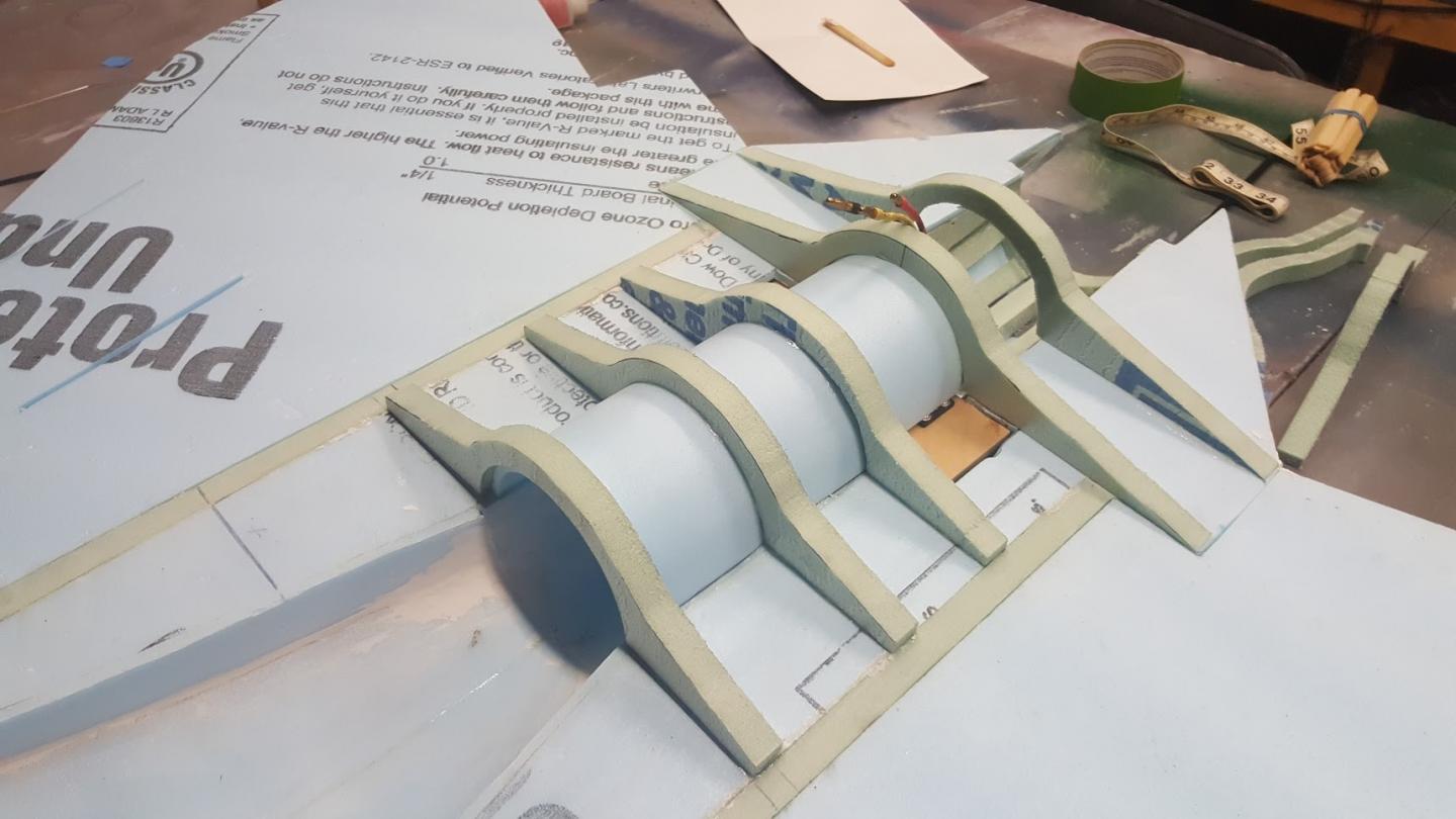

                                          #40

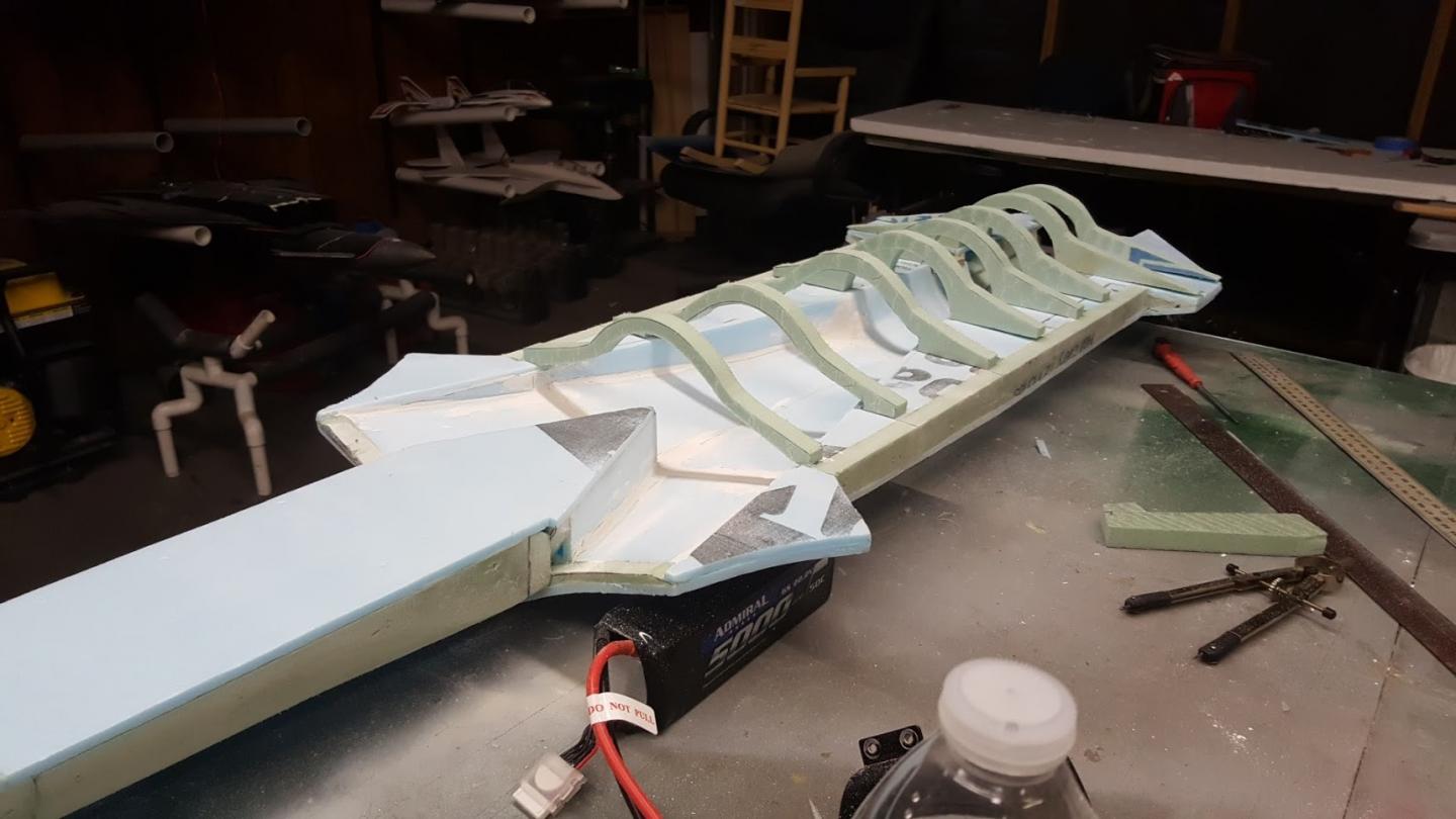

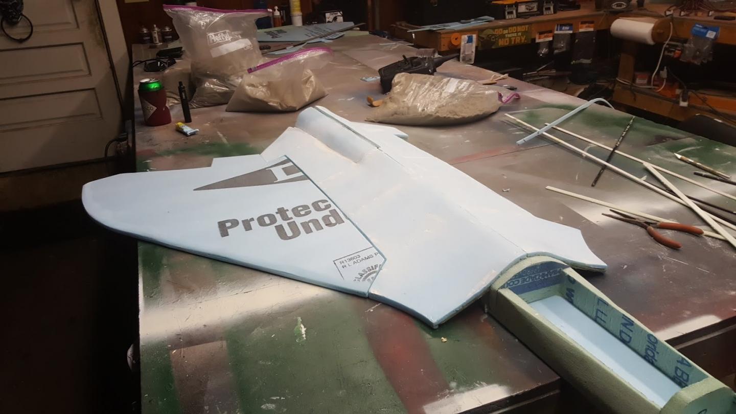

                                          Last week and a half has been rather crazy around here, so I didn't get anything done. Blew the dust off it last night, and got started on the lower fuse. The rest of the ducting is not going to be any fun at all, but I will tackle it tonight after I get the Freewing 64mm F-22 that cam in today built and ready to go!!
