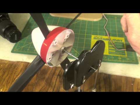

      If you van find the V1 prop bades and hub, you can do the zip tie shim mod to the prop, gets just a bit more pitch.

                I did the tie wrap mod on my 1700 red tail and with a 3300mah 6s it will go straight up on take off 200 ft with no problem at all.
                I think you'll be happy with it.
                Kenny

                      Hello fellow pilots; I just up loaded a video of me flying my FMS P-51 Mustang Red Tail with a 3300mah battery and the tie wrap prop mod showing the plane going vertical way over 300 ft up with no problems at all. I listed another video in the description on the prop mod. I hope this helps you get the most out of your plane.
                      happy flying!
                      Kenny
