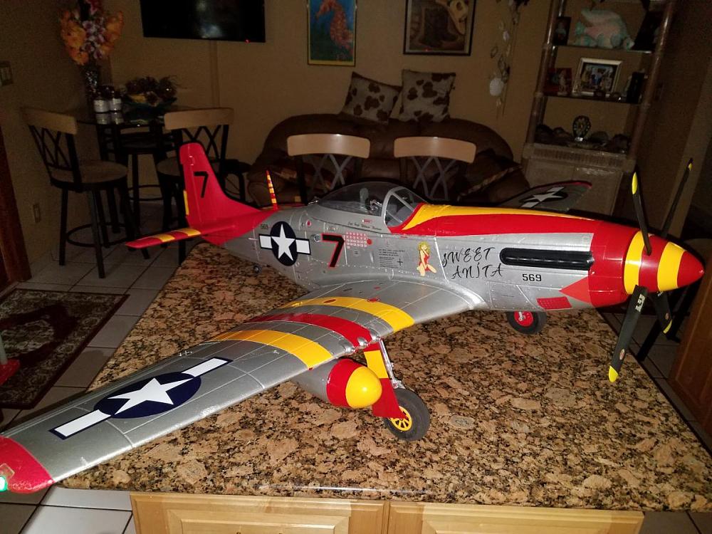

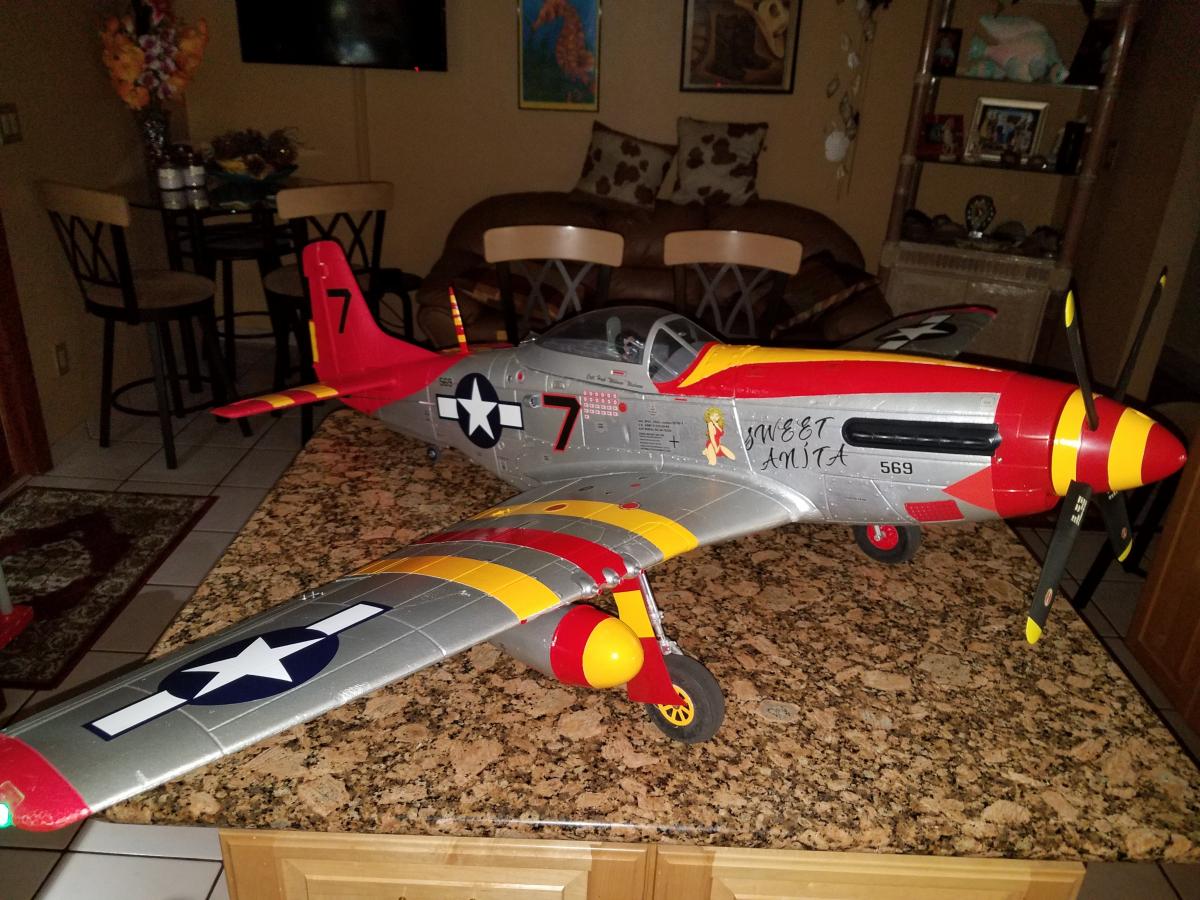

          PaulZ, Job well done on the maiden. I've had this P-51 for maybe 2 years now and agree completely with Alpha, it's a looker, great presence in the air and infinitely better than their big Corsair (which is almost 1.5 pounds heavier). Still at about 8 3/4 pounds, this P-51 is no feather. I found that a lighter battery, such as the 4000mah, allows it to be a little quicker and climb better than the recommended 5000mah battery, while still giving about 5 minutes flight time as you can use less throttle to do the same flight routine. Even so, the 5000 gives a few more seconds (30) of flight time but I find myself using about 10% more throttle to do the same maneuvers. Some have done a prop mod, but I left it stock and like the big 4 blade. It flies very scale, in my opinion, and is always with me on prop warbirds days. It takes off and lands beautifully. I also put the sound system in it and the Merlin engine sound is extremely loud, given the large fuselage area to resonate the sound with.
          For the first 20 flights, I had major "issues" with both retracts. My issues where that the retracts would not fully retract while flying unless I inverted and dove down while retracting the gear. I had put the 3 3/4" Robarts on which were heavier than the stock wheels and the stock retracts didn't have enough guts. I then purchased their full metal retracts and ever since I have never had a problem with the gear. So it doesn't surprise me whenever anyone has problems with their stock retracts-they just don't have enough punch. So my only advice is, replace them with whatever you can make fit and that should be the end of your troubles.
          Below is the WW2 warbirds day for me from a couple weeks ago, and I don't know how the F4 snuck into my truck that day but she was whining about not getting enough action and I had to bring her along to shut her up (yes, I know, I need therapy because lately all my planes talk to me and whine like children if they don't get to go along every time-don't yours talk to you too?)
