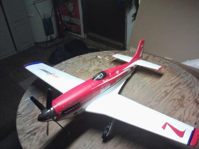

Ridge Runner P51 Mustang 1400mm. My flag ship
  • FLY BOY
    Flight Leader
    • Feb 2014
    • 264
    • Vancouver Washington

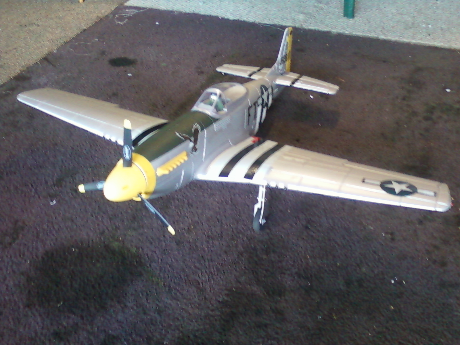

                                                                                                                                  Modified Ridge Runner version 7 with all the V8 upgrades. Very fast and nimble. Draws a crowd every time. High speed, low fly by's a must. Upgraded power system, as well as custom design. All trim hand painted offering great orientation at altitude.  :D I also have the following in my Hanger, Pics below.

    Power train up grade I kept simple. Just a 80 amp ESC that will endure a 5 cell. Zip tie wedges behind the prop blades for more pitch. Much faster than stock for sure. The stock FMS Motor runs hot though when ringing it out the whole time. So I save it for when its time to show off a High speed full on power dive, low altitude fly by down the runway. It really whistles when this happens. I dont make it a habbit of running the 5 cell either. The motor really dont like it over all. So I keep mostly to the 4 cell batt. Still plenty of power with just the 4 cell and prop pitch wedge. Would love to up grade the motor some day. Finding the right match is hard for I love the 4 blade prop look.

              Just a quick question.  My P51B likes to angle off to the left while taxiing, I'm not quite sure what the proper method would be to straighten to taill wheel.  Do I have to pull it out of the plane?

                I found 3 ways to deal with this. Mine had the same issue. The first thing I did was pull the assembly out of the tray. I found a set screw in the side of the tail wheel mount. I loosened the set screw, straightend the wheel, tighten set screw. This only helped not cured. The final cure after above mentioned is, disconnect clevis to rudder. Taxi and trim rear wheel until drives straight. Adjust clevis accordingly and reatach to rudder. If trimming is needed on the rudder in the air, land and readjust clevis until no trimming of the rudder needed while flying. This will keep your tail wheel straight. The pit fall? Turns really good one direction while on the ground, Not so good the other direction, But it taxis straight!  :rolleyes: PS Remove tail wheel rod from retract. Use dremil and make a new flat spot on rod where set screw meets it. This is harder to do but will work, and keep your turning radius good both directions. I should have thought of this the first time. But it was to late.

                  Well I finally had to replace my retracts in my Ridge Runner P51. All of them! I flat wore them out. I had the V8 struts installed, but V7 stock retracts with 3 second delay. So I installed the latest and greatest set up with the 6 second delay even with all new shock struts and tires. Whew Wee they look nice, and work very well. The action is good and smooth and the newest version of the shock struts were already painted. Even the retractable tail gear has been upgraded with an all metal trenion as an unexpected bonus. My old one was plastic and the gear inside had been stripped for months.
                  With DAVE BROWN tires and the shock absorbing struts, I expect even a longer life span out this sweet up grade.

                    Have you thought about doing the 580Kv motor upgrade?

                      Yes I have. On my wish list with the Mantis 85 amp ESC. My buddies and I like to goof around at the field practicing combat maneuvers, and play tag so to speak. We do this with all the same size war birds to try and keep it even in air frame size. My one friend has the FMS 1400mm Zero with the 580 motor and its a tick better all around. The 580 motor comes factory on the Zero.

                            I also found that by increasing the servo throw to 140% in my Dx 8, she turns a lot better on the ground.  Then I hit the rudder switch to position 1 and tame her back down to 100% in flight, position 2 gives me 70%, just for the fun of it
