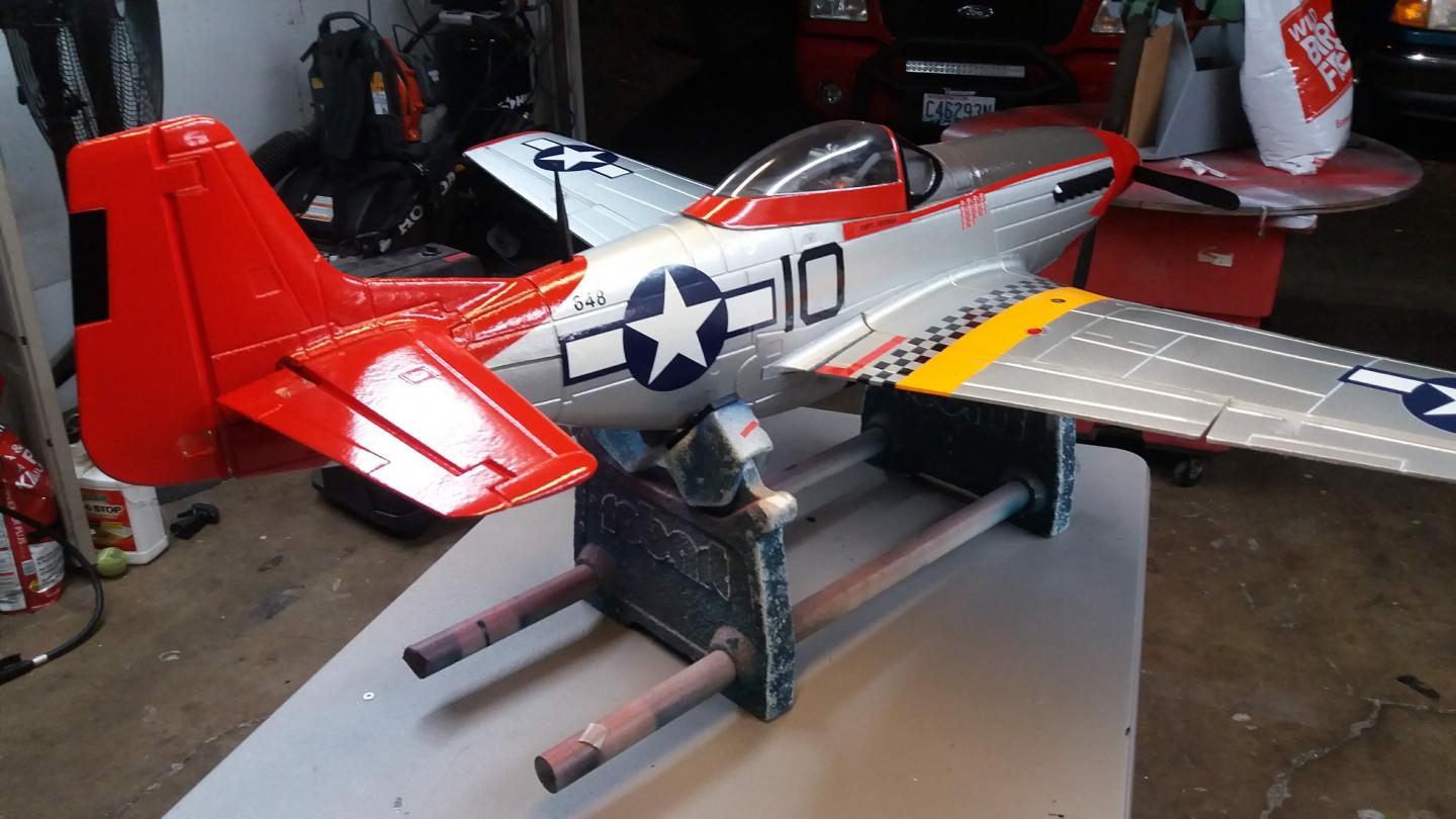

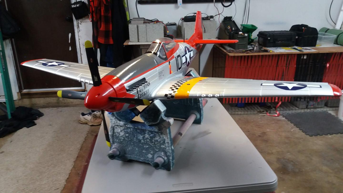

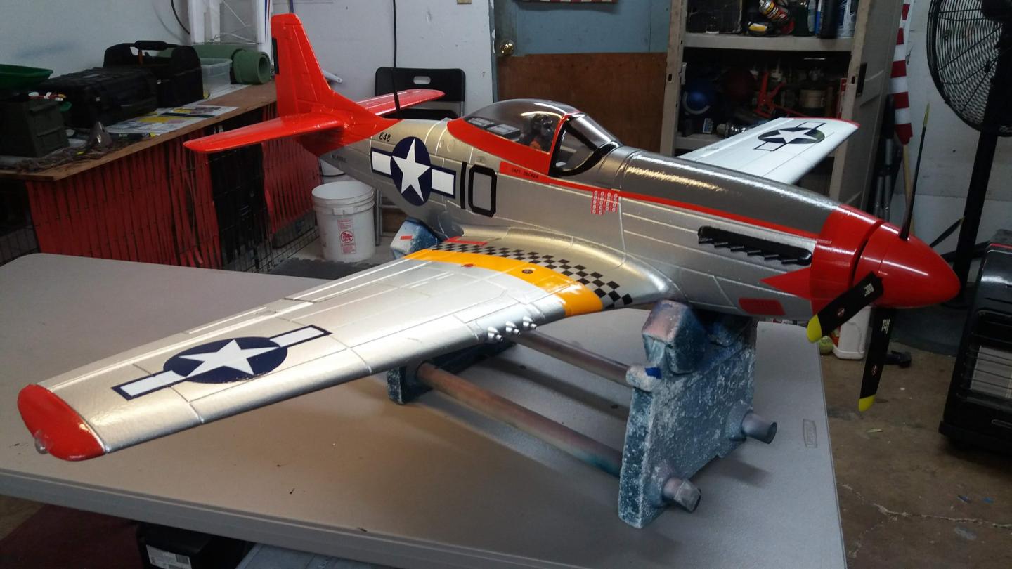

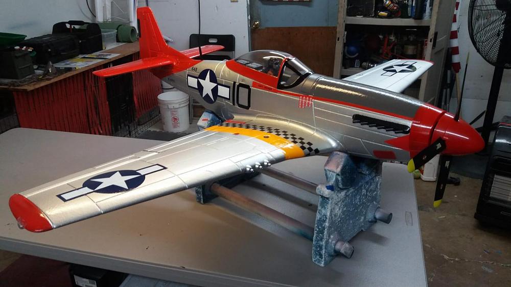

                            Introducing my new flagship. FMS P51 Red Tail V8, Equipped with the P40 KV 650 motor, Zip tie pitch prop mod, and sealed off the belly scoop for less drag. This one kicks the Ridge Runner V7 butt!!!
