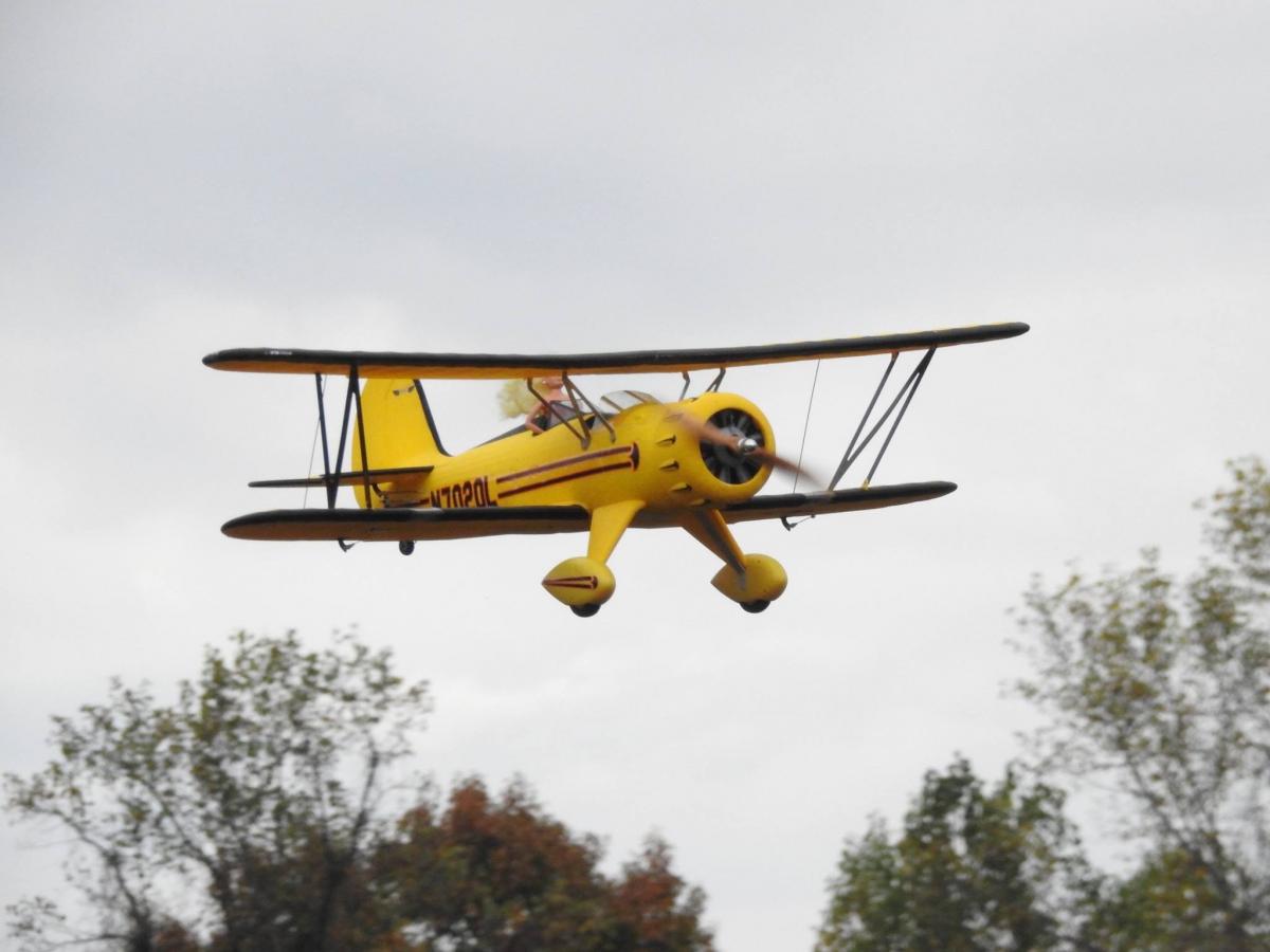

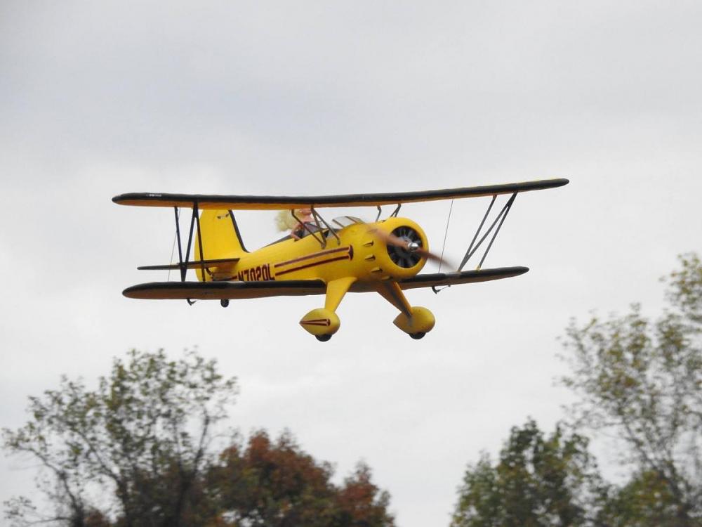

I'm flying the model on the recommended 4s 2200mAh battery and this will provide a flying time of between 4 and 5 minutes depending on the type of flying you are doing. The model will take off and land very easily and it's what I call a no drama model, there are no unpleasant surprises. It will loop, roll, 4 point roll, fly inverted and perform snap rolls with ease.
It's a delightful little model with great aerobatic capability.
