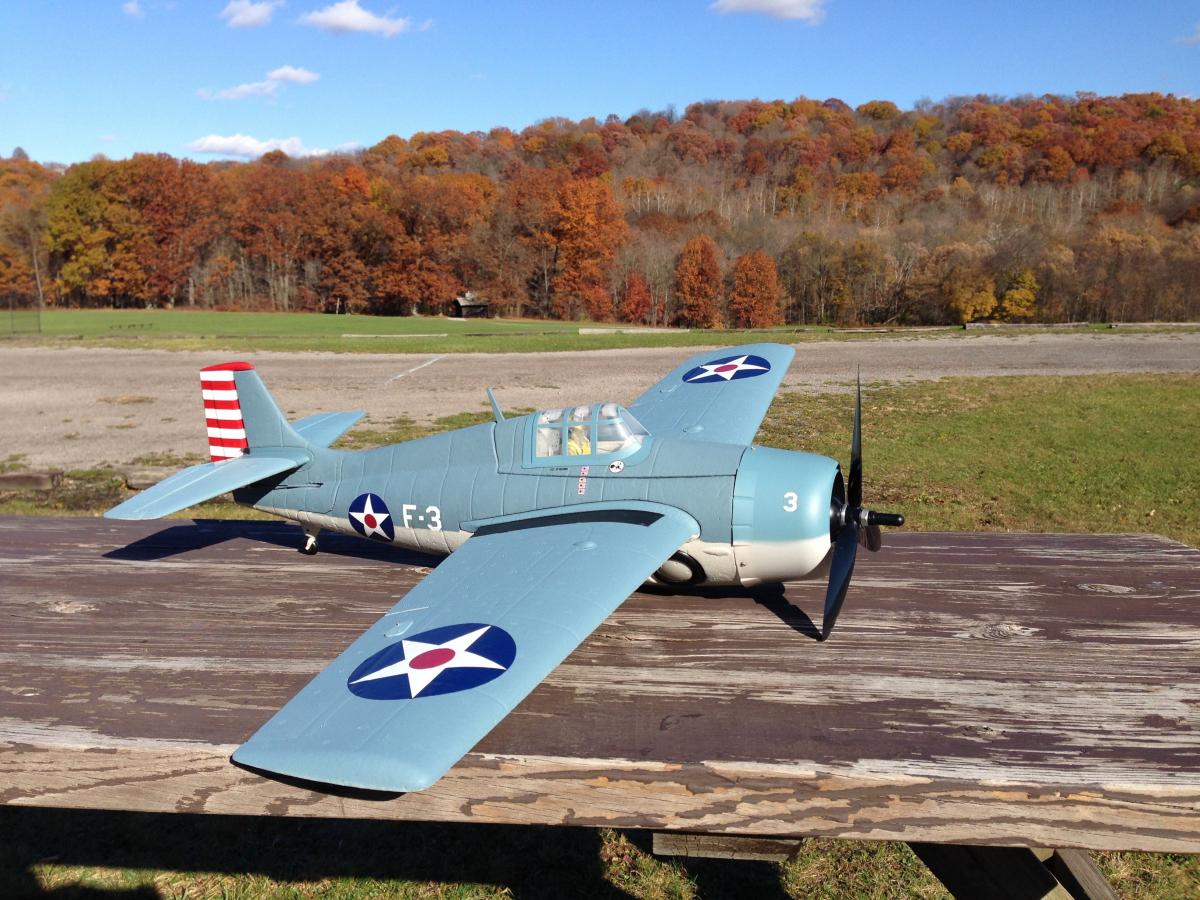

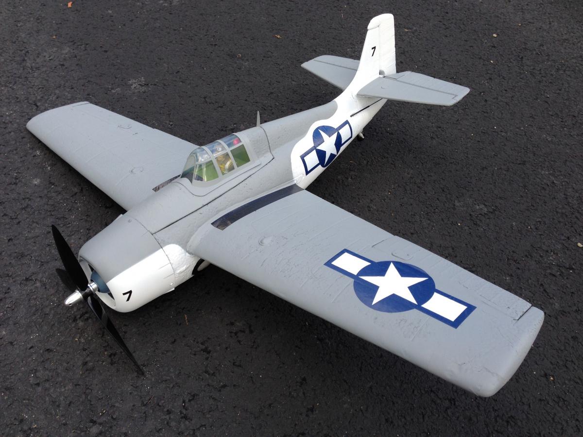

            I have two of those. Both are hopped up with motors n esc’s from bigger PZ warbirds and run the PZ Me109 prop. Fast with unlimited vertical, this little bird has great slow flight characteristics to! One of my buddies calls it the football with wings. I have hundreds of flights on the blue one as it can always squeeze in somewhere on trips to the park! The North Atlantic one was put together from other wrecked parts given to me. Great little bird!

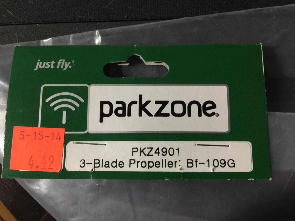

                  At one time I had all the PZ airplanes, all of them were upgraded, ran bigger motors/esc’s, and used the PZ Bf 109 10.6 x 7.8 - 3 blade prop because it’s a ripper.
                  The smaller PZ Wildcat and Mustang were upgraded to15 size motors with 30amp esc’s. Be careful hand launching and use around 2/3 throttle as the model will torque hard left at full throttle!
                  They climb like a homesick angel with this combo.

                          The Bf-109 three blade has flex to it and oddly enough acts like a constant speed prop.
                          Strange as it may sound, if you can find one, give it a try.
                          I definitely don’t use it for looks.

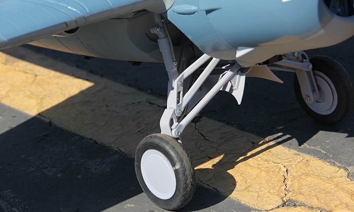

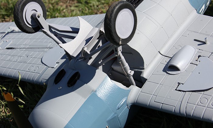

                                I was just thinking the same thing. Belly-landers are a deal breaker for me. The size does not seem bad as the real F4F was a small plane anyways but I rather pay a litter more for some semi scale retracts.
                                This gear is from the BlizRCWorks model. I wonder if it might work on the Parkzone model after some modifications.

                                    Your talking about a major mod. Might be a little heavy too.
