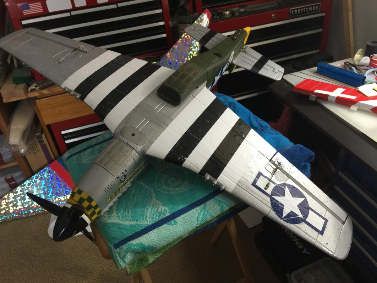

        These were definitely made as a notch above UMX, throw it into any vehicle, go to a park, let it rip! With a bigger motor the fun meter is at the top of the arc. Mine hangs on a coat hanger in the garage, ready at a moments notice. The PZ Mustang which I also own fit the same nitch. It is even more stable than the Wildcat, the best flying of the two!

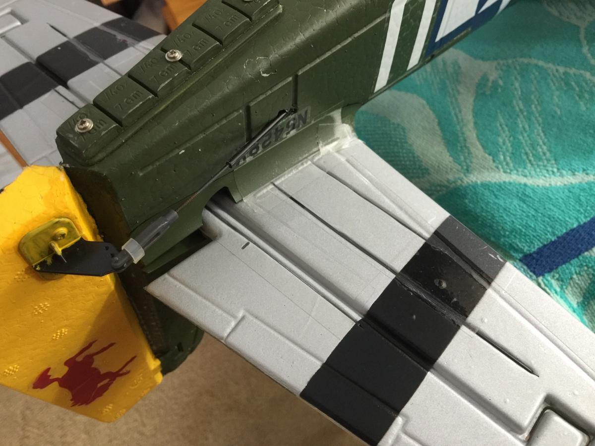

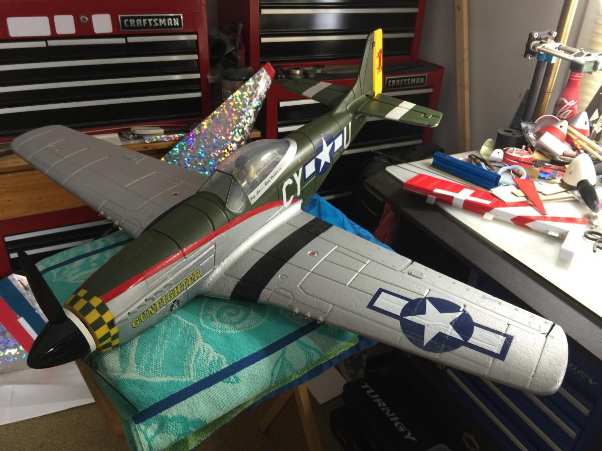

              I spent the day going over Gunfighter, it’s gotta have way over 300 Flights on it. I did the rudder mod when it was new, had to slip a ca hinge into the rudder at the horn location. The stab is also modified with three pieces of carbon fiber. Stock, the stab will fold up at high speed. Witnessed my buddy’s stab break at 100 mph destroying his Mustang in the resulting crash. Nose is opened up for airflow and a 4s battery. It’s right up around 100mph, still lands on a dime, and slow flights very well. Hands down best bang for the buck hand toss belly whopper around. Complete replacement airframes are available on EBay...

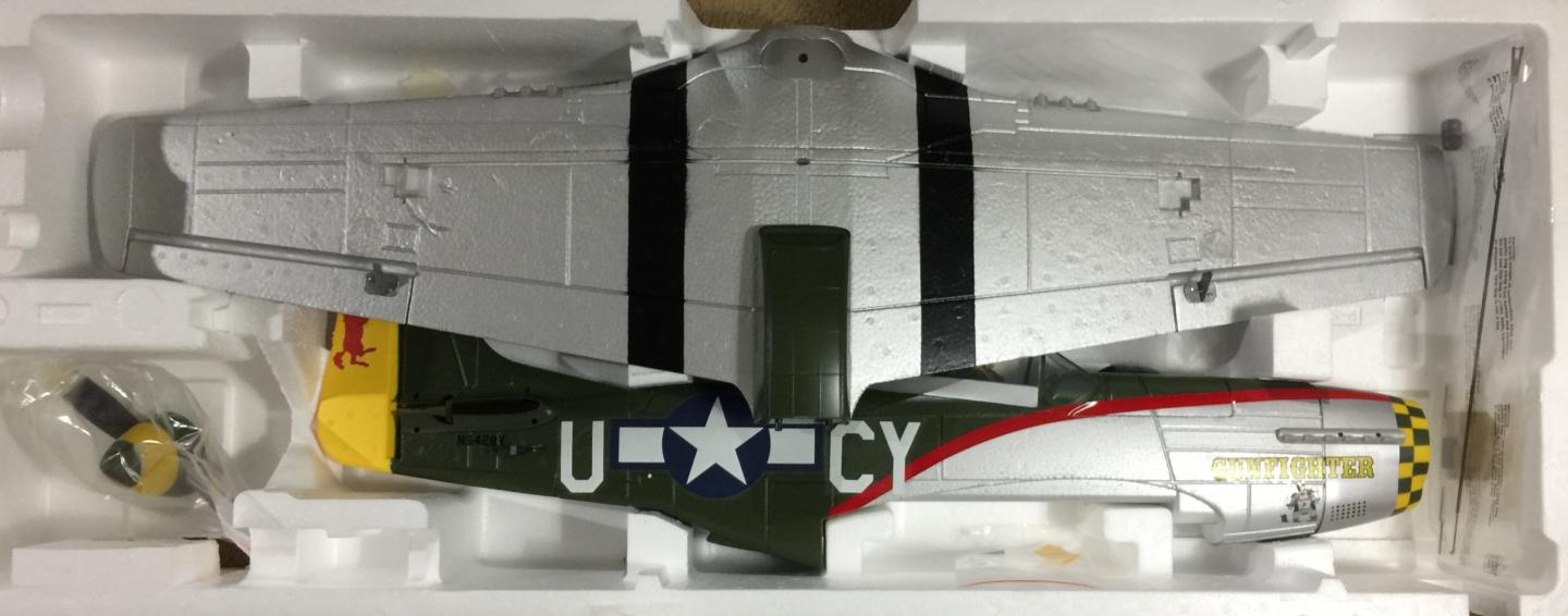

                        Still available on EBay...
                        New old stock airframes, includes the rudder pushrod for the mod.
                        Picked up a new one last week so I have a spare as I still regularly fly this bird...

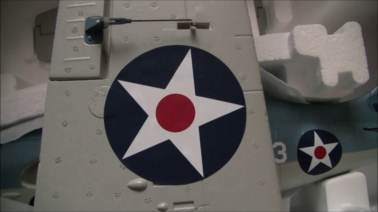

                            Here's a quick look at what's inside the box of the newly revamped F4F Wildcat 1.0m...
