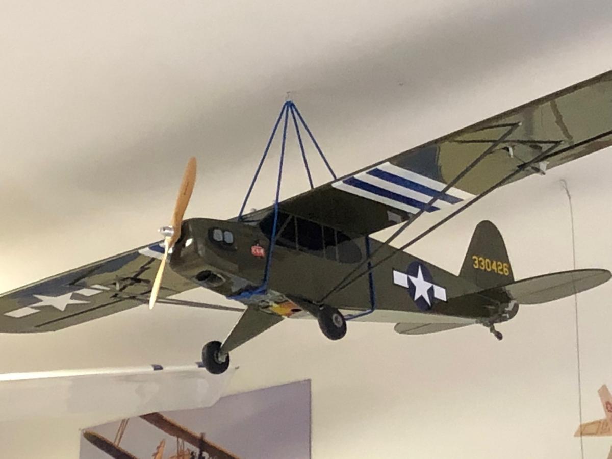

                    I thought it was cool I got the L-4 with the Admiral RX600SP to synchronize with the app and the transmitter so I could reverse servos and get a model set up to save. The bad news was neither the Carbon Cub or the PT-17 would bind when I was ready to fly Saturday morning. So when I re-bound them all to the TX, the controls were totally scrambled and none of the AS3X / SAFE modes worked.
                    So 45 minutes later, I got Cub (minus flaps) and biplane to move flight controls properly but had none of the flight modes or stabilization and of course the winds began to puff.
                    But, I flew 4 flights with each and in 'raw data' modes. It reinforced my change in thinking that maybe - just maybe, I did not need them anymore. I was mostly using them on landing only and it seemed like sometimes I did not get an aircraft response when I made a correction due to some air disturbances. Anyway, after an hour back at home I got busy with the app and did manage to restore all of the original programming the aircraft came with.
                    on Sunday I returned to the field and flew both without the SAFE modes and my takeoffs were straighter and the landings were fine, even though we had the dreaded crosswinds from behind at around 10 knots. They were'nt perfect but while I did get a couple wing drags, that happened as they were almost stopped and I had no more throw on the stick as they weathervaned into the wind.
                    Therefore, I yanked the Admiral out after I tried to bind it because TX would not recognize it - in fact I could not even get lights to flash anymore when trying to bind. i'll mess with it later, but I already had a AR400 I originally got for this Cub. In it went. No gyro - but I did like the gyro corrections with AS3X full time, so maybe an AR636 RX later.
                    And, I ordered a DX6.

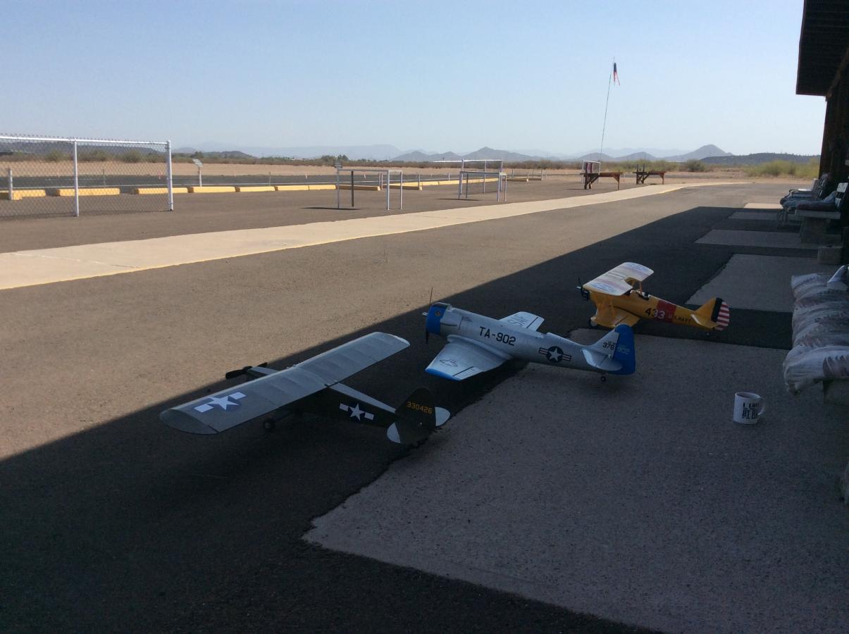

                      Had a flying club friend help me get her ready to go again. Had some of it set up in the new DX6, but was really glad to have him throw in a tish a expo, double check, basic set ups, and then take off and tweak the trims. Which, didn't need much as after 2 circles he said "...here, fly your airplane" I liked the expo and she maneuvers very well and almost looked like it had a gyro making corrections as light breezes began to come up this morning. Flew to the 6 minute mark and then landed very nicely on the runway.
                      Then evryone had to come over and check it out. Ken was nice enough to compliment the build to everyone - both flying and finish.
                      I did not use the Admiral RX600SP, but may give it another try now that the radio should bind predictably and allow me to select the combo I want. (Gyro ON / OFF)
                      I plan to take it up tomorrow and try out the new RunCam 2, but thought I would share these shots from this week at work.

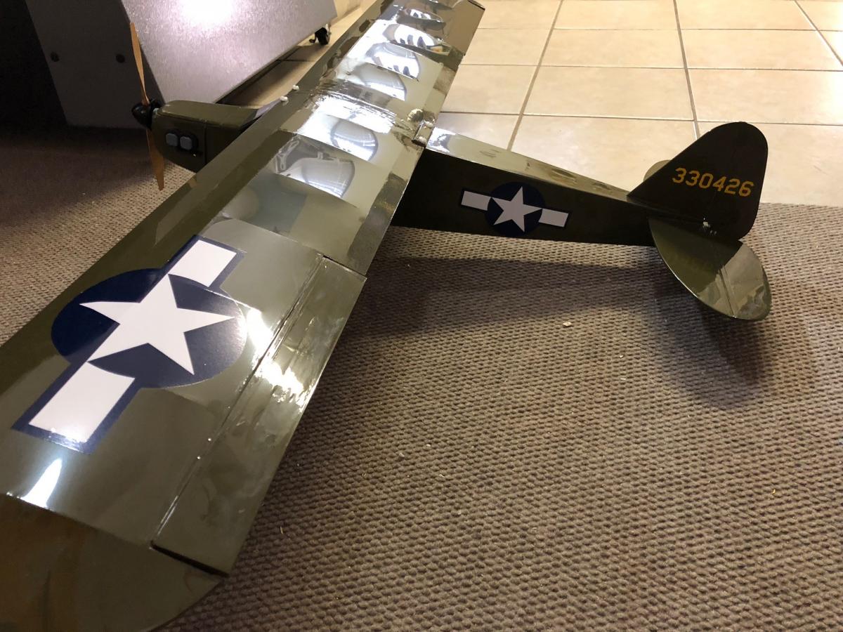

                          Been getting regular flights with her and she is proving to be a real trooper, so I ordered some Callie Graphics to dress her up. While I did post this pic in another thread, notice the little Cub waiting her turn. GF was fascinated as she had watched this one built from the box of sticks, and even though she had seen the video she was so excited to see her take to the sky.

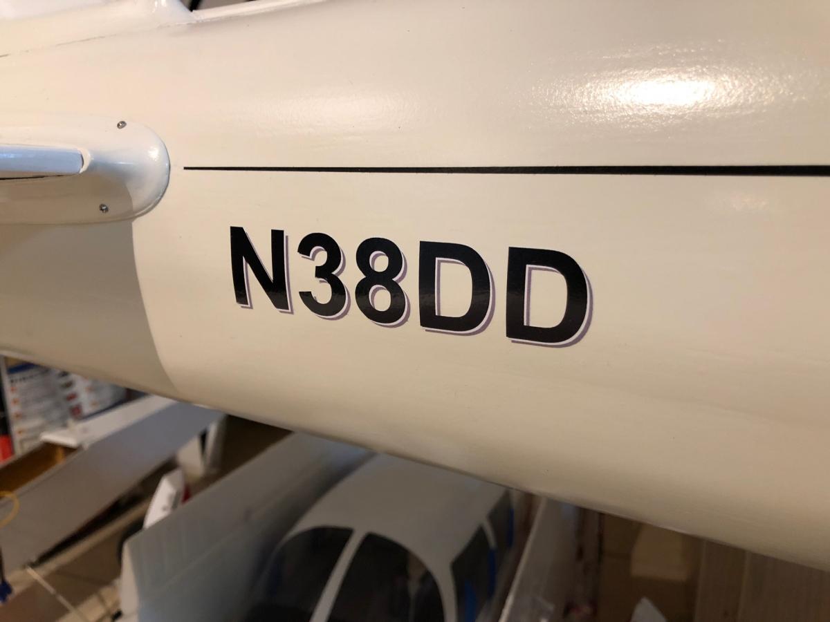

                                        #20
ID:	197549Click image for larger version
ID:	197548Click image for larger version
ID:	197547 Couldn’t wait to post these, but will get some shots tomorrow and maybe a video. Graphics arrived from Callie.
