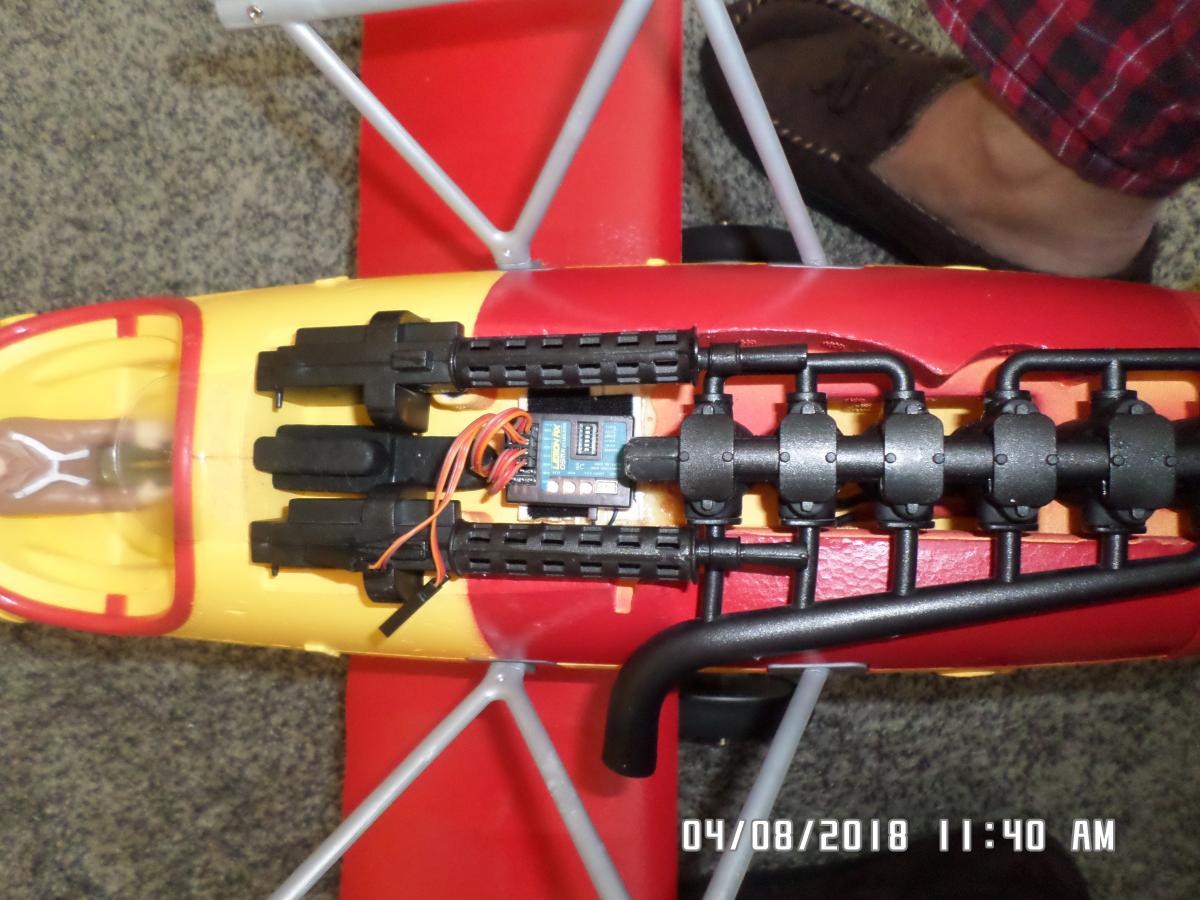

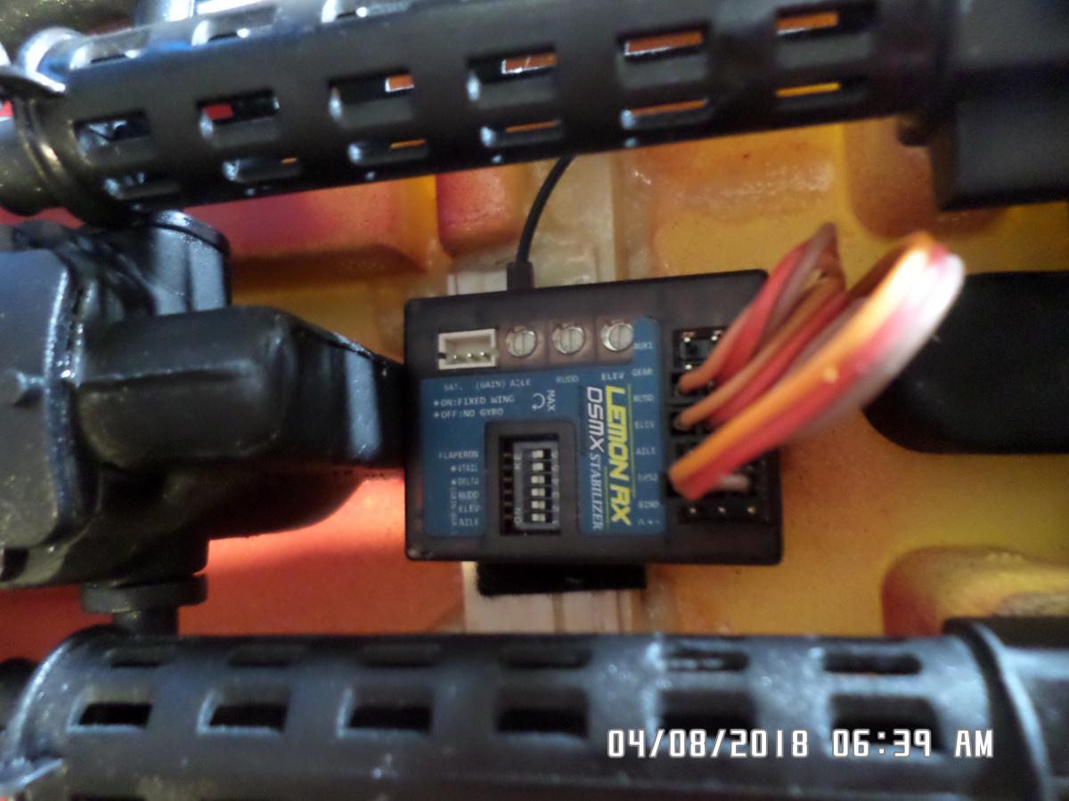

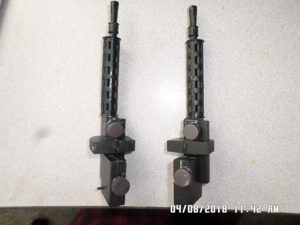

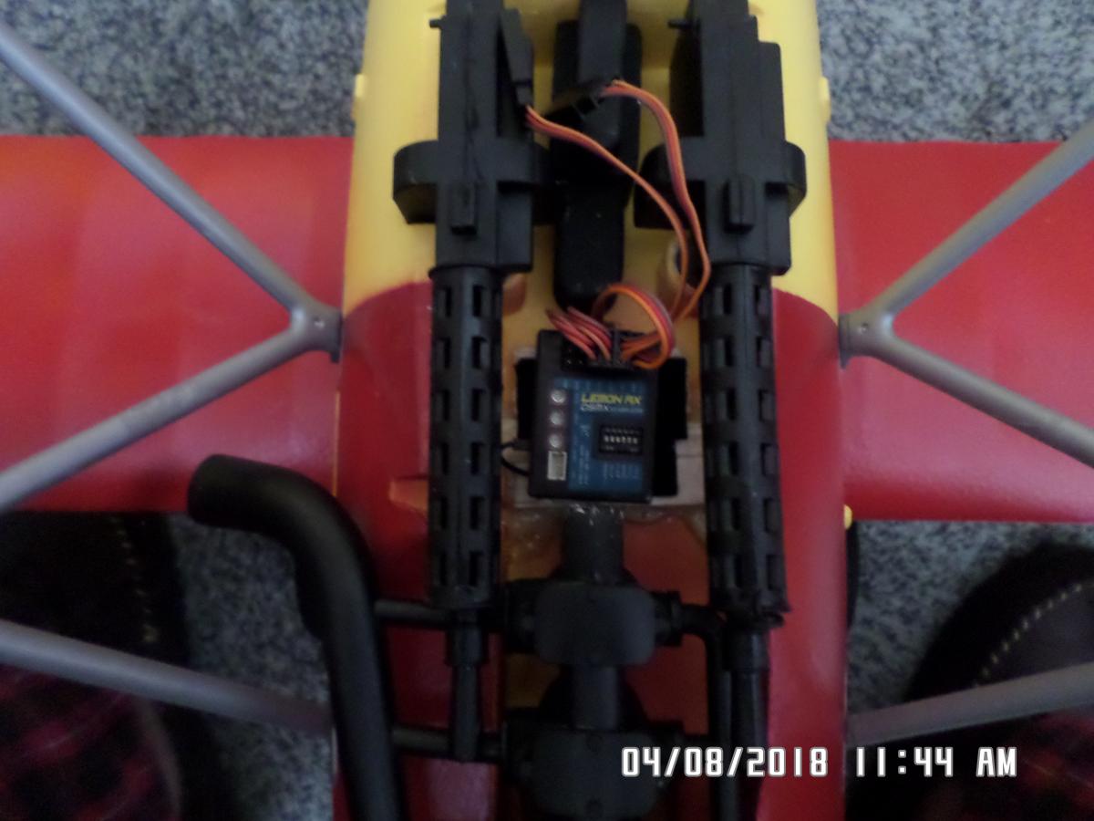

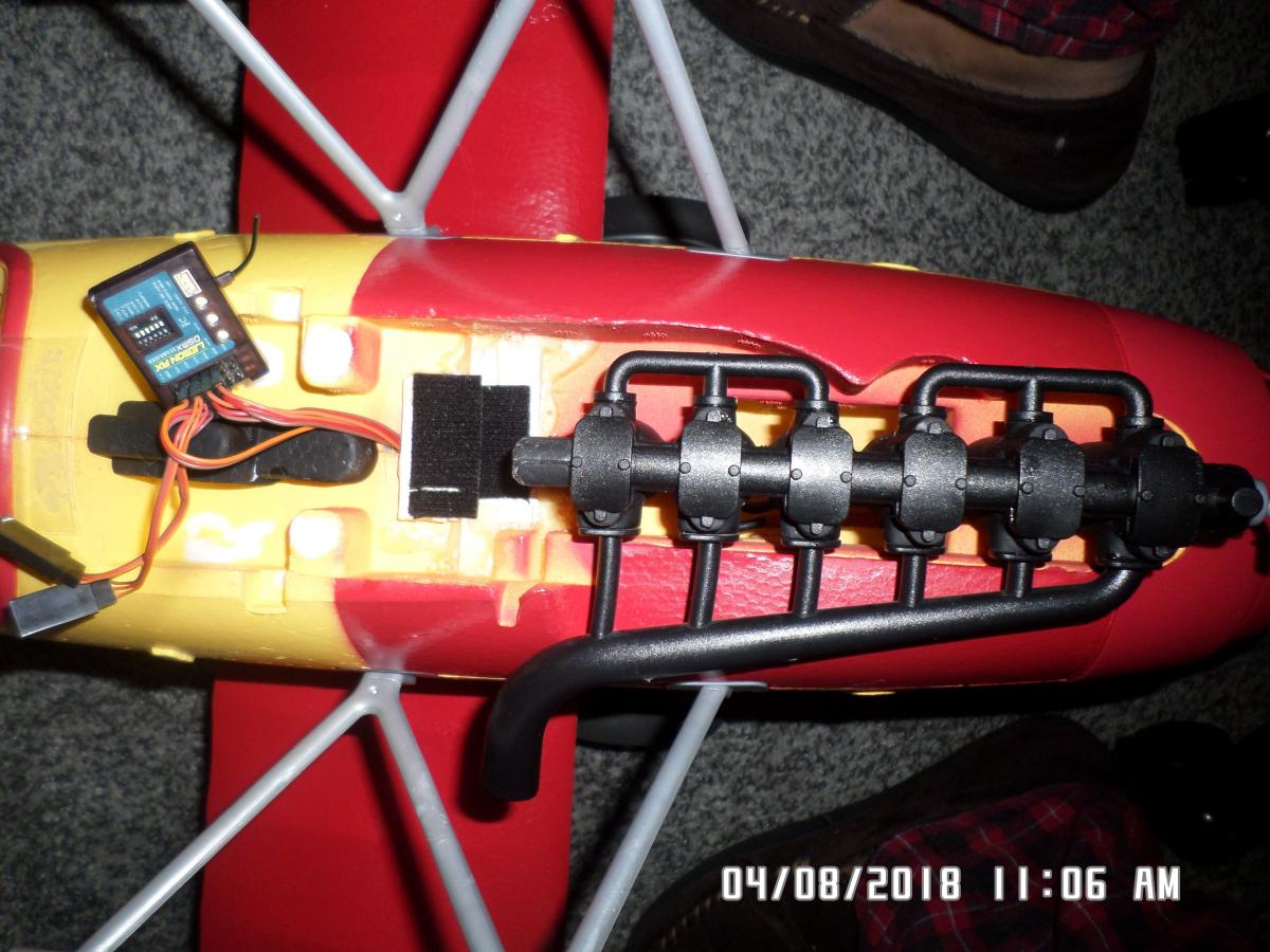

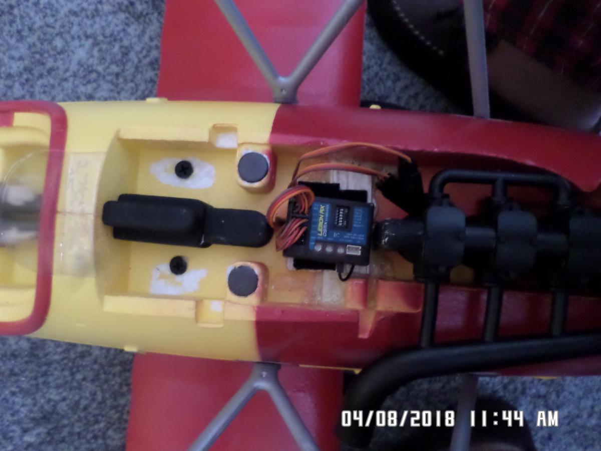

My second Dynam airplane arrived yesterday. I am really impressed with the fit and finish of this aircraft. I am not sure yet, where to install my RX though. I need it somewhere that will afford easy access for possible adjustment, as I use the Lemon rx with stabilization. That eliminates the lower wing, which would have to be removed for rx access. I am thinking of putting it on top, behind the engine. If I can do some engine surgery that would be good. I may explore mounting the engine with magnets rather than gluing it down. The paint is much improved over the T-28 Trojan. I noticed no overspray of any of the colors. The only thing is......they don't mark the hardware bags so you play a guessing game as to which screw to use for which application. Not the end of the world I know. I love the two props and also the color of the props. The horizontal stab was not attached but it was an easy fix with/three little dabs of glue. I will apply my decals and then paint it with my water base sealer. I will edit this post as I progress with the build. EDIT: 04/08/18 There really was no ideal place to install my Rx. I finally decided on the top of the fuselage between the guns. I put some velcro between the guns so that I could remove the Rx if needed for gyro adjustment. I attached magnets to the guns so they can be removed for easier access to the Rx. This is still not ideal but it is the best that I could come up with. I am afraid the magnets may not be strong enough. I will probably have to come up with some other solution for them. I don't want to lose my guns in the prop wash. This was a first. I went to balance the props, and both were perfectly balanced. My first intent was to leave the pilot out. He is not scale and I thought a bit silly. Then someone mentioned that he looked like Stan Laurel and I had to laugh. He does bare a striking resemblance to Mr. Laurel. I proudly glued him into his cockpit. I even added a small scarf for ol' Stanley.

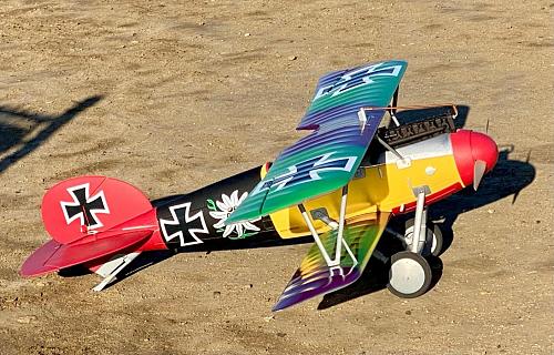

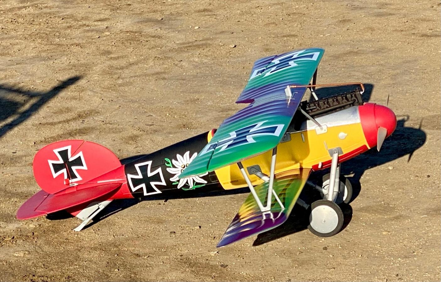

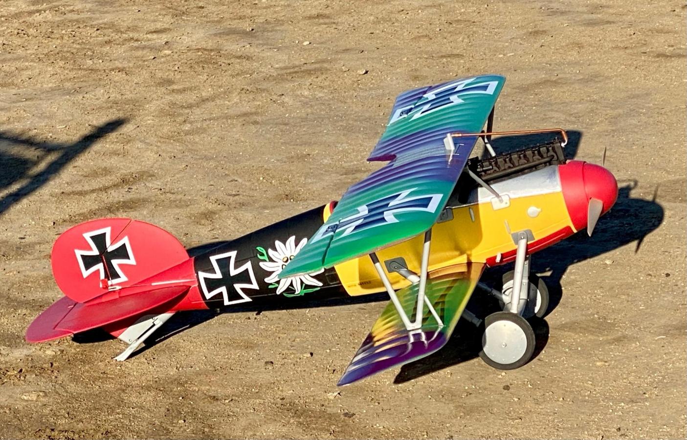

Good luck on your Albatros build and as others have stated, I agree it’s a great plane. Very strong and perfect for customizing. I abhorred the Dynam flat yellow, thankfully it is a great base for stain & minwax treatment to simulate wood grain. Ditto the orange/yellow prop. The grey plastic used for the struts is worth painting as well.
As for RX placement, there is a small shelf with just enough room behind the battery. My Spektrum RX is glued there. I use a bind plug extension to allow Gyro adjustments with Spectrum’s RX Phone App Cable since it’s pretty much inaccessible.4 Photos

Could you give me some info on the mat you are using (middle pic) for your runway. Cost? Where available? What is it made of?Originally posted by Area81Racing View PostBilly Boy,

It’s standard roofing tar paper available at any home center for about (Home Depot or Lowes here in the US) $16.00.
The 144’’ foot long roll lasts me over a year, as I cut off lengths as needed. Eliminates nose-overs on takeoff and it is very light & compact when rolled up. Fhhuber is correct, it is a bit narrow for landing larger planes, so I only use it on landing for UMX’s. It’s a great challenge!
