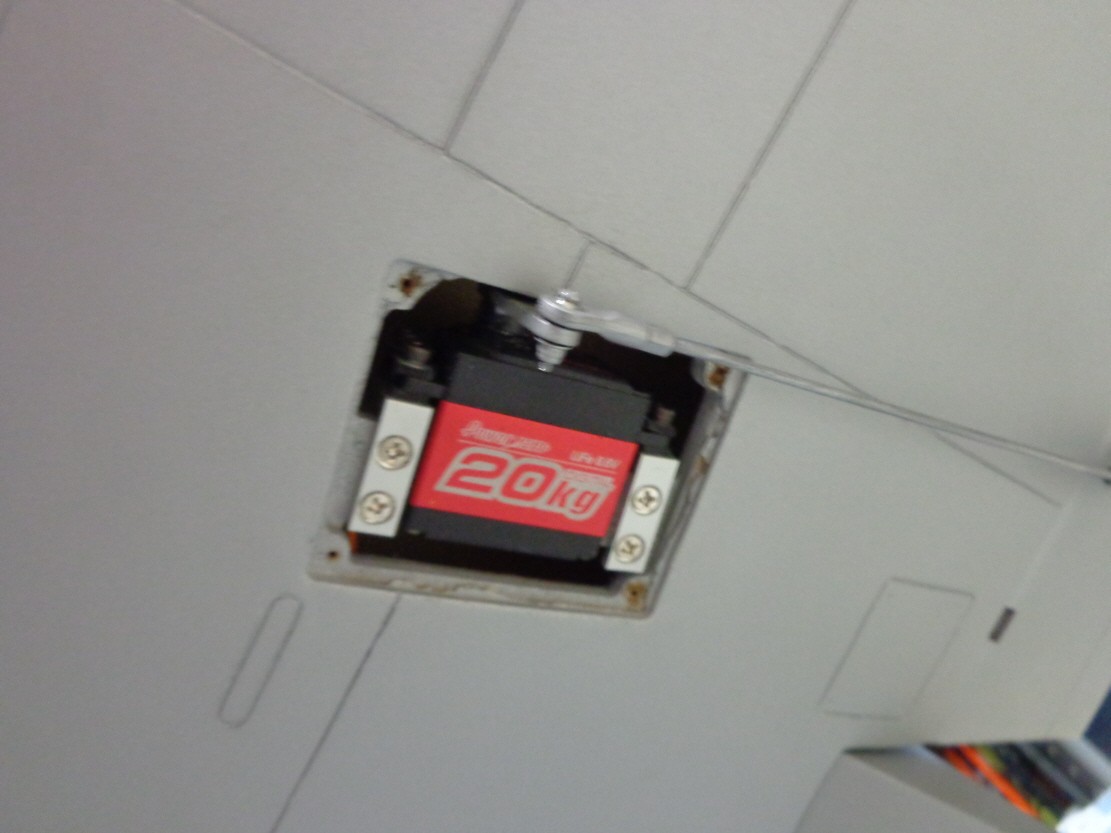

      I have installed the brackets to the servo's. They fit just fine. There is supposed to be tabs in the servo bay the brackets then attach to. There is no tabs on my model. So, i epoxied them to my doors. Now, I am thinking I will go ahead and put a bolt and cap nut in them. This is a picture of how they should be installed, with the tabs that should have been pre-installed at the factory.

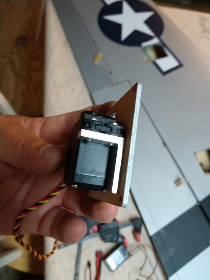

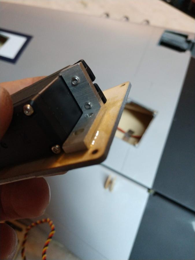

      This is how mine are installed due to the fact there was no tabs installed at the factory

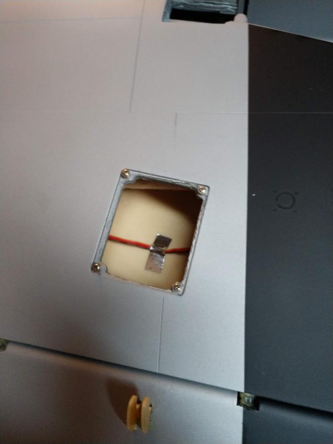

      Notice in the open servo bay there is no tabs. So, as you can see, i epoxied the brackets direct to the servo doors just like I would have wood blocks. Now, I am thinking about going back and drilling out a couple holes on each bracket/door and adding a small bolt and nylon nut.
