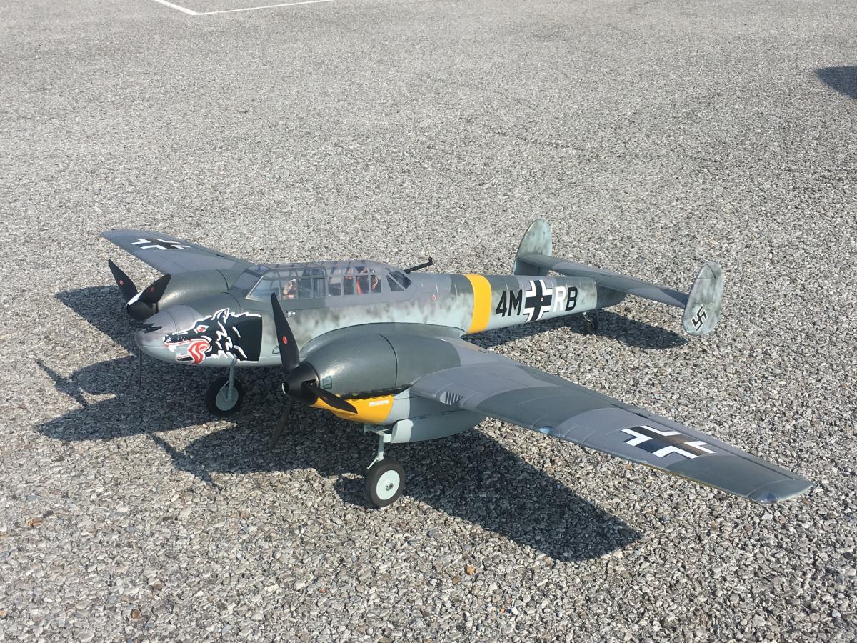

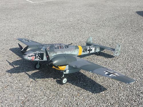

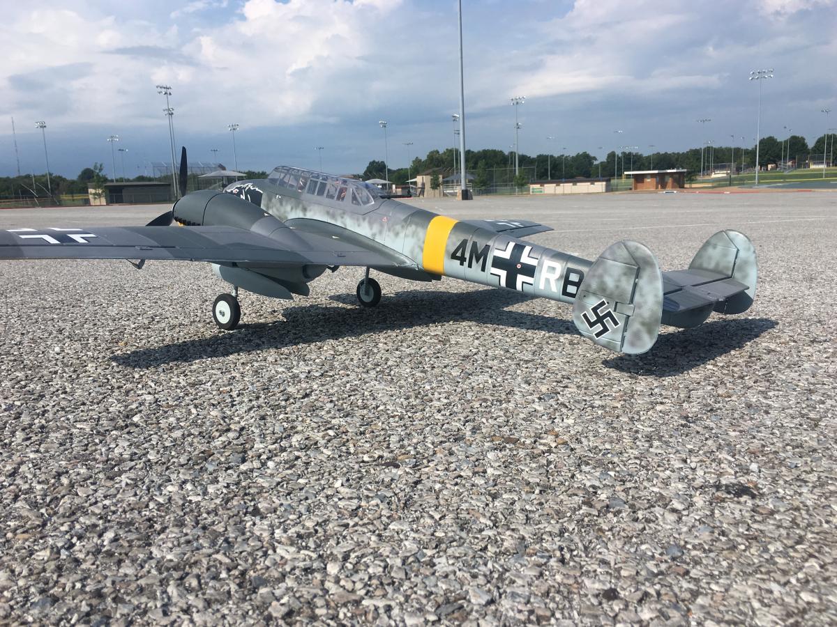

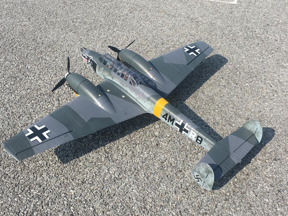

            I was looking for an official Dynam Bf110 thread but didn't see one. I got one of the bf110's that Motion had on the scratch & dent sale. I have always wanted a 110 but couldn't stand the stock paint on the Dynam plane, but since the scratch & dent plane was going to have to be repainted anyway I went for it. I've upgraded a bit more than just paint though. I upgraded the stock ESC's and relocated them under the wing radiators. I 3d printed some new radiators to house them. I also replaced a couple of servos which were buzzing, and modded the battery compartment to fit the Admiral 4cell 3000's. The maiden flight and second flight went well. She flew great with little trim although is suspect I'm a little nose heavy. After two back to back flights the ECS in the wing were cool to touch. The only issue I had was something twerked the landing gear on the second landing and the gear now gets stuck about 1/2 way up. I noticed the were kind of finicky to start with and would bind up with the gear door sometimes. I will dig into it and see what the issue is. Here are a few pictures of the repaint, Markings by Callie graphics ofcourse.

                  Hi Tim, nice job on the BF110-very impressed! Any chance you would be prepared to show your mods a bit closer (what you did to get a 4000mak lipo in, these 3D printed radiators and their location, and maybe even share the STL to print them up?). I have a Dynam BF110 I'm yet to assemble so it would be good to get a heads up on what you did and how you did it. Also I have the ME262 and I have been thinking about ESC's in the wing in that too hence my interest in STL files. Thanks in advance mate, love the paint scheme too????????

                      Thanks. I will get some detail pictures of my mods and post them here. I only got a 4c 3000ma Admiral in it and just had to shave a little off the plastic battery hatch piece and remove a little foam to allow the battery to extend into the cockpit space.

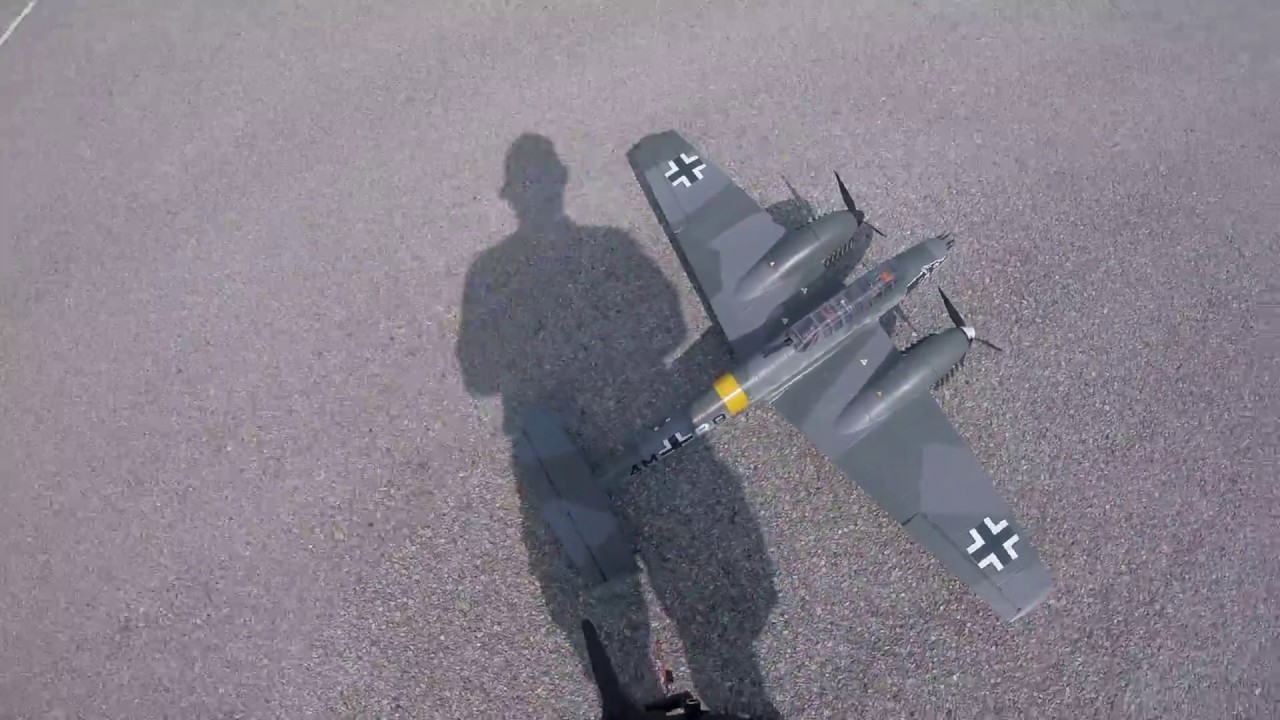

                                    • #19

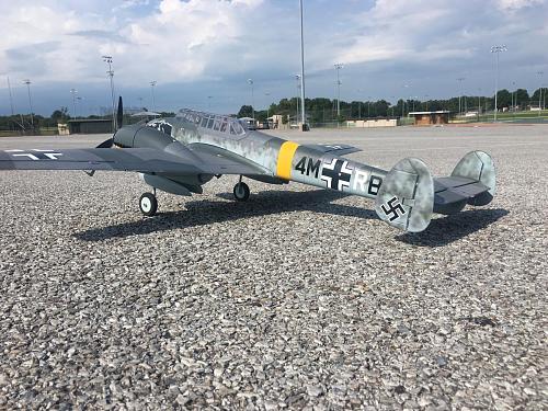

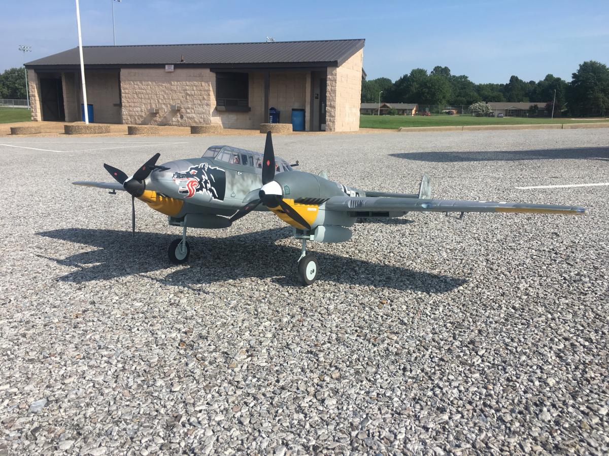

                                      I was very excited to finally have a bf110. Overall I like it. And that's my problem. I should love this aircraft. Had a lot of issues with it. Nose sticker was not even on the aircraft when I got it. Directions to build it are so far incorrect that I tossed them. Now it flies fantastic. This aircraft has a lot of lift. Flies scale like if you throttle it back a bit. I had to add 4oz. Of lead to the nose to balance it. Now I had to land. So the gear that were on my aircraft had been wrong and installed wrong. The notch on the gear leg to lock it down was in the wrong place. So when I landed the wheels turned 90 deg and it slammed its face into the ground and flipped over. Took it apart and found the gear issue. New gear ordered and they are corrtly cut. New props as well.
                                      Here is a pic. It looks very nice. It flies great.
