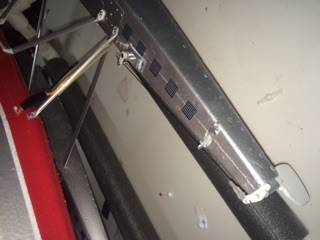

      Hi Lauren
      I had the same thing with mine. Twisted a screw off with not enough sticking out to get a pliers on it.
      I figured I had the wrong screws sent with my plane, but it appears everyone has this problem. I agree with SOB, use different screws. I didn't have any so I ended up drilling the pilot holes a little bigger so I could use the screws sent with the plane. Then using the same bit, I drilled a new hole just below the one that twisted off and luckily found a screw that would work. Now all is good.
      Just make sure you have the gear mounted with the other screws before you drill the new hole so they line up. Hope this helps with your fix

        Thanks Capt! That's a good idea to drill a new hole with the other two screws in. I did use the screws sent with the plane but what I did was to coat the threads with petroleum jelly which seemed to help. That one side is kind of screwed up looking now so once I get the gear situated I'll probably get another set  so it looks good. Right now I have a piece of silver gray tape over the bottom hole which ended up getting gouged out trying to get the screw in. It always seems that the first pieces get mangled putting these things together. LOL! Here's the mangled mess...

          I wouldn't feel bad about that "mangled mess", my gear looks a lot worse!! Lol
          I've got the floats on mine and now that I've experienced the absolute joy of flying off water, I seriously doubt the wheels will ever go back on!!

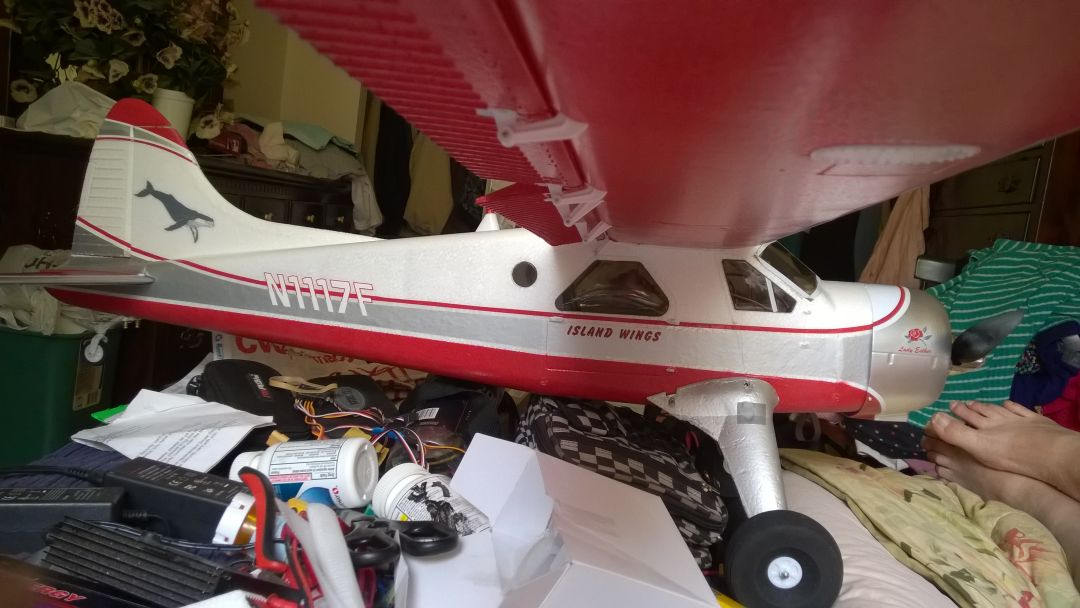

                                        Great plane!  Maiden flight of my Island Wings on tundra tires required a bit more trim than I expected.  Seems I may have a very slightly warped aileron.  No worries...she trimmed out nicely. Completed the flap servo arm mod and set two positions on my Dx7s. Slows down beautifully.
                                        Installed the floats and tested the water handling in my pool....didn't like it so I installed a servo in the float after opening the case and soaking it with Corrision X. Much better...in fact the single, direct link rudder allowed figure 8s with ease in a 20x40 pool. Open water maiden this week I hope.
