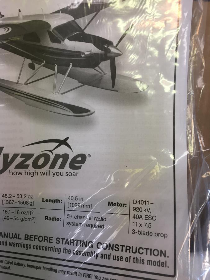

                            Originally posted by JamesonC
                            Taking a break from the garage rebuild preparations cause USPS just delivered the first of my fleet rebuild with what is now going to a permanent float plane.
                            Back on post #20 I indicated that I would get to the bottom of this powerplant question when mine arrived.
                            So the Horizon Hobby YouTube Thursday Thunder 10/11 "marketing vid" is halfway correct.
                            The motor that is in this Turbo Beaver is not what is claimed by Derek Sachtleben - "Horizon Marketing" to be the same as the from the Eflite Cirrus.
                            Proof in the pics
                            Here's the manual reference again and hard copy still in plastic.
                            Prop is 11x7.5x3....same :Cool:Motor is 920kV and not the Cirrus 1300kV
                            Click image for larger version  Name:	IMG_1073[1].JPG Views:	1 Size:	75.8 KB ID:	157783

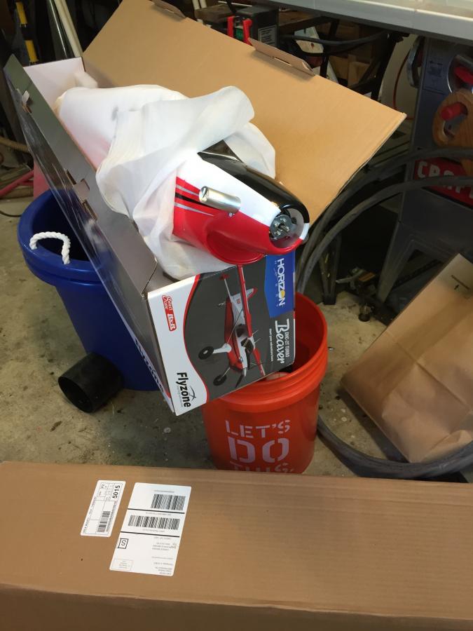

                            Still in its foam wrap getting ready to remove cowl for the motor unveil.
                            Click image for larger version  Name:	IMG_1071[1].JPG Views:	1 Size:	66.5 KB ID:	157784

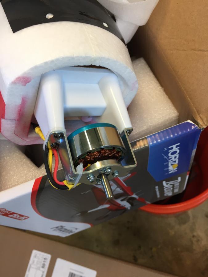

                            And here it is..................
                            A non descript motor and certainly not the Cirrus Eflite Motor 10
                            Click image for larger version  Name:	IMG_1072[1].JPG Views:	1 Size:	56.6 KB ID:	157785
                            Eflite Motor 10
                            OKAY.........guess that solved this conundrum on what powerplant really is in this bird.

                                      Charlie, that motor looks like the same one that has been in the Flyzone Beaver from the beginning. The Orange one, and then the Island Wings model too... I have several of them. It has plenty of power and flies fine with floats too!
                                      I looked up the old one and it says it is 850KV. So this one has a little extra getty up I guess... They look identical in the pics...

                                          That looks like the same motor from the old Flyzone Corsair.
