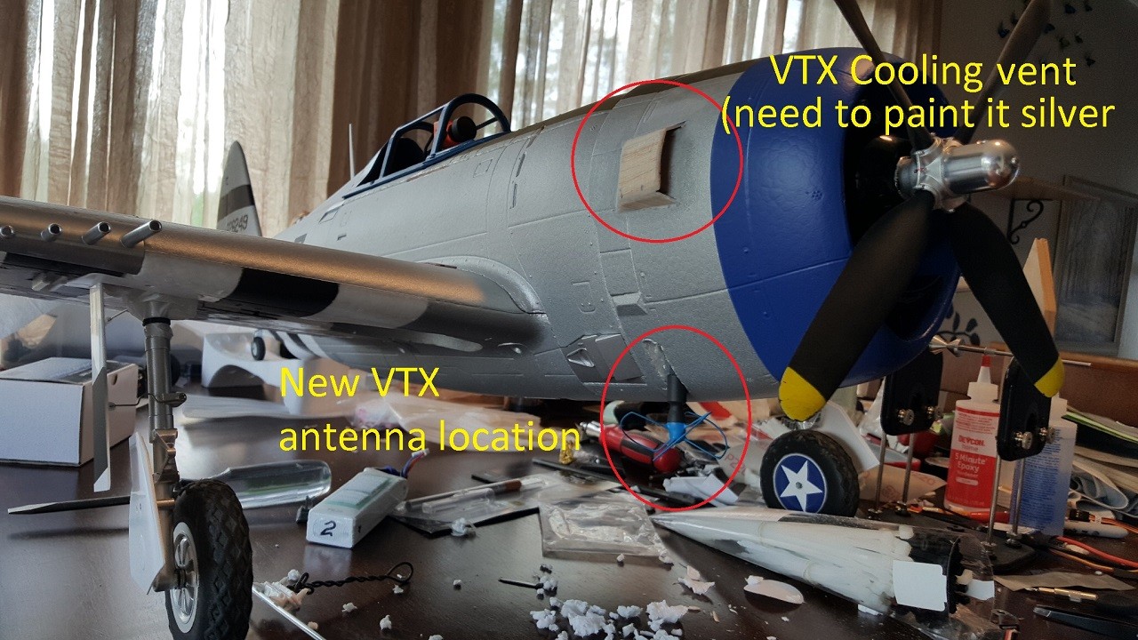

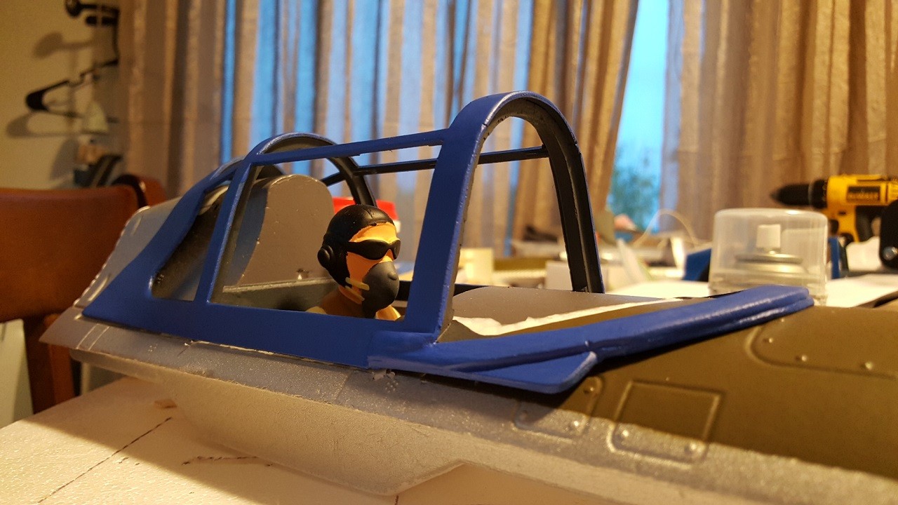

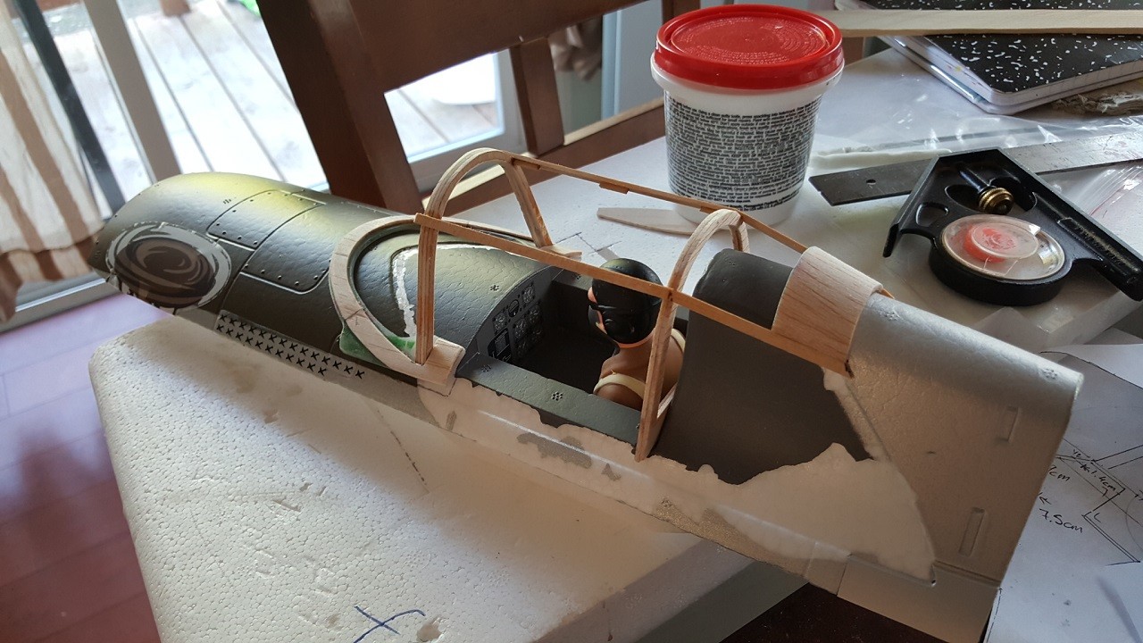

    Hi Guys,
    Just want to share my setup for Razorback from E-Flite.

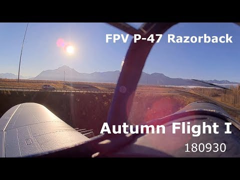

    I love this plane in FPV and LOS

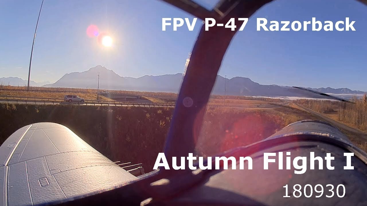

    YouTube link (was out flying, looking for fireworks this summer on the 4th of July)

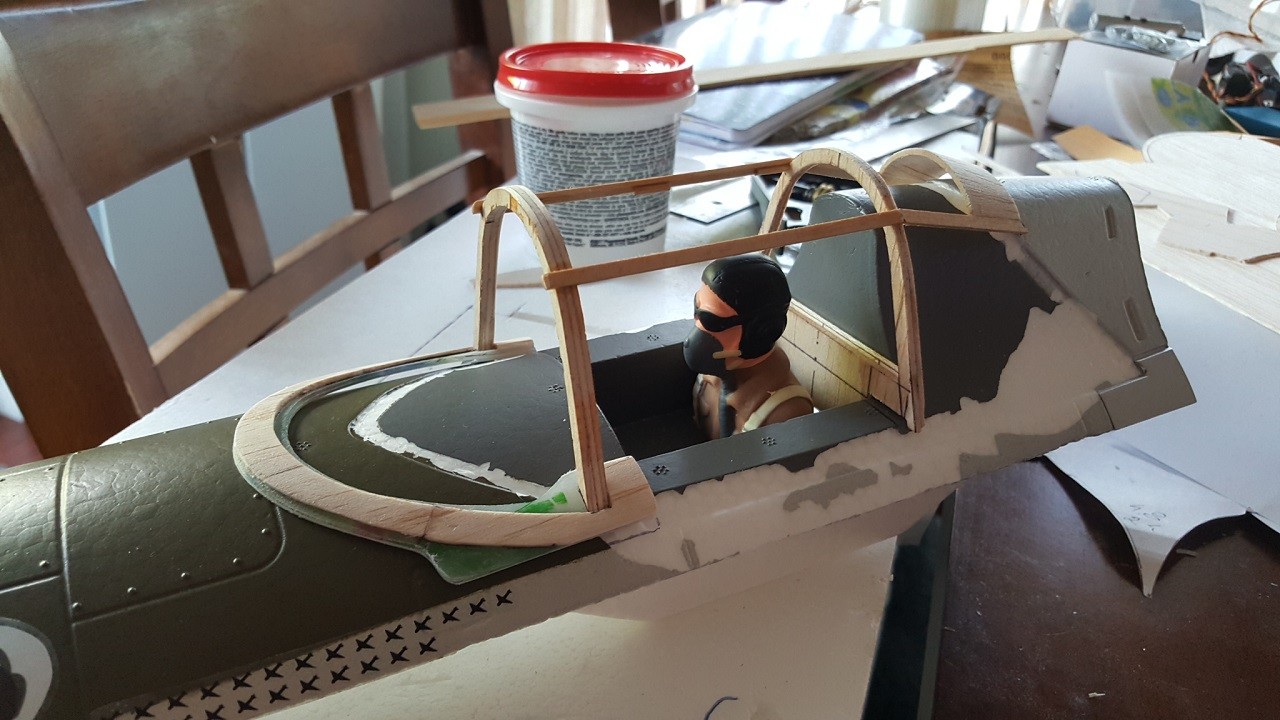

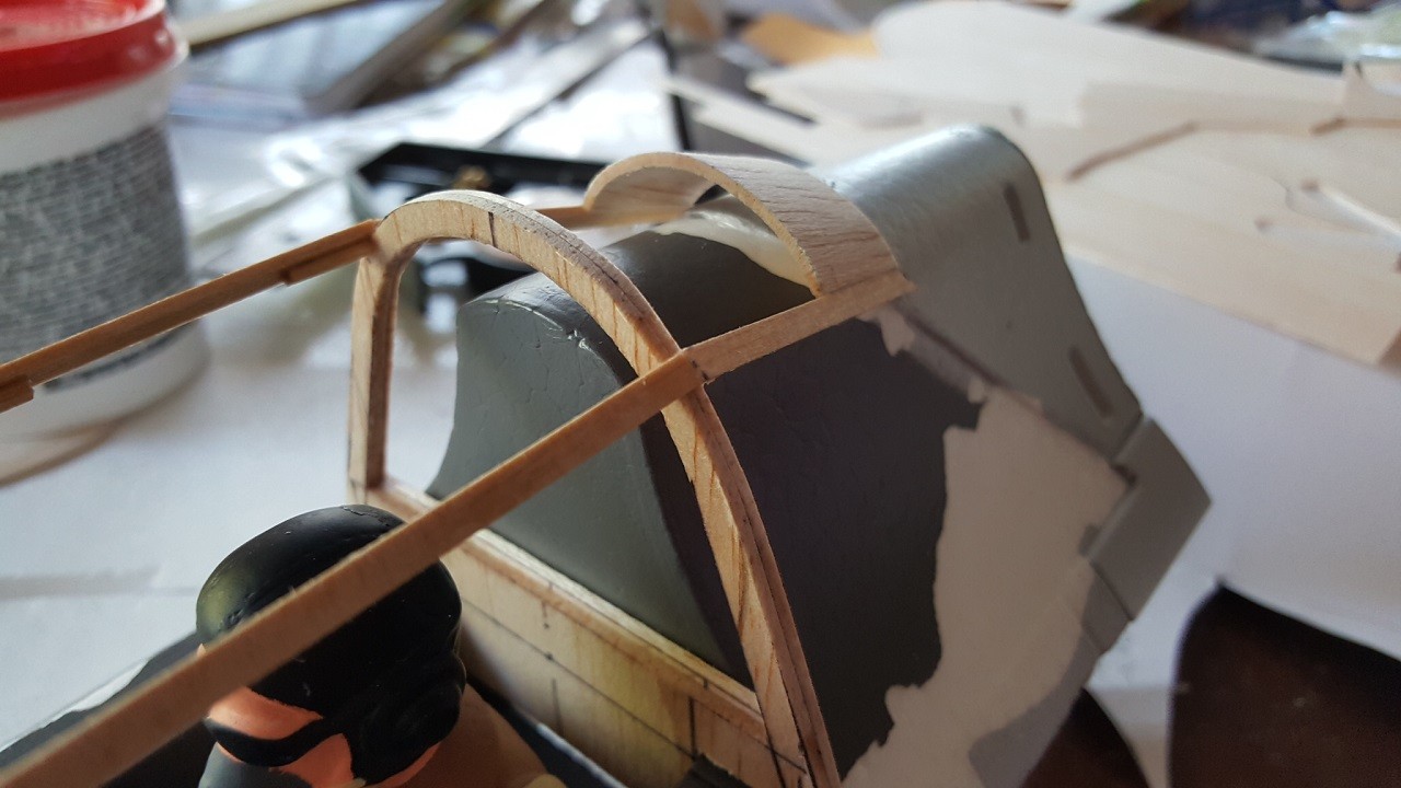

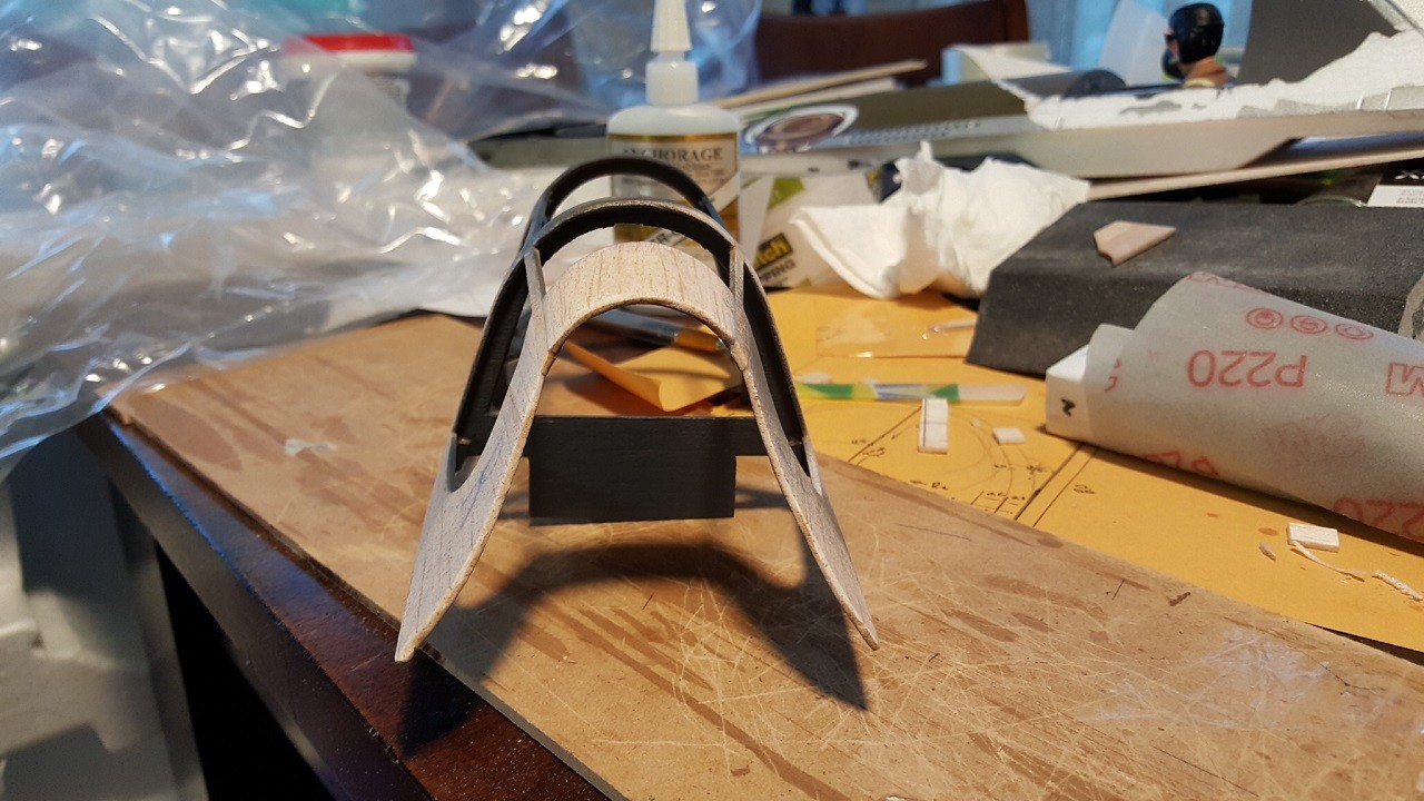

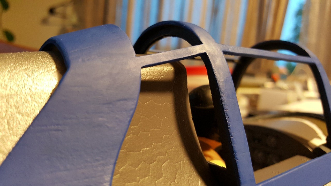

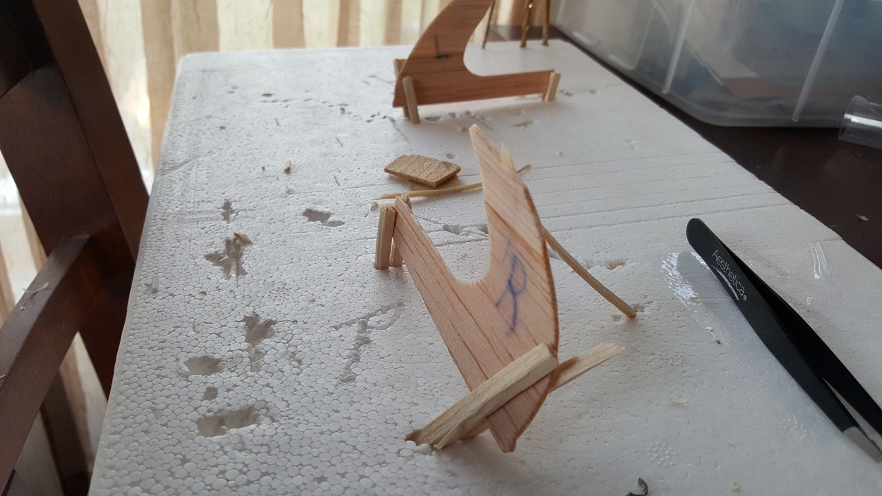

    Here is my setup:
    Airframe
    - MDL: P-47 Razorback 1.2m/48" (E-Flite)
    - ESC: ZTW Gecko 65A ESC with 8A SBEC
    - BAT: 4S Admiral Pro 5000mAh
    - FC: Eagletree Vector, GPS, PSU
    - HDT: Fat Shark 9g 180* Pan Head Tracking Servo

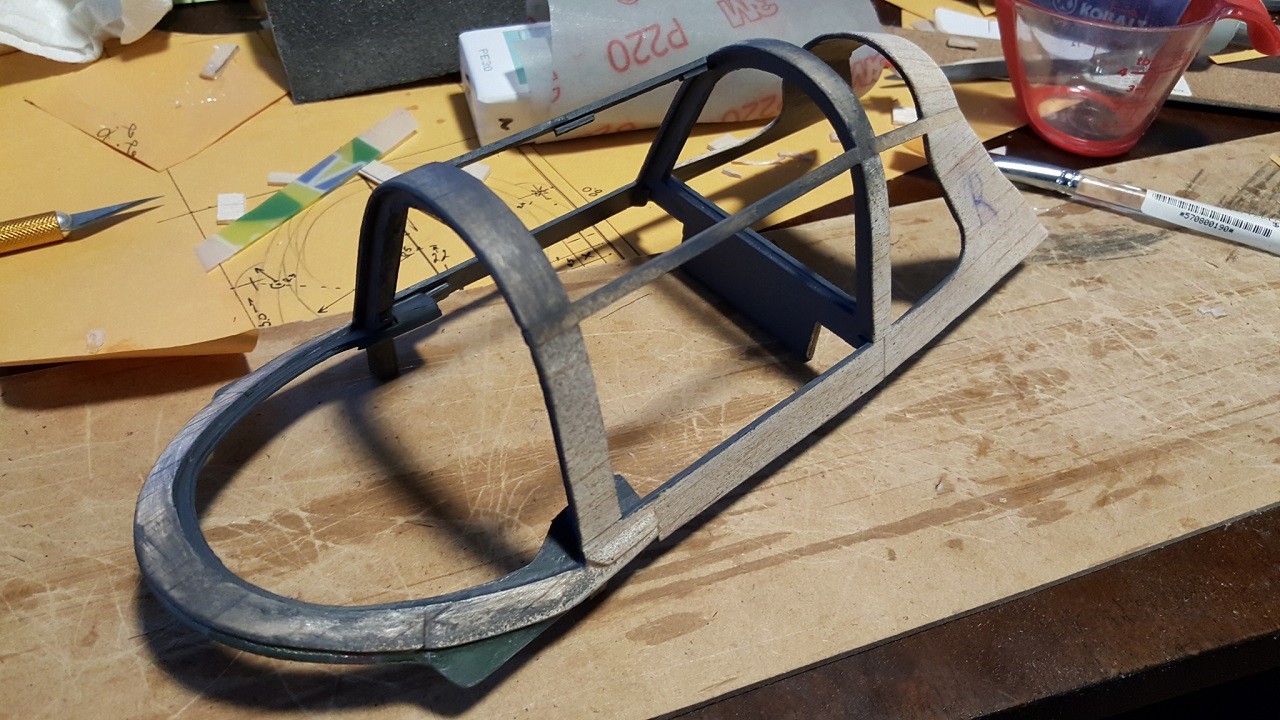

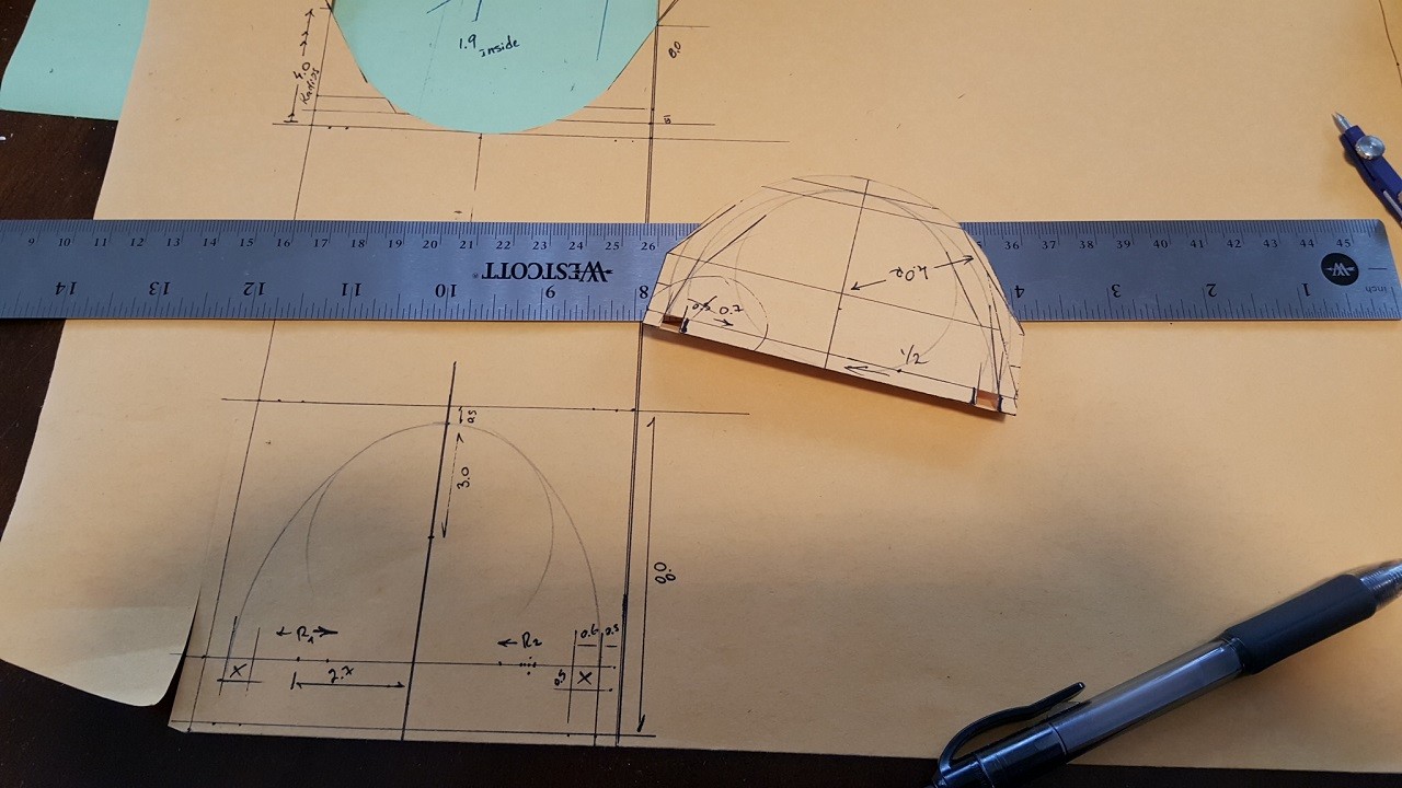

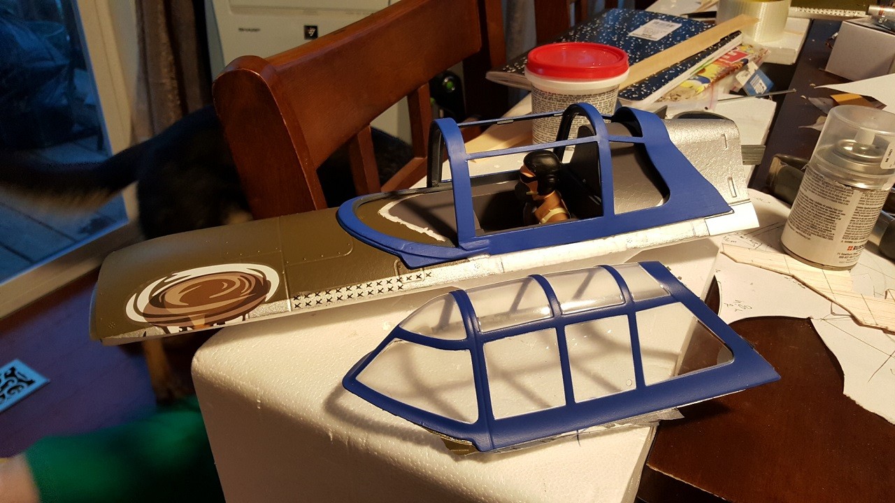

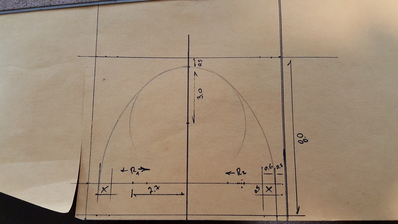

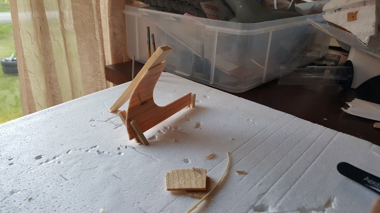

    - Canopy: Custom build (Balsa & 1/8 Hobby Plywood, Plexiglass: Bayer)
    RC
    - TX: FrSky X9D+ with 900MHz Long Range Module
    - RX: FrSky 900MHz R9
    FPV 3.3GHz
    - CAM: RunCam Split 2
    - VTX: Finch 3.3-3.4GHz Racing Transmitter 50/200mW Coax V2
    - ANT: 3.3/3.4GHz BlueBeam ULTRA Antenna Set (RHCP) - VAS IBCRAZY
    Ground station
    - Eagletree Eagle Eyes diversity box
    - VRX: Two R3300V2 3.3 GHz 16 Channels Pocket-Size Receivers
    - ANT1: 3.3/3.4GHz BlueBeam ULTRA Antenna Set (RHCP) - VAS IBCRAZY
    - ANT2: TrueRC 3.3/3.4GHz X2-Air 13dBic Directional Antenna (RHCP)
    - RPTR: FatShark 5.8ghz Repeater (Ant: Standard clover)
    - GGLS: FatShark Dominator V3 FPV Goggles
    - Goggles VRX: 5.8 GHz Furious True-D Diversity Receiver V1
    - Goggles ANT: Standard clover
    - Goggles HDT: FatShark Trinity Head Tracking module
